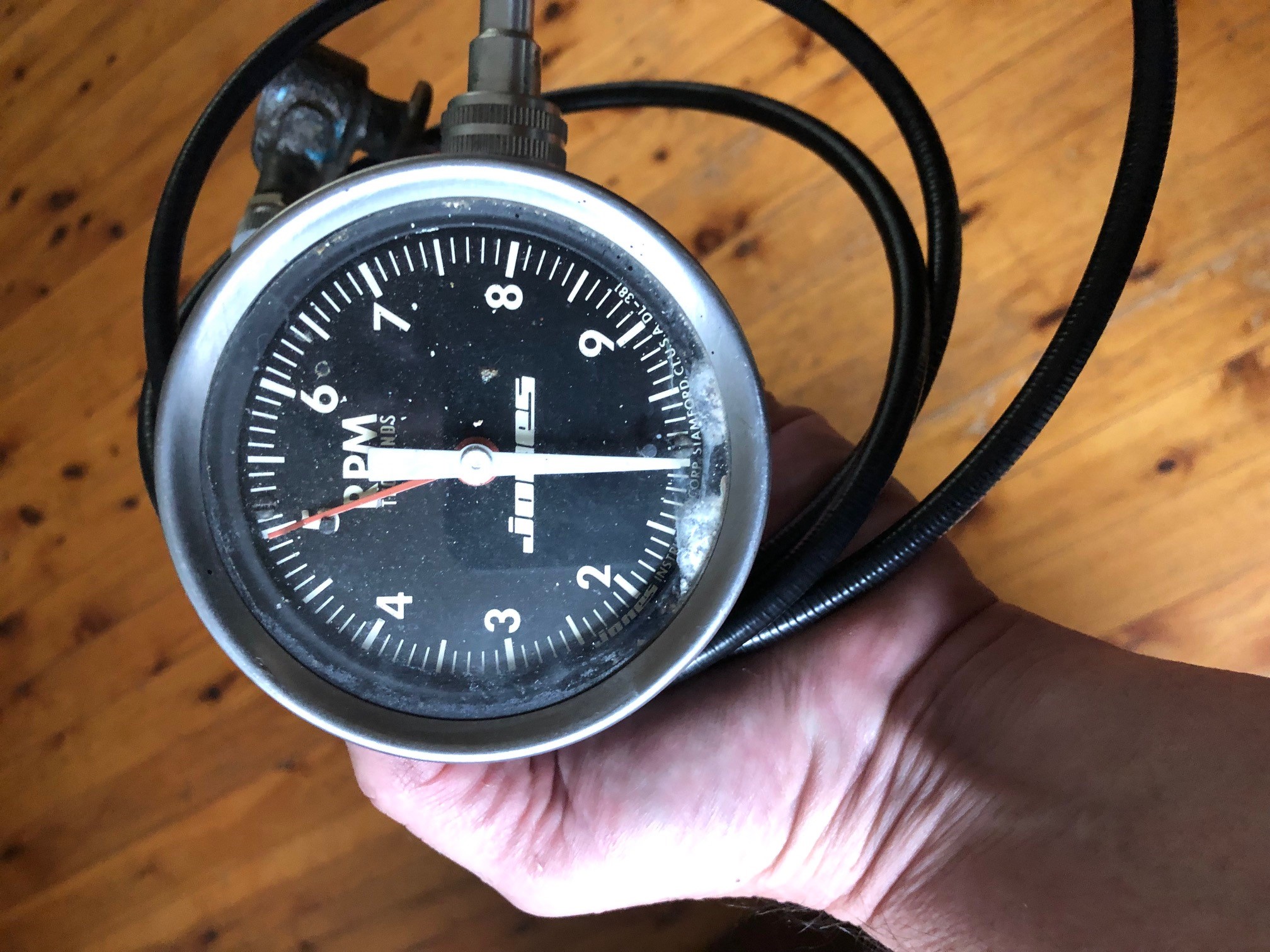

Posts: 5737
Re: Console
I have similar plans... :mrgreen:
Jones tacho.jpg (644.6 KiB) Viewed 11594 times
Posts: 14249
Re: Console
Thats cool Harv - did you have a chat with Doc about the gear you bought ? It was feeding a Hilborn hat which is why it had 4 nozzles
Posts: 5737
Re: Console
Crap... I have the attention span of a goldfish. Forgot to call him. Will try and give him a yell this week.
