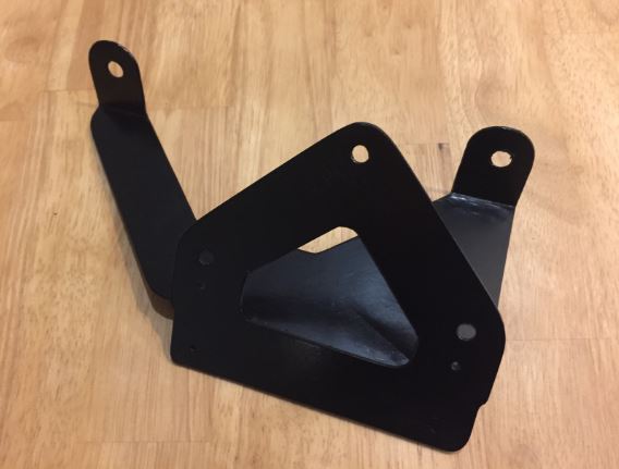

Bracket welded together painted...
Bracket and Heater.JPG (41.82 KiB) Viewed 7856 times
Painted Heater Bracket 2.JPG (33.38 KiB) Viewed 7856 times

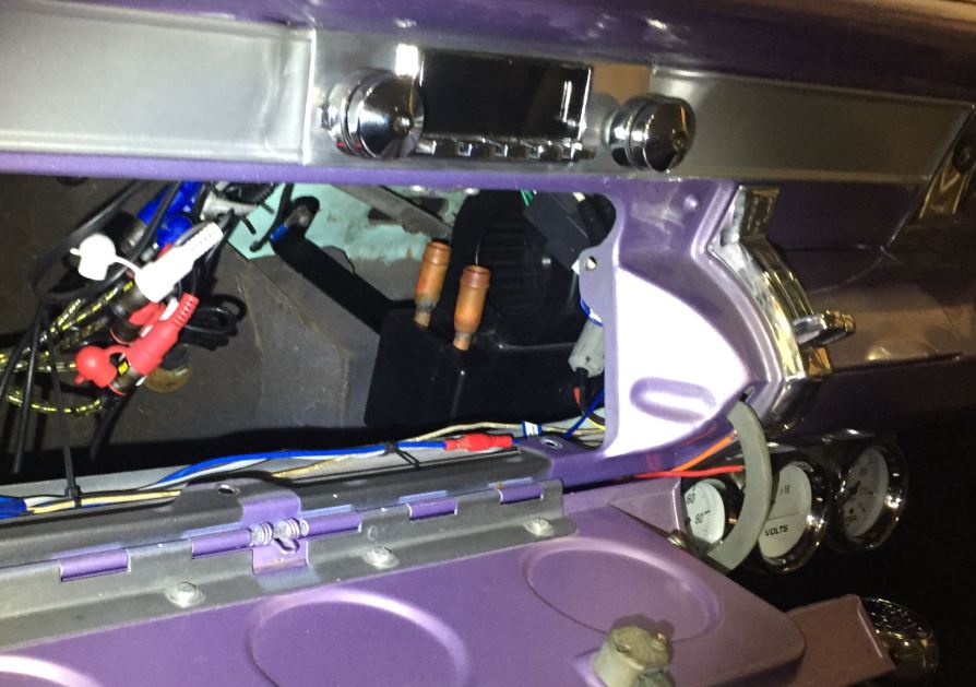

heater unit in place...
heater installed 2.JPG (85.99 KiB) Viewed 7855 times
Heater installed 1.JPG (51.79 KiB) Viewed 7855 times

so, after the advice on here about the hoses and grommet setup and trying to slip straight hoses onto it and checking the bends required to get to the firewall at a reasonable angle, I'm considering making use of the engine bay heater hoses in the cabin with the 90 deg bends at the heater. The edge of he heater is about 10mm from the side of the glovebox so a bit of trimming of the glove box will be happening.
