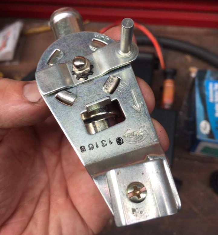

If you want to eventually connect it up to the dash controls, then it is easier to put the ball valve inside the car (as the Bowden cable does not need to go through the firewall). If you are like me and turn the heater water on in winter, off in summer, and just play with the fan, then it won't hurt to put it into the engine bay.

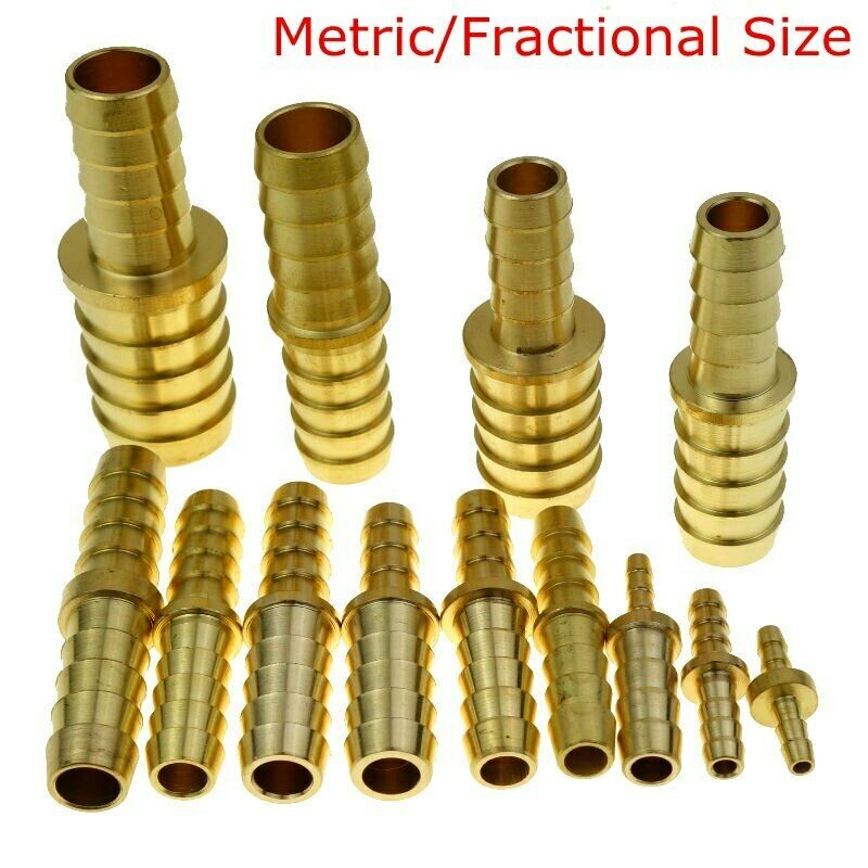

got some of those brass barbs Harv suggested and works out that the firewall grommet is the perfect location to join the heater hoses from inside hoses to engine bay hoses and the grommet looks like its designed to snugly envelop the brass double ended connector. hurdle 1. kicked it down.

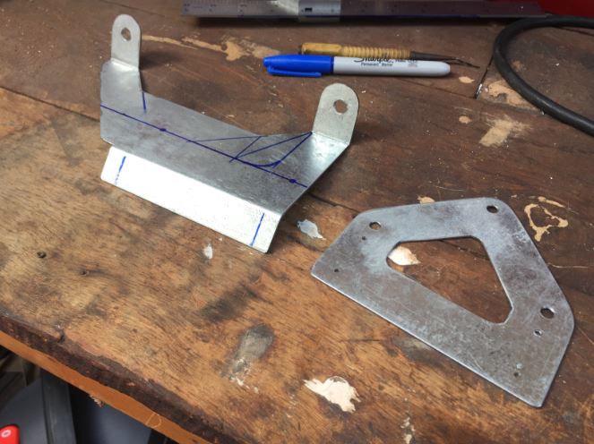

also, got all contorted under the dash for a while with a measuring tape in hand and the heater box, works out i think i can accomodate it in the middle, under the dash and behind the gauge cluster. i think i'm going to blow it downwards rather than upwards so that i can direct it onto the passangers with a 90 elbow. and have the heater core below the fan unit so if it does ever leak its not going to leak onto the fan motor. im going to hang it off the 2 bolts that secure the wiper motor to the firewall with my 1.2mm flat plate bracket... i might recut the bracket so it can be folded out of one piece rather than be of 2 pieces. might need to add another point of contact to the firewall to keep it in place securely but essentially it will sit directly behind the motor on the inside face of the firewall.... blah blah blah... here's pics.
