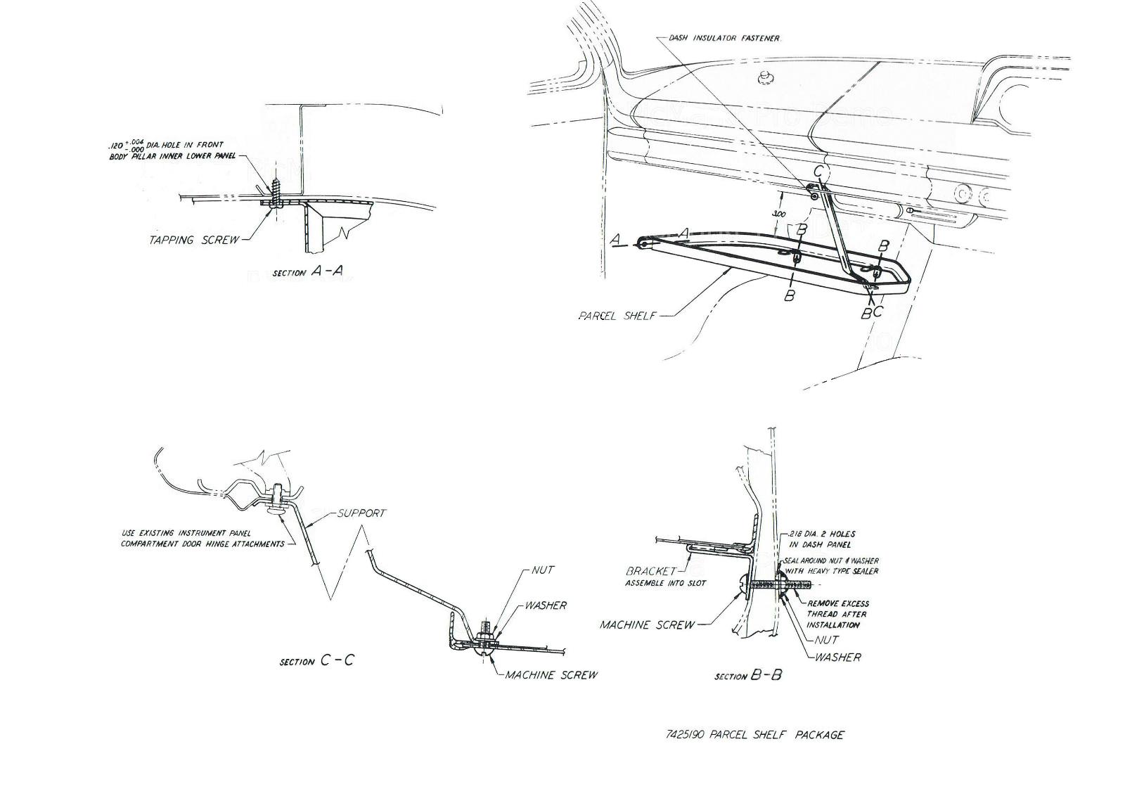

These are the fitting destructions for EJ/EH... I don't have FB/EK, but they should be similar.
7425190 Parcel Shelf EJ and EH Holden 1 of 2.jpg (163.03 KiB) Viewed 4764 times
7425190 Parcel Shelf EJ and EH Holden 2 of 2.jpg (115 KiB) Viewed 4764 times
Posts: 2815
Re: Parcel Shelf Under Glovebox
Thanks for destructions Harv appreciated.

Did a quick look at mine in position - doesnt seam to follow firewall very well - maybe mine is not fb ek? ImageImage
Yes rob they screw to the firewall and through the kick panel trim on the side. Use a tapper on the side. You can use gutter bolts on the firewall or use self tappers and grind off the end in engine bay for a clean look.
