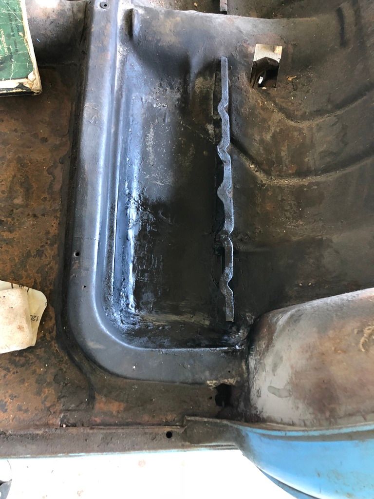

i just picked up four doors last night practically free of rust so that has saved me a lot of time and effort given how bad a state my doors were in. Goal is to get the floors done this weekend I think.
Some updates. First bit of rust repair. A bit rough but no ones gunna see it I suppose. There was a fair bit of bog under there from a previous repair that I had to grind out and weld over. Next one should be a bit neater, It's all a learning curve.
That cowl vent plenum drain, oh dear. The front floor looks reasonably good and original though. Interesting that the hydramatic body type isn’t noted on the body tag. I thought they threw an A in the code somewhere, depending on the factory. One for Sunny Tim?
Errol62 wrote: Wed Sep 26, 2018 4:35 pm
The PO code in the insert line on the tag denotes Auto body Clay ...
