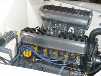

Oh yeah, plus they look coolDevilrod wrote:That's the spirit, one in all in!choppedfan wrote:
Mine aren't on a proggresive linkage and they work well, venturi restrictors/sleeves are essential
- phpcuA8hvAM[1].jpg (44.37 KiB) Viewed 909 times
