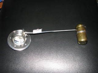

i was looking on the net and found this fuel sender
out of a 54 chev sedan i looked just like a early holden
one so i got it from the states $39 the bolt pattern fits perfect
it fits in the tank and moves the gauge when hooked up
(even seem to read correct)do all you guys know of this
(and not let me in on it)as in australia ive found it near impossible to find one

great score
if it fits n does the job its got to be good
were there more available or just the one?

ek61 dime a dozen on usa ebay

How accurate is it Mez? You might have just solved one of those little dramas that plagues virtually every rebuild !

I got one from the states that bolted straight up but the float arm had to be a lot shorter than shown in your picture to fit in the tank.
Can you post a close up of the bolted up end so I can see if it is vertical or horizontal design. The one I got was vertical and that was the problem.

hey dave im in melbourne at the moment but i will when i get home the sender from what i know is a top tank mounted sender like a fb/ek

sounds good if its top mounted it should be right as long as its 0-30 ohms.
Would be easy to adjust if its not reading right too being top mounted.
How can I get one? Mine is sorting of working but its very touchy having such a short float arm, it fluctuates a lot.

dave it is a 30 ohm one
just look on the usa ebay there will be few on there
