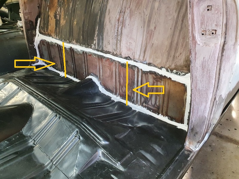

Gents,
I need a measurement for the lower bulkhead panel, measurement needs to be take at the area show in the pic.
any help much appreciated.

My ute is missing this panel and has an opening of 300mm, I'm thinking whoever removed the panel trimmed a bit extra?

My one is 285mm but the mid join is modified a fair bit so maybe not the best one to measure. Why not talk to the fellow who just made one?

Brett027 wrote: Wed Feb 02, 2022 9:50 am My one is 285mm but the mid join is modified a fair bit so maybe not the best one to measure. Why not talk to the fellow who just made one?
He made the first panel for a ute with aftermarket floor pans and is finding some variation in the size / depth of the panel required in relation to the pans.... Mine for example has been trimmed back to 300mm and yours is at 285mm.

Just measure my ute and I have 285 mm floor to the crease and 320 mm floor to the fold line.

Yes of course, different floor pan height will come up here where peeps like me have banged in a new one. Need an original floor I think😀

Measured my original floor pan to seam 290mm. When I say seam it is actually the rear deck height, being the panel van but ute deck is the same.

I measure just shy of 295ImageImage

ziggy wrote: Wed Feb 02, 2022 5:18 pm I measure just shy of 295
Sent from my SM-G988B using Tapatalk
Original floor pans?

Yes, all original. Just blast and paint ImageImage
