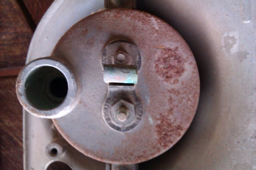

Did as Scotty said, but still not working -
Pictured below is a spare fuel guage I have - wondering if anyone can describe where the wires should be, power, earth etc.
On the one in my dash there is only a single wire to the curly contact between both pins (sorry for the lack of proper terminalogy) - is this right.

The spare guage is reading full and its not even in a car ??? - might not try using this one.

Sorry 'bout being a bit short on time this morning Marko....had a '36 tudor on the hoist and the boss in my ear!
Have you tried earthing out the wire from the sender to ground?
With the ignition switched to "ON", take the wire off the sender and touch it to a good earth on the body.
If the gauge goes to "FULL", you know that it is definitely a fault with the sender.
If the gauge does not move.........I'd be looking to replace that!
For memory, the wire to the fuel gauge under the dash is as follows...........
PINK +Positive feed off the "ON" position from the ignition.
BROWN - EARTH feed from the tank sender.
GREY + positive dash lighting.

Cheers Bob, thanks for your advice, it worked a treat.
All sorted, fuel guage working.
