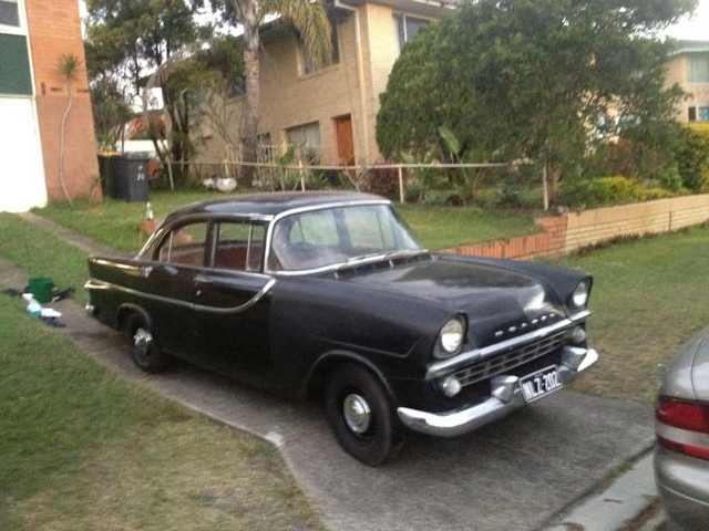

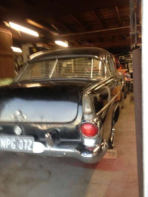

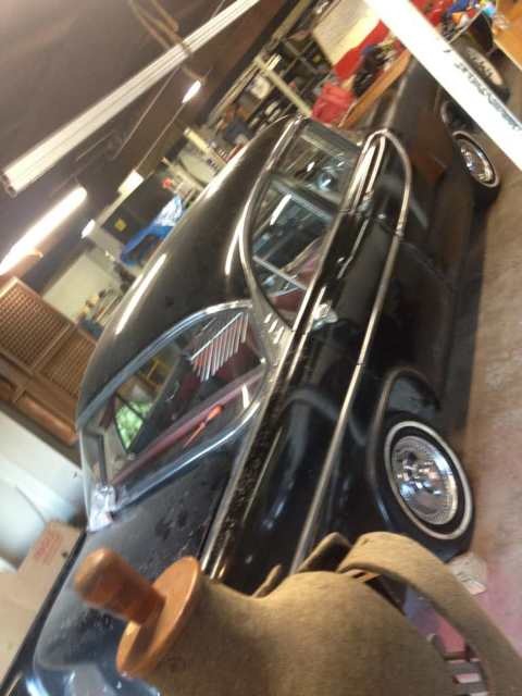

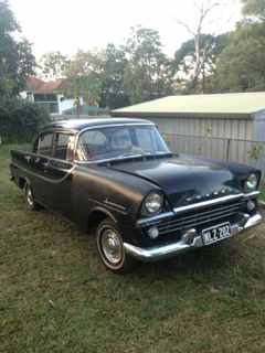

Hi guys been a while but finally worked out how to load via iPhone. My black FB 1961. Bought it 2 years ago it has been sitting since about 1980. Did not run or drive and needs resto but does not look to bad.
basically I decided the first thing to do was to get it to run so pulled the plugs squirted oil down the pots fill up the radiator and put a battery in it and boom it ran. Water pump screaming exhaust half missing it was running. Pulled all the brakes wheel cylinders out and master cylinders and all clutch hydraulics out and replaced it all. Upon that task I managed to drive it away from my house I sold and drove it 600 metres to a mates for storage
stored in at my mates for 6 weeks and towed to my new place now.

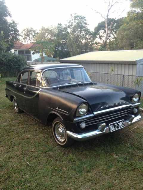

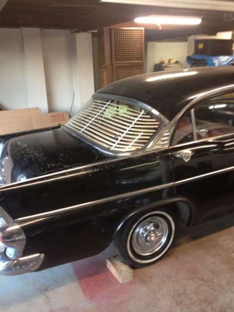

So I managed to get it to run and drive but did not have it running off the tank. So drained the tank ran fresh petrol down it still would not run. Undid the pick up poked wire through and she now runs off the tank. I had this idea that I would restore the mechanicals leave the surface rust and drive it.
The body requires work the paint is had it lots of surface rust but after 2 hand polishes it still retains a shine. Both rear doors require replacing left hand sill needs replacing you could repair but I would prefer to replace it. Floors good right sill good and a few other rust issues to mention. Stay tuned

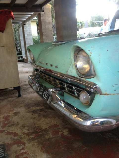

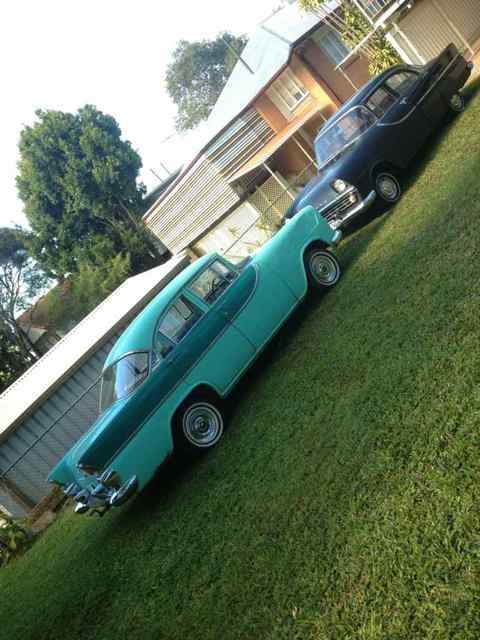

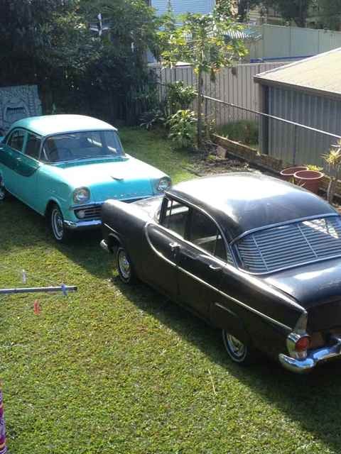

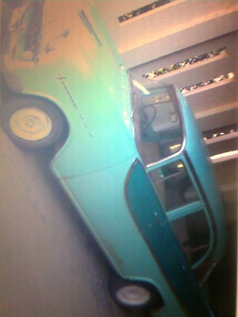

Thanks guys will talk to about it as I head down the path with it. My original plan was to keep the body fairly unrestored but upon further inspection I have to pull her down. Thought I would also share some of the other cars in my life. Between myself and my cousin we have enough to keep us busy. Next car to introduce is a 1960 FB Holden sedan. We picked it up from Wagga a few months ago original nitro car
the eBay photos we commited to buy it not really knowing how it would turn out.
first photos back home last on rego 1993 the previous owner saved it from a scrap metal guy. Fuel down the carny and with the water pump seized it ran like a clock

so now 2 FB's here to deal with. The green car needed all the hydraulics and brakes doing so that was our next thing . Upon that we got it to drive but yet to run off the tank. Also needs floor pan repairs and lower back guard repairs. Someone at some point changed the fuel tank over to a FC fuel tank so the filler neck is too short. Have acquired another mint tank. This car has mint chrome, cast and stainless. Plans are to only run a few touch ups and that will be fine
