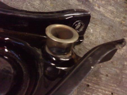

Hi all,
anyone come across this??
I've just discovered my replacement lower control arm has a different size and shape bump stop holder, and of course it had to happen after I'd painted it. :evil: :evil: :evil:
I think it looks to be FE/FC or early FB. Rare Spares only stock one size that covers FE to EK (small).
Looks like a I may have to get another arm of maybe swap over the holder from my original arm.

Thanks Les, I could'nt find those ones, I must be going blind!! :roll:
I thought about just fitting a different bump rubber but now decided against having two types on the front.
I ended up swapping the bump stop of my old control arm to the new one so I can retain the original style stop.
Drilled out spot welds on both arms and fitted original bump stop to new control arm.
