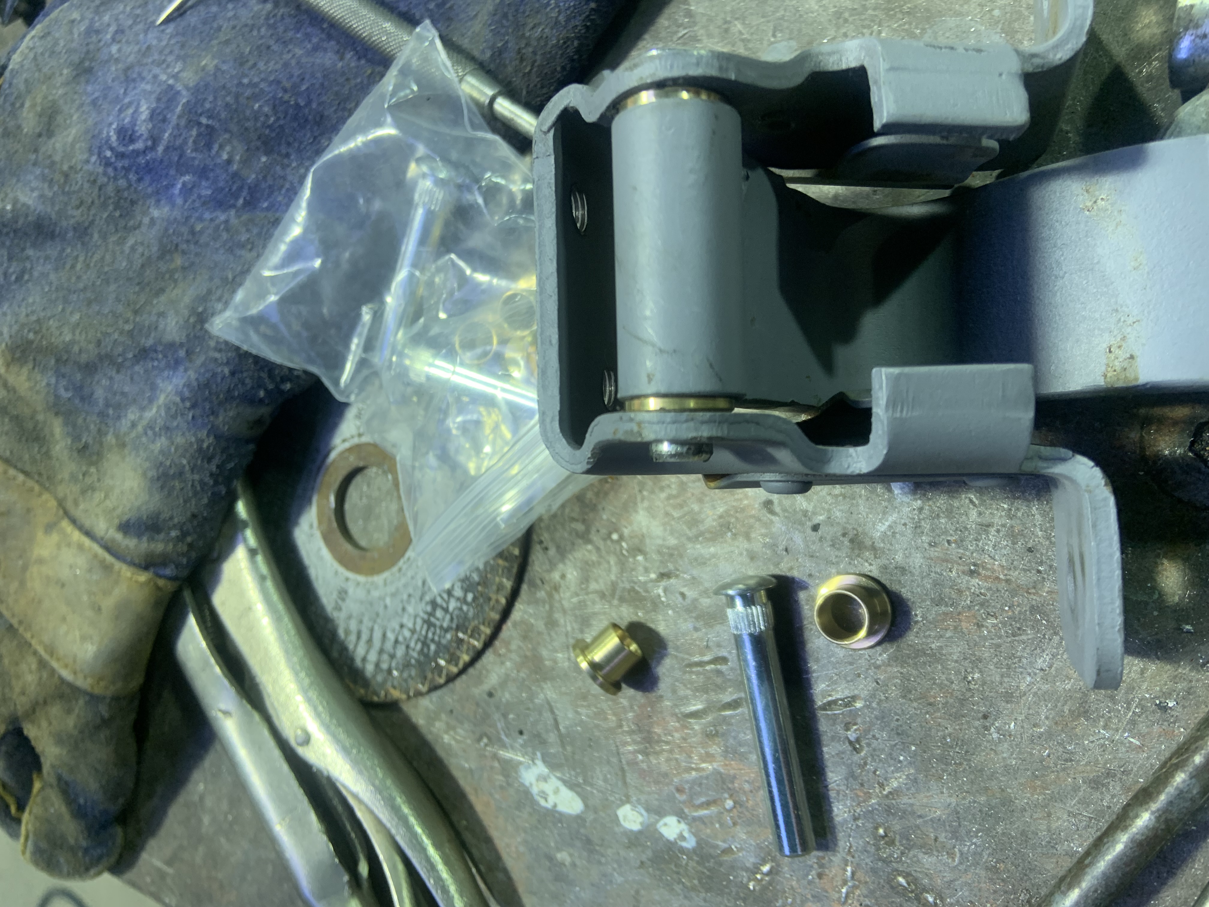

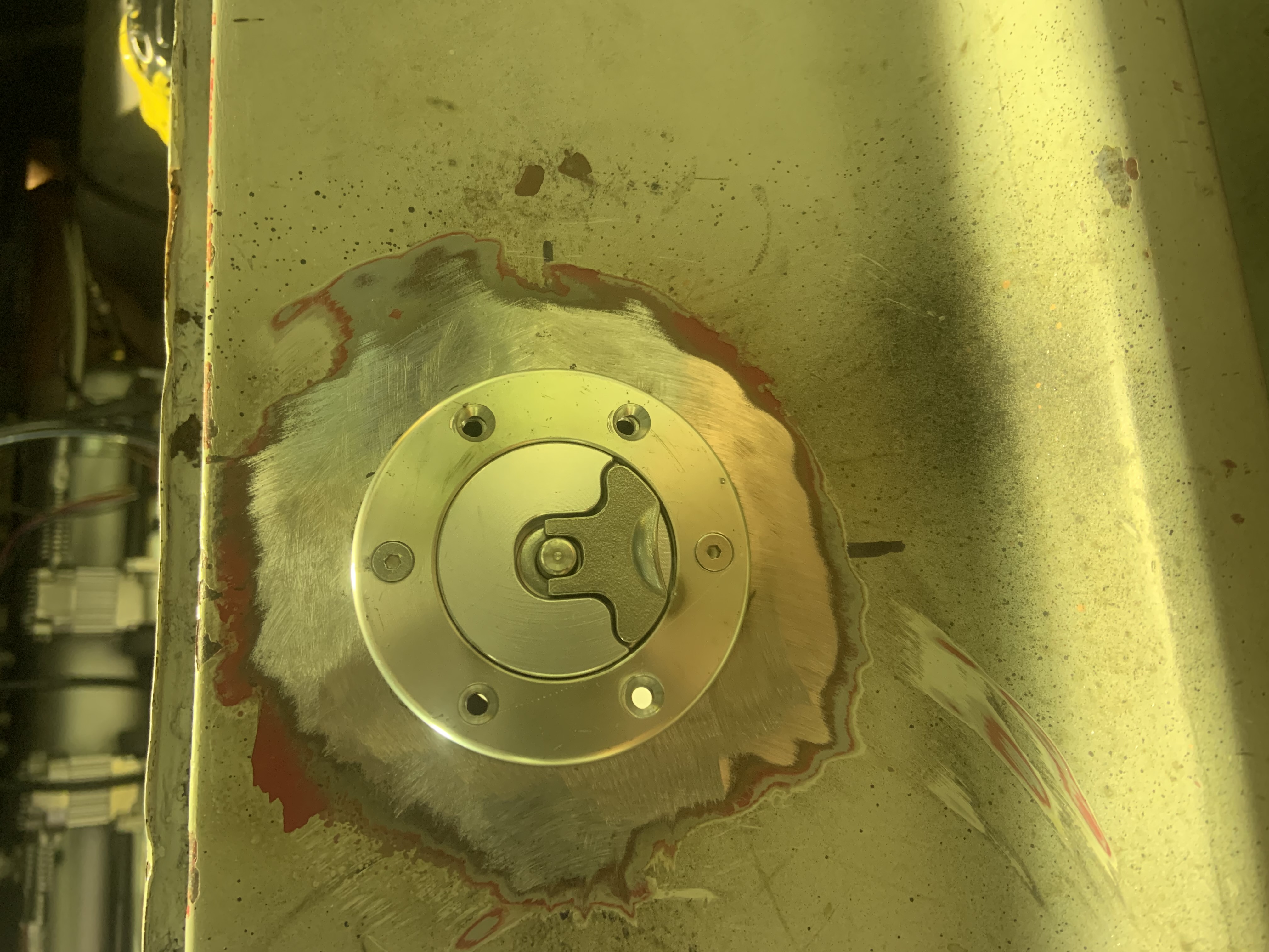

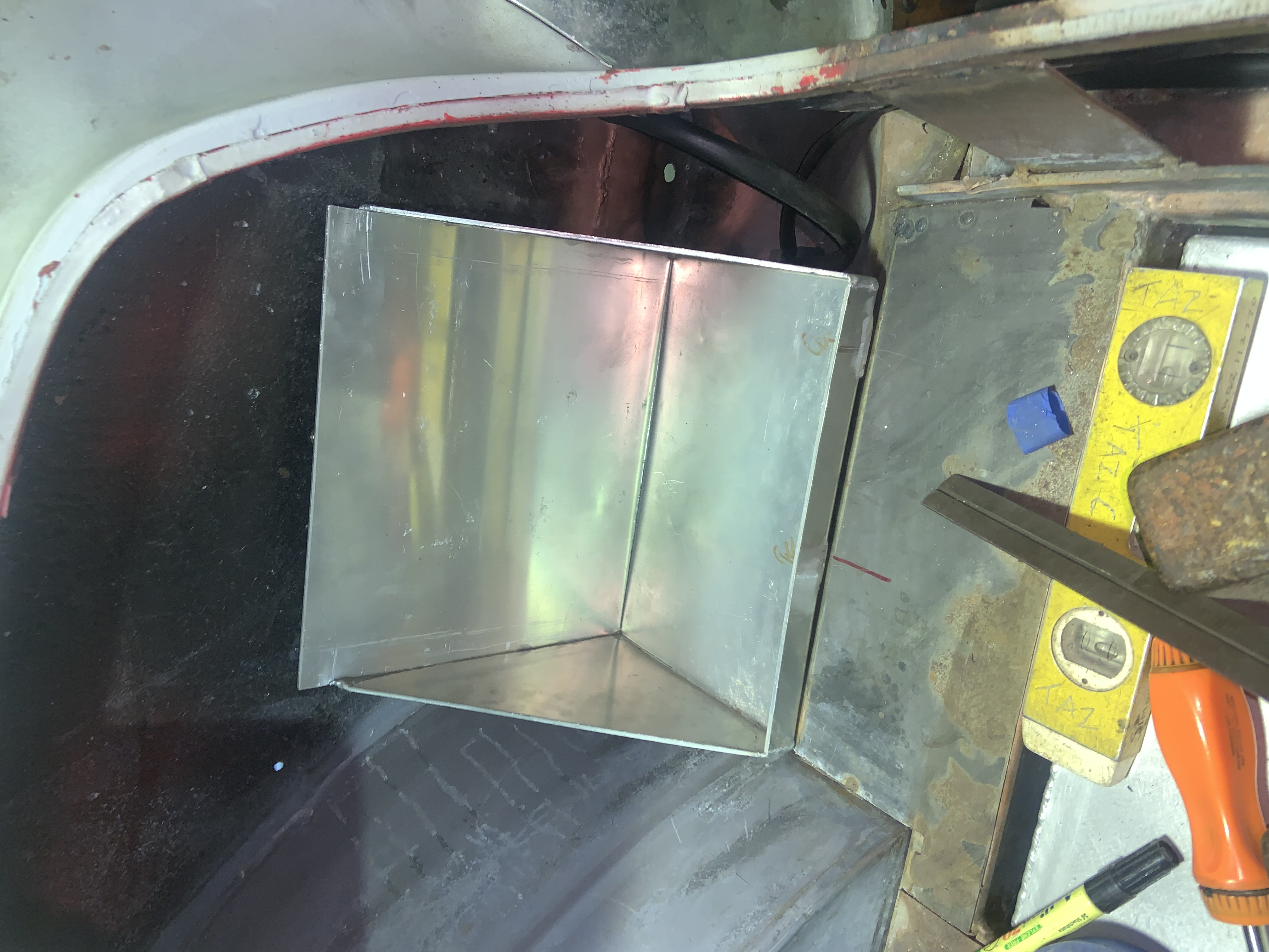

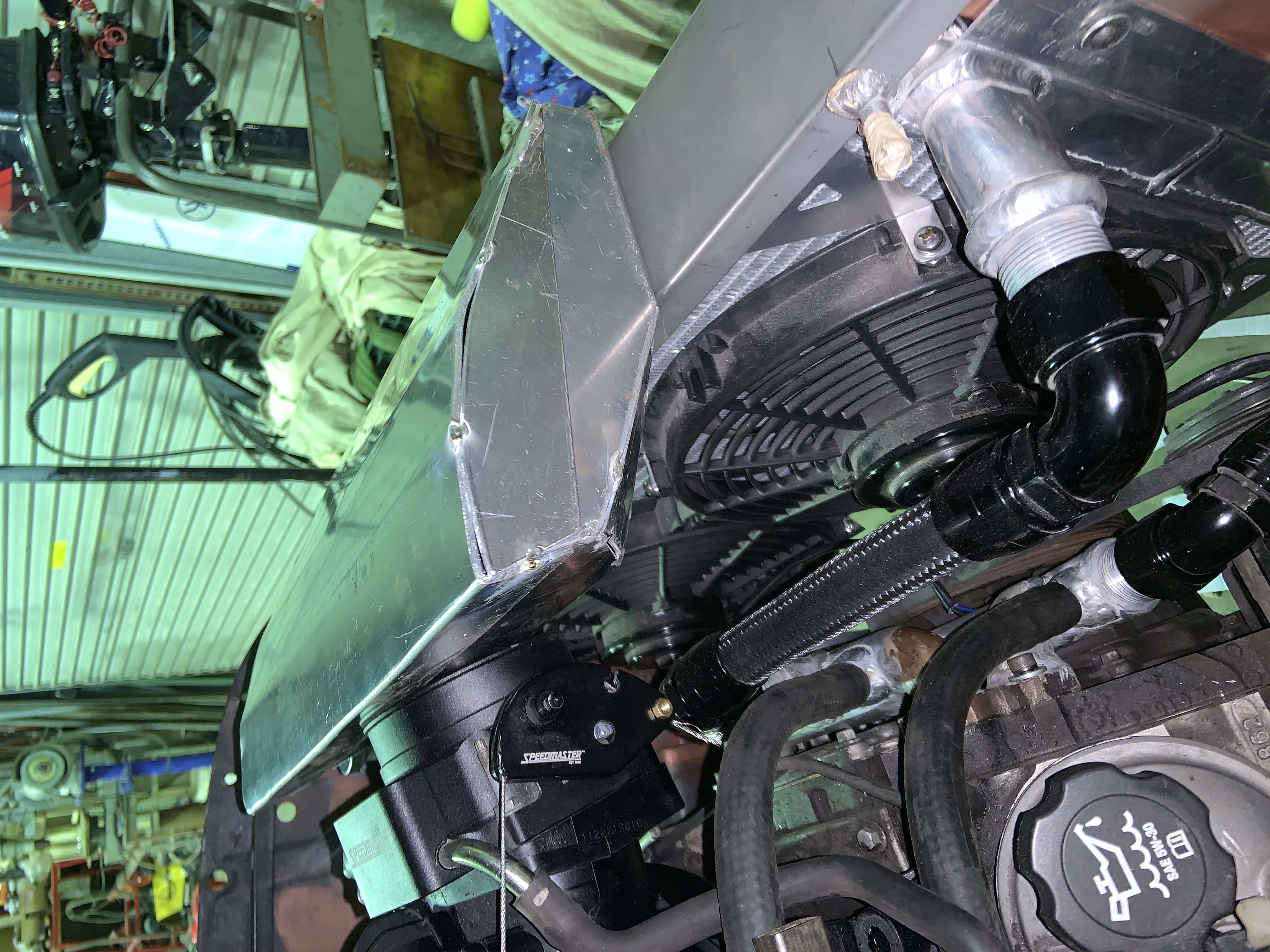

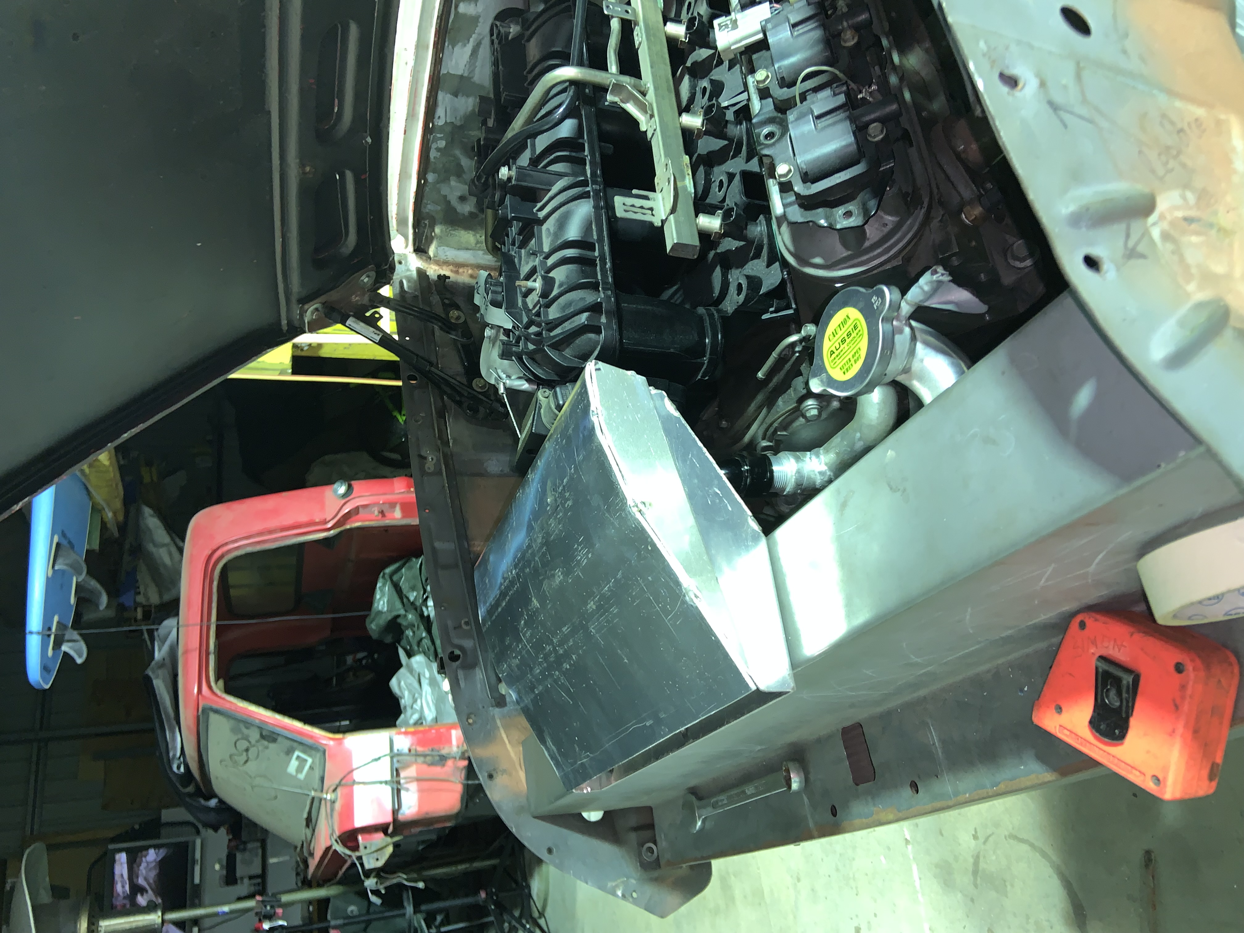

Battery tray mounted, fuel cap and filler sorted but need to do a breather, now to mount the radiator overflow tank and fabricate up a washer bottle tank.
Also fitted new door hinge pins and bushes.
Posts: 11665
Re: LS1EK
Lining up beautifully

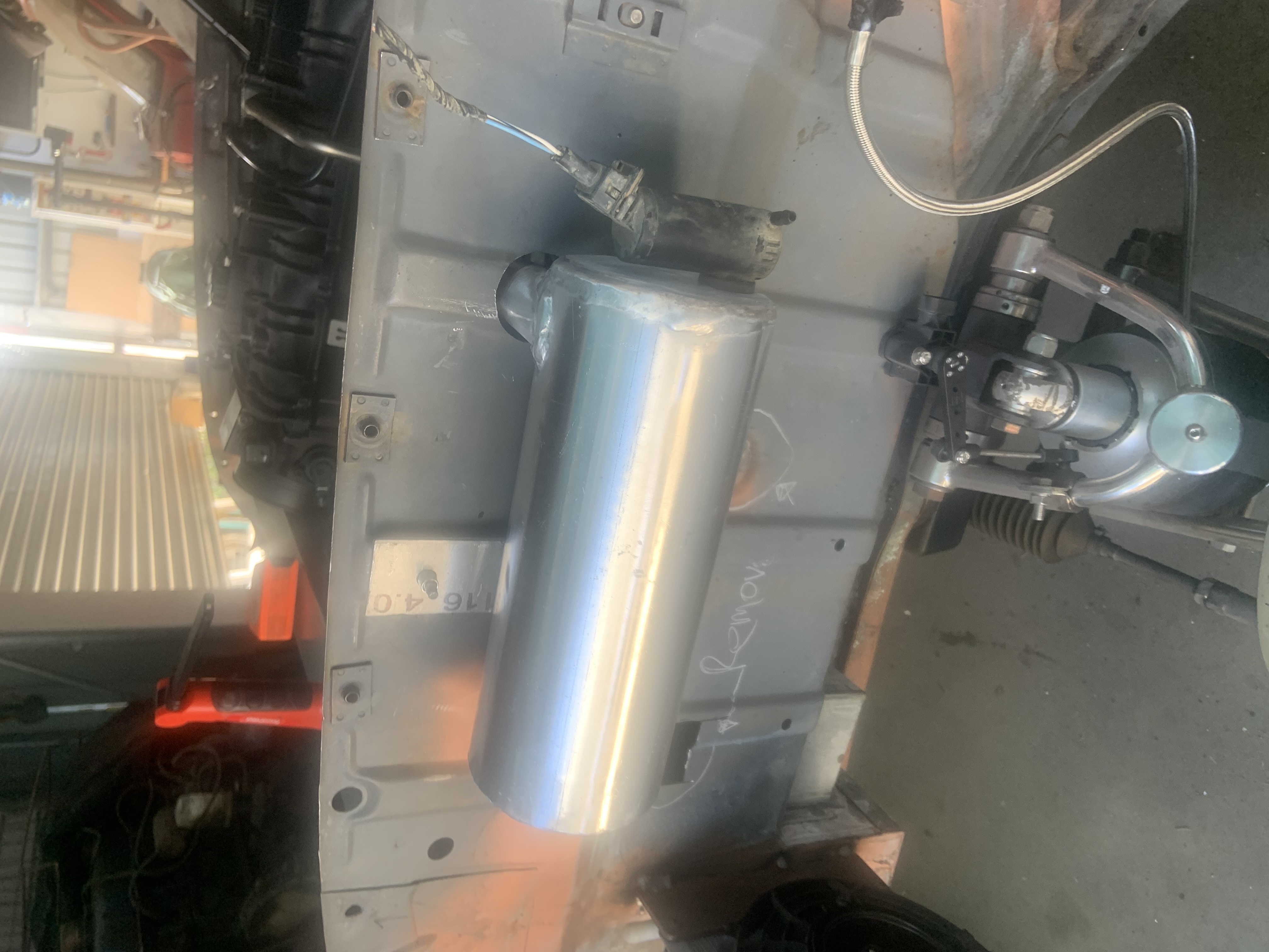

Post by TAZ »
Washer bottle ✅
Posts: 5741
Re: LS1EK
That's one neat washer bottle. 8)

Re: LS1EK
Post by TAZ »
Harv wrote: Mon Oct 23, 2023 8:19 am That's one neat washer bottle. 8)
Cheers Harv, used scrap from under the bench and the washer pump on the donor statesman.

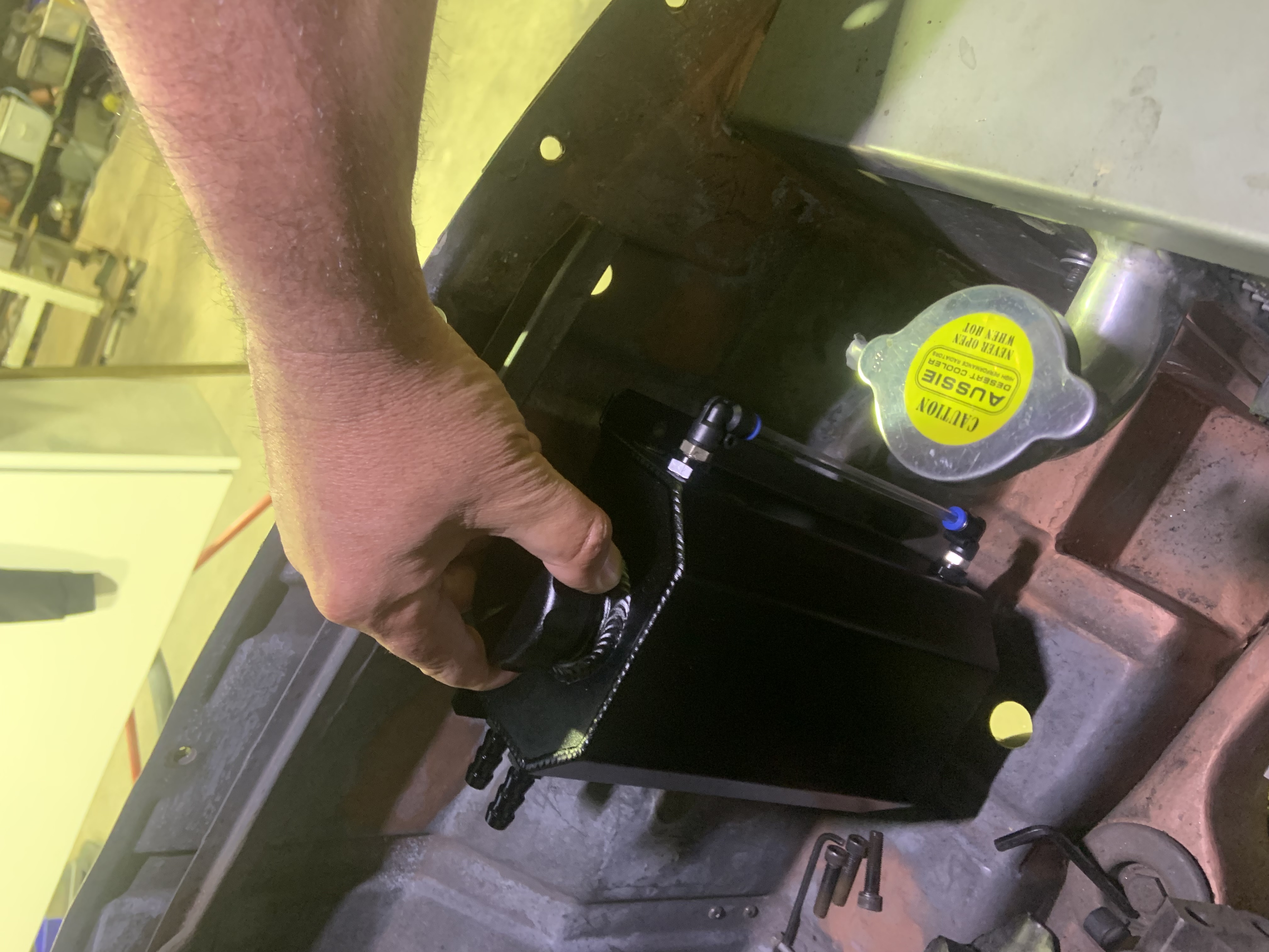

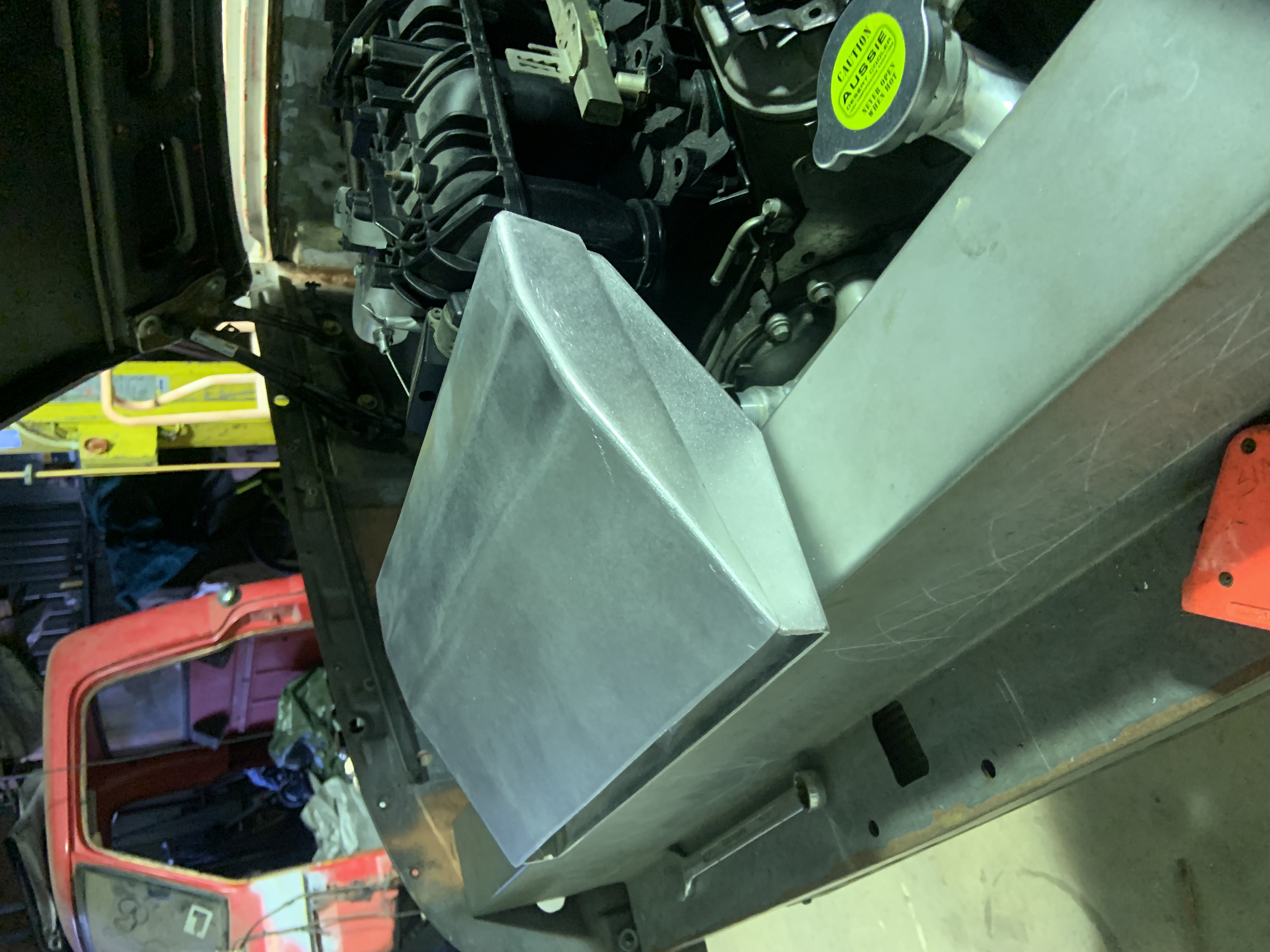

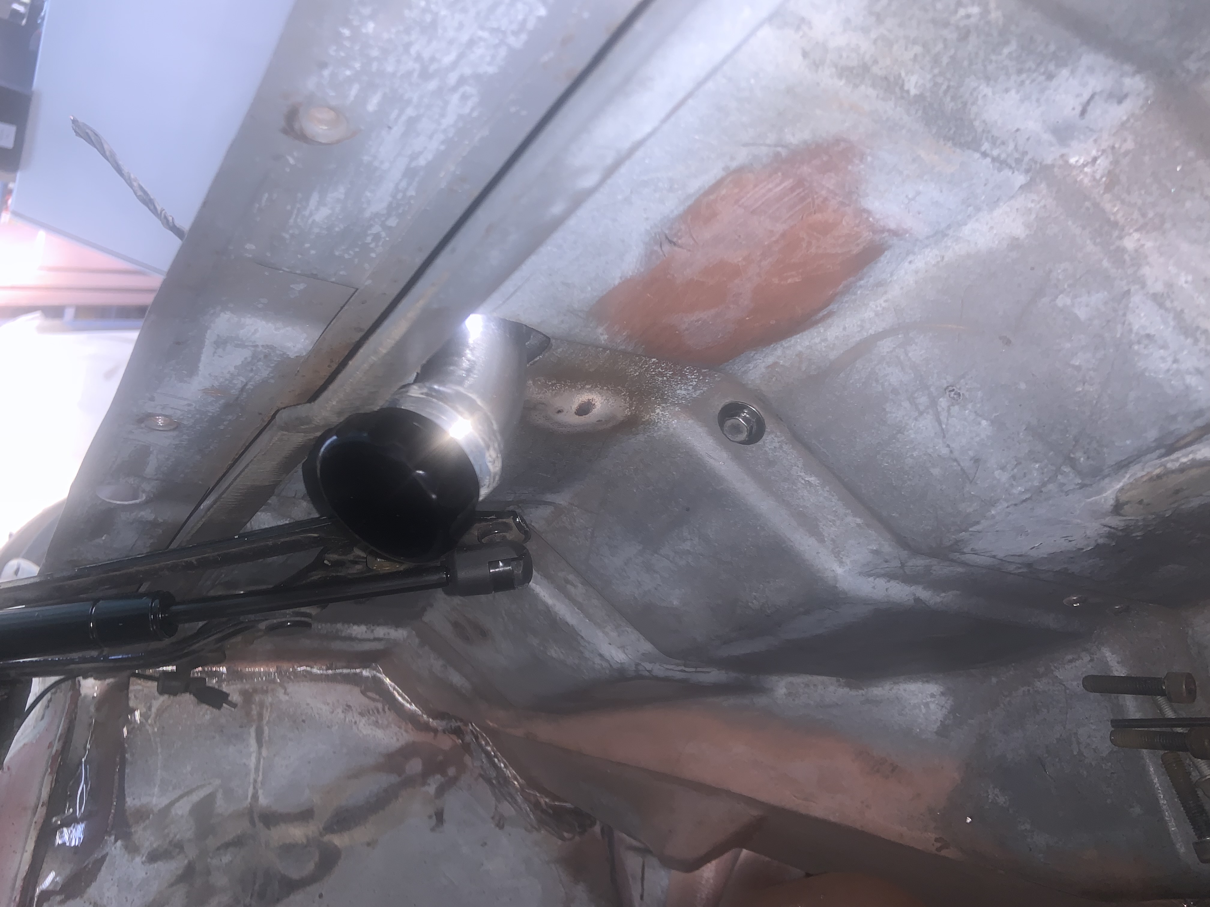

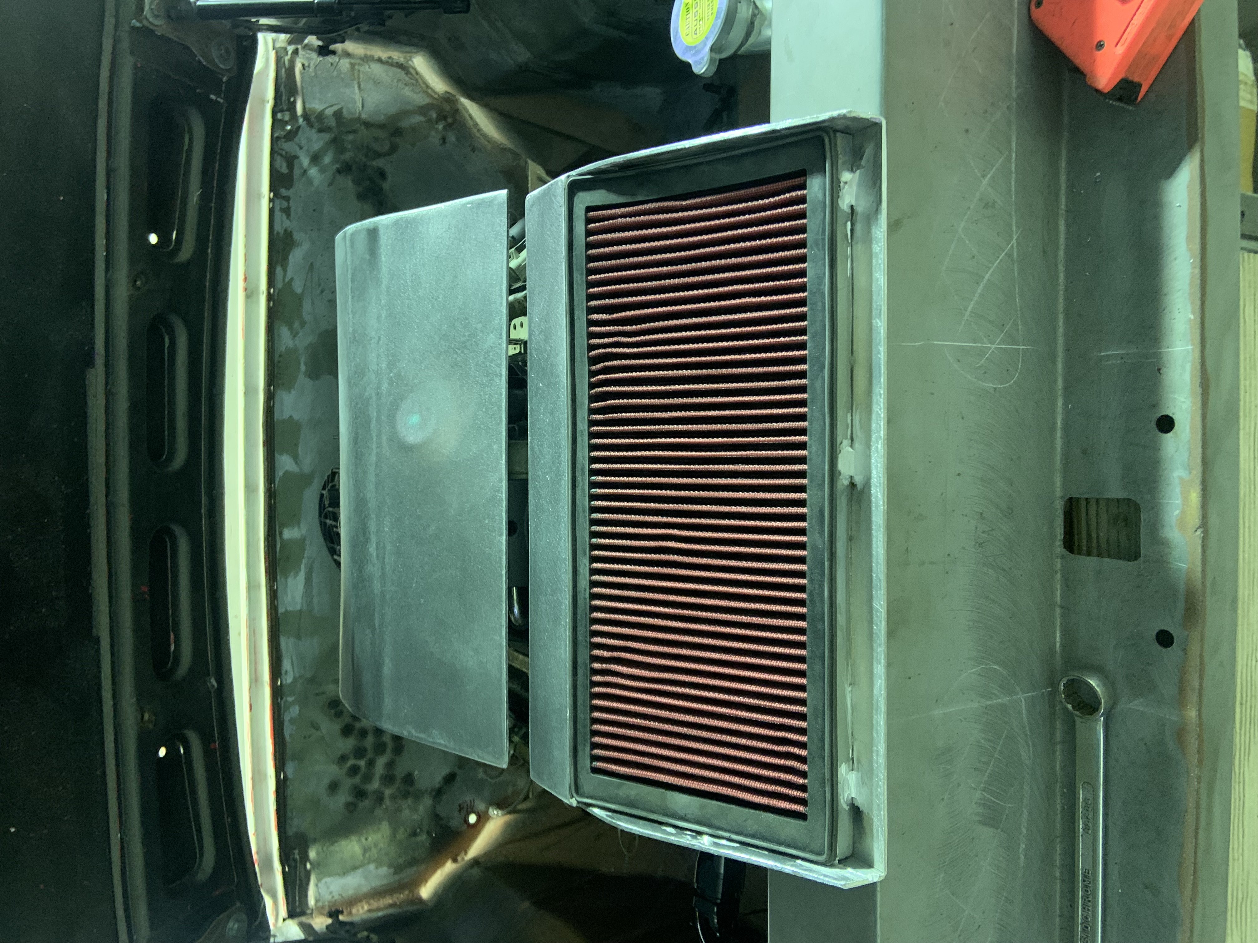

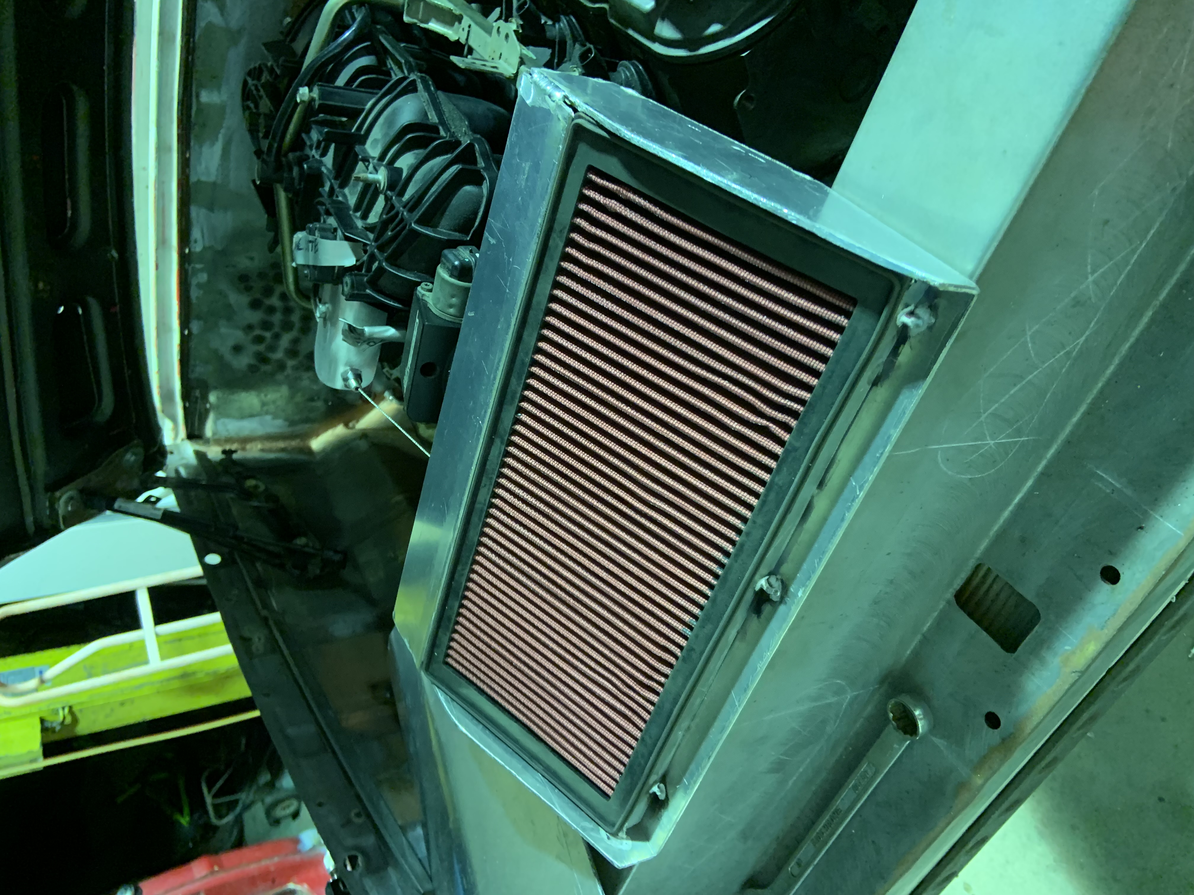

So, back at it and have fabbed up the air filter housing, there was not way I was going to stick a pod filter on it.
Once finished it will hopefully look as it was fitted
In the factory.
Posts: 14271
Re: LS1EK
:thumbsup:
Posts: 11665
Re: LS1EK
Nice work Taz
TAZ
Posts: 382
State: TAS
Location: hobart

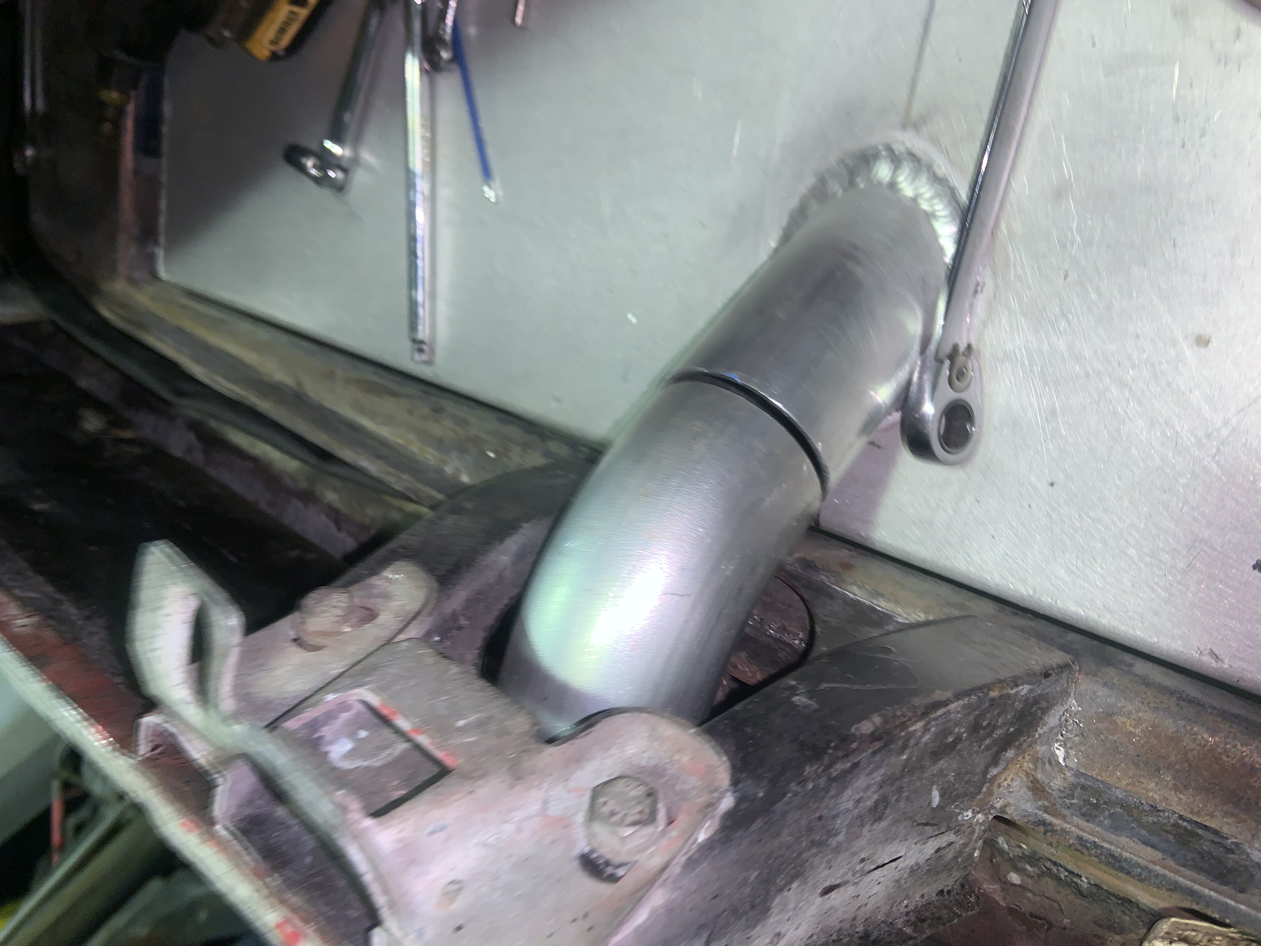

Re: LS1EK
Post by TAZ »
Just need to get the rubber to attach it to the throttle body plus a couple of fixings so it stays on the right spot.
Posts: 11665
Re: LS1EK
Nice work indeed.
