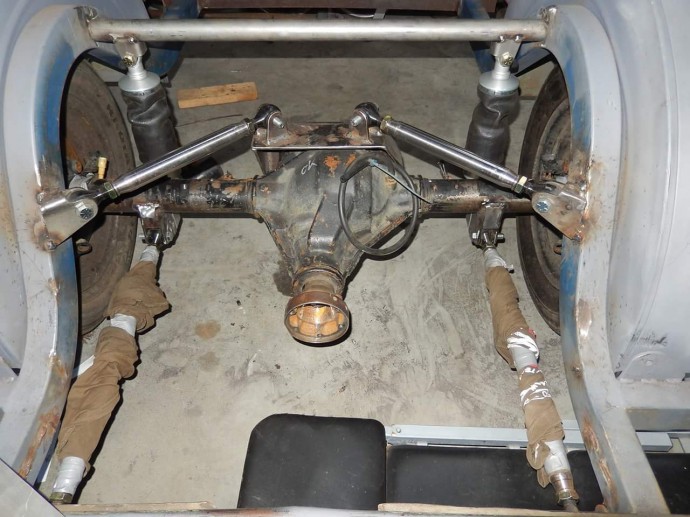

Nice one Taz, be good to follow your build on here - unusual looking diff , what is it out of ??? did you make the supports for the top arms or was that already done ?

Blacky wrote:Nice one Taz, be good to follow your build on here - unusual looking diff , what is it out of ??? did you make the supports for the top arms or was that already done ?
i was wondering the exact same thing.
The diff is out of a VZ SS Crewman, which been shortened accordingly. Cheaper than a nine inch and lighter. The bracket for the triangulated arms was fabricated by me but based on designs googled. I did this because the centre is offset and nodular iron, so not easily welded. I have gone triangulated to negate the need for a watts linkage.

So the bracket bolts on ?

Blacky wrote:So the bracket bolts on ?
Yes Blacky in between the inspection cover and housing. I have also installed two 10mm dowels so that it always goes back on in the same place, do a google search and you will find kits from the US that are done exactally the same way.

Re: LS1EK
Clever !! Not seen that done before .....
