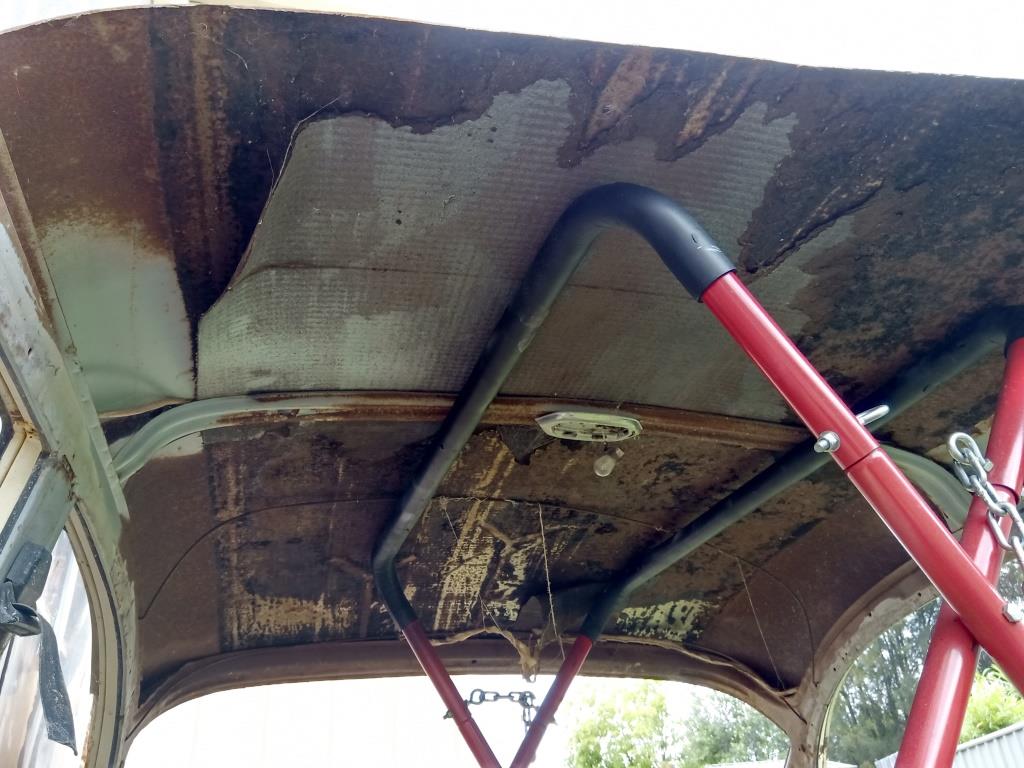

I would be more inclined to replace the entire turret than try to weld that patch in , that looks like warp city to me, way beyond my capabilities ...... :shock: :shock:
Orange Betty
Posts: 150
Location: Canberra Region
Post by Orange Betty »
Warpage is what I'm worried about Blacky.
Do you mean replace the entire panel between the end and middle support?
Dave
62 EK Sedan in slow progress
Posts: 2536
I think the more common approach is to uncouple whole roof at gutter and windscreen spot welds Dave and replace. I'm just checking with a mate if he has one😀
Posts: 14271
Orange Betty wrote: Wed Oct 13, 2021 7:55 am Warpage is what I'm worried about Blacky.
Dave
I mean chop it through the A, B, and C pillars and replace the lot - make a frame that fits your front and rear windscreen gaps, brace the body and chop away - fit your seat belt plates while it’s off too 👍

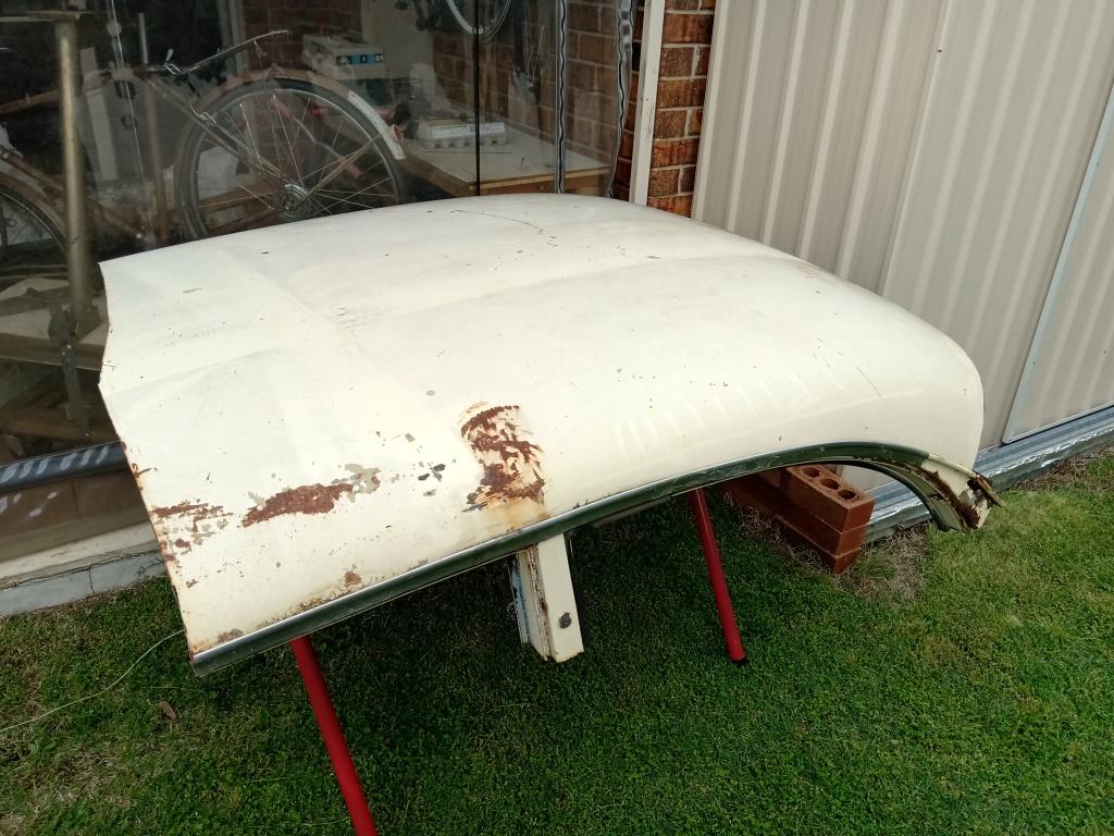

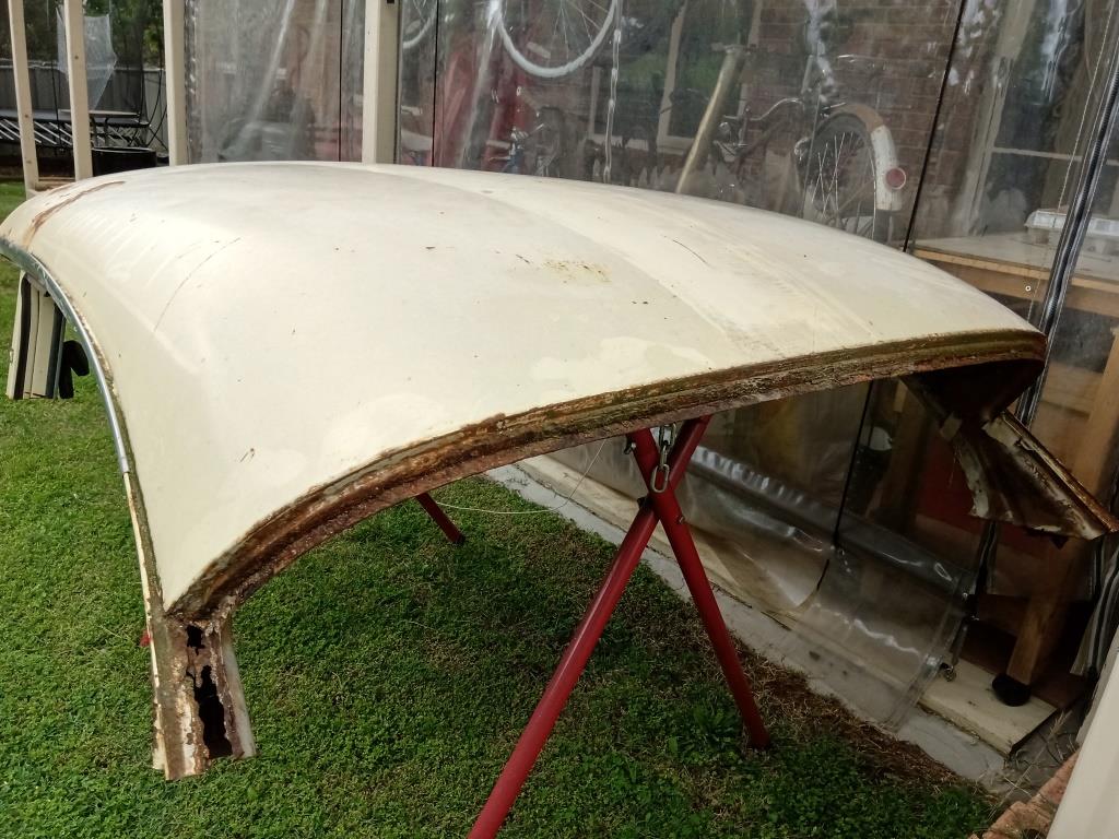

Ok, young Brett convinced me to rethink my roof strategy and put me onto the bookFace forum for FB/EK parts which rather promptly turned up a few roof cut options. So after a rather wet trip out to Junee yesterday (3hrs each way) I have this:
Roof cut1.jpg (138.76 KiB) Viewed 3432 times
Roof cut2.jpg (145.24 KiB) Viewed 3432 times
Roof cut3.jpg (111.9 KiB) Viewed 3432 times
The gentleman I bought it from had a few FB wrecks in the yard an FB sedan and wagon under construction in the shed and a very nice and completed wagon with a 3 inch roof chop! I'll stay stock with mine once I figure out what to do next.

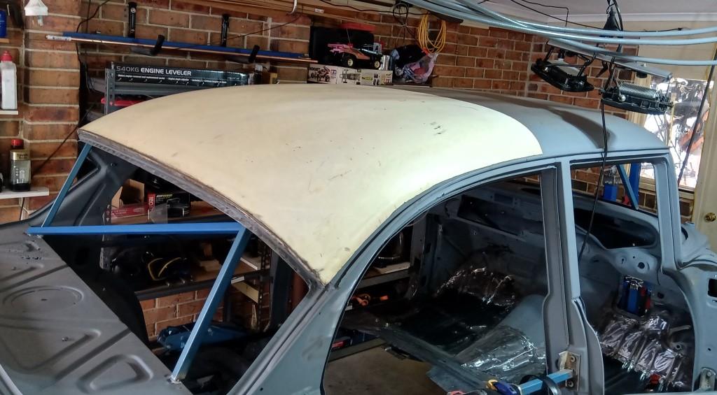

New old roof!
New Roof.jpg (99.08 KiB) Viewed 3363 times

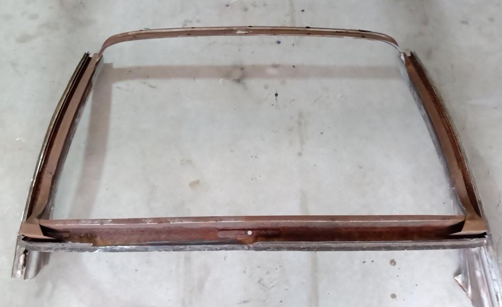

Well almost, it is just sitting there over the current one. After lots of procrastination I just bit the bullet and cut the skin off the donor. And this is what the roof structure looks like underneath
Roof structure.jpg (55.68 KiB) Viewed 3363 times

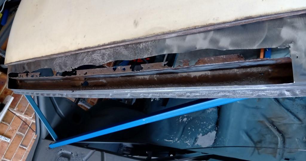

Well I'd never seen one before. Will have to utilise all/some of the rear support as mine is much worserer
Rear support.jpg (74.12 KiB) Viewed 3363 times
