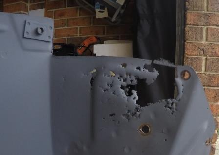

So Orange Betty (OB) was blasted and is now primer grey but I didn't do much since September last year as I was building myself a rotisserie. Took a long time as I only get a few hours each day of the weekend but was good welding practice and successful. But despite mounting OB on the rotisserie and taking her for a twirl I've just got her level and taken the front rotisserie mount off. I had removed the left hand outer sill and cut out what was left of the bottom of the A-pillar but heeding the advice of forumites I decided I shouldn't 'fix' anything until I had the subframe and doors on and could check that everything aligned.
So I made up a dolly (ie?) for the subframe and test fitted which was ok, but before fixing the bottom of the A-pillar which is quite daunting, I thought I'd tackle an easier 'fix' for the first try and do the subframe and body mounting points. The one specifically:
LH subframe wall att.JPG (145.72 KiB) Viewed 31230 times
And hence the milestone, OB's first bit of actual repair!
OB first fix.JPG (153.12 KiB) Viewed 31230 times
Had to chase quite a few holes I blew in the old metal which I suspect is a lesson in making sure I cut out to good metal to start with.

Good on ya Dave. Looks like you are doing a neat job as well. Thanks for sharing progress.
Posts: 11581
Looks like your on track Dave. Good place to start. All those sandwiched panels are a rust trap. One of the harder parts I found when I did this on my van was getting decent penetration at the top where the windscreen surround joins. Important this bit is nice and strong. Another hard bit was holes in the recessed bit.
Look forward to following progress.

Good to see your into it. Plenty of help here with folk who know the ins & outs of these old cars. Will be watching with interest.
Posts: 14174
Good stuff Dave, tackling an easier part first is a good way to both learn and gain confidence in your own abilities- and as my panelbeater father in law tells me - it's only metal , if you balls it up just cut it off and try again !

Good work Dave and goodonya' for having a crack. As Blacky said, it's only metal :)
Looking forward to more updates and photos.

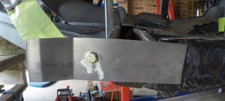

Hi all, so a bit more progress. As per previous posts I thought I'd just do simple bend in some flat bar to be the inner sill extension and to bolt the outer sill through to the subframe. But as I was mocking it up it became apparent that the design of the standard inner sill extension allowed for somewhere to join all the other panel work to (yes I usually only figure this stuff out on the run...). So I thought I'd throw in a few bends here and there:
Didn't quite get it right the first time or second time or even the third time but the third was close enough for me to add on a few of the tighter bends as an afterthought, to mirror the bottom of the inner sill. And so have ended up with something almost like a bought one:
Final 2.JPG (43.27 KiB) Viewed 30924 times
Have just screwed the front flange of the x member for now as it was too hard to get to and didn't mate nicely with my plug weld holes. Then bent up some 2mm flat bar to match the profile of the rare spares outer sill and my best guess at the A-pillar profile and hey presto, a semi-sound structural repair.
A pillar brace.JPG (39.14 KiB) Viewed 30924 times
Enough to get back onto the rotisserie to tidy up, do the panel work and get to fitting the outer sill!
Dave
62 EK Sedan in slow progress
Posts: 14174
nice work mate, is extra satisfying when you fab up something yourself that works rather than just buying one out of a catalog. :thumbsup:
Posts: 11581
Good progress Dave. I’m with blacky on the satisfaction factor. I use tek screws quite a lot to hold things in place, weld up, remove screws and replace with plug welds.
Posts: 2782
Nice work Dave, don't forget to put a crush piece in between the inner and outer mate.
