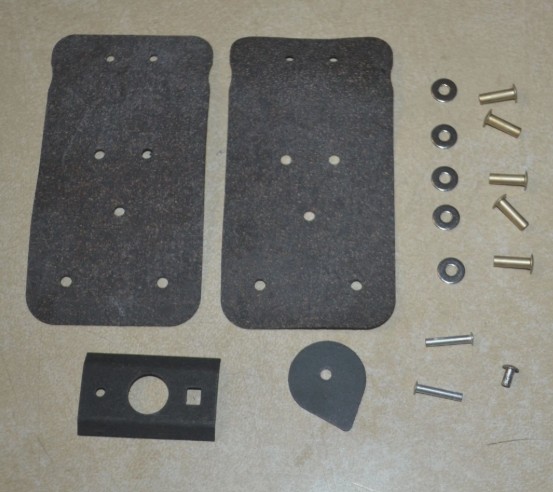

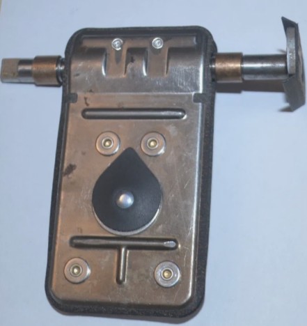

My next challenge is to try and rebuild my vacuum washer pump. Sourcing a new diaphragm is going to an issue. In the hunt for this part I have come across a vacuum wiper motor paddle parts kit. It suits a XK Falcon, but I think it's a good chance it will suit the FB. I don't need to replace mine as they are working really well, but it would be nice to have a spare.
