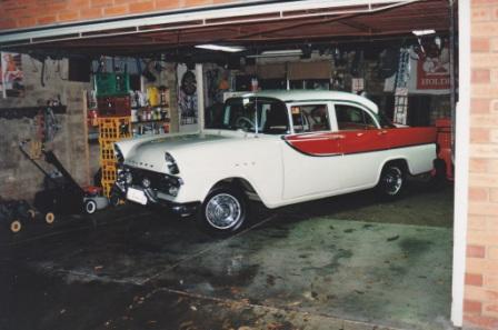

Anyway I've posted some pics for all incl my old FB prior to this one, and one new addition to the shed last year that is just teasing me to get into it.
Where the bug for these old girls started!
Bought this one off my uncle and eventually sold it to my brother so I could start on a FC sedan with a 400 cube SBC.
Offloaded the FC but couldn't live without an early so I got this one.
This is not long after the trip from Brisbane to Melb (still on Qld Reg)
One of the many transplants after the grey was removed for a little rest.

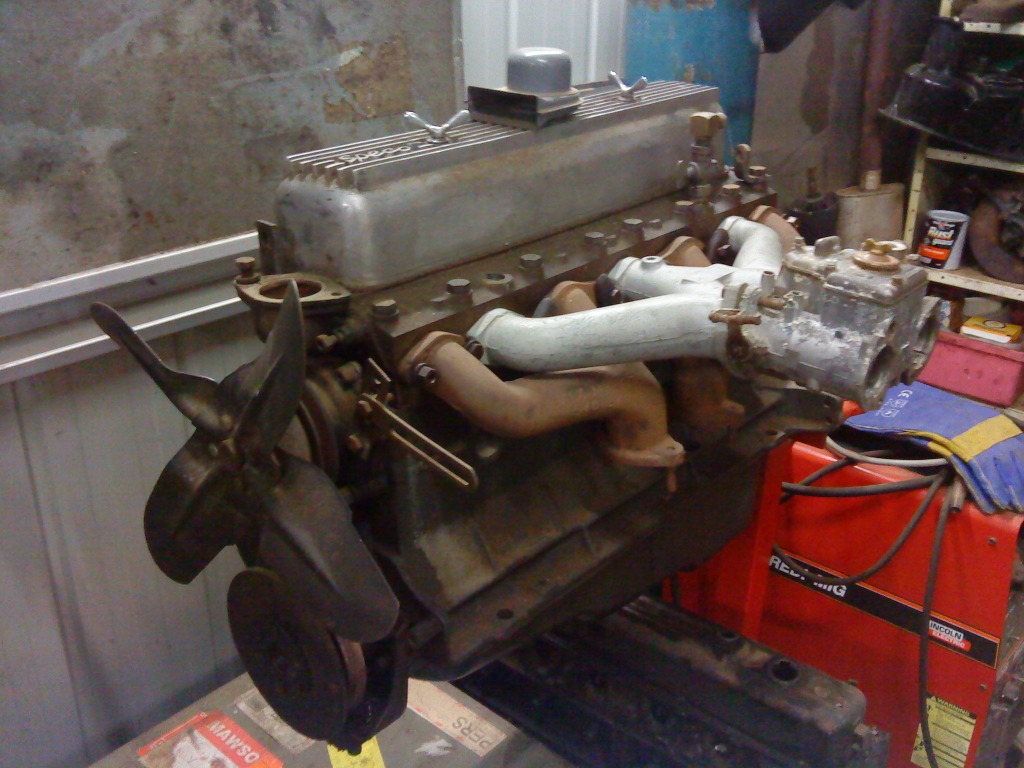

Test running the engine after fitting up the gas system and 12 port YT head and roller rockers

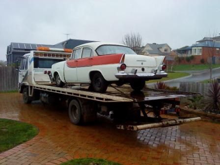

Car partly reassembled and trucked due to yet another house move

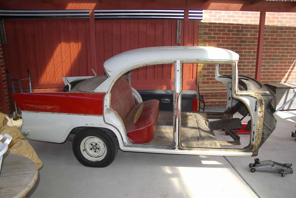

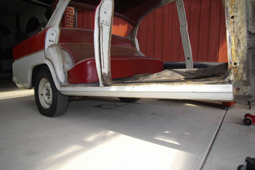

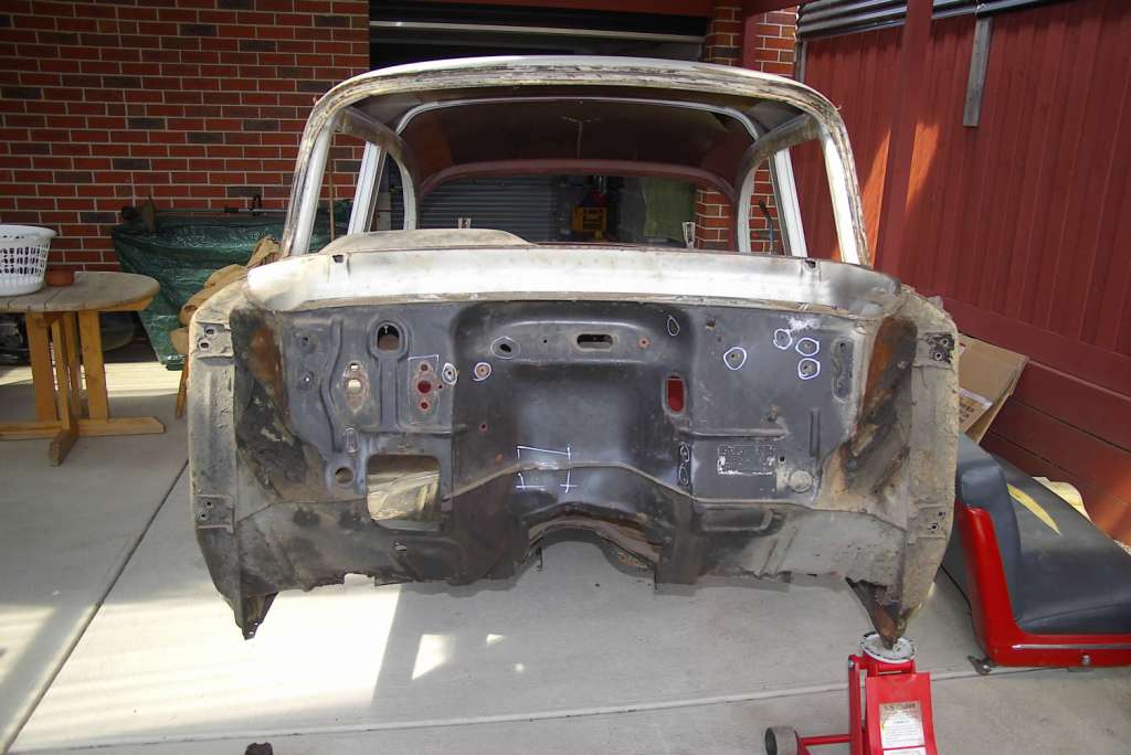

The site manager checking the job during the current teardown
Overall not too bad, just the old dodgy rust repairs on the floor to remove and some minor rust patches in a few other areas.

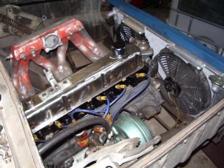

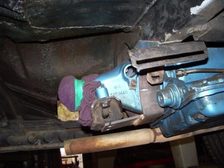

Hi MeFB,

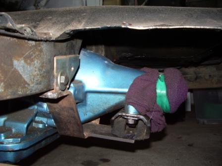

It wasn't too hard, just ended up cutting and reinforcing the front end (HR) so the engine could be lowered further and pushed forward slightly. I think from memory I dropped it about 2" and forward about 1 1/2"
The radiator was custom made and sat under the spot where the radiator cross brace was/is. I still managed to retain the bonnet catch as the rad was quite thin but had very good surface area.
Automotive 003.jpg (68.79 KiB) Viewed 50944 times
Automotive 002.jpg (70.09 KiB) Viewed 50944 times
I reworked the rear trans cross piece for the intial set up to see if it fitted. Managed to retain original handbrake arrangement too. Ground clearance a little less at trans sump but nothing dramatic.

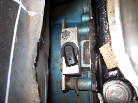

With the engine forward now it allowed me space at the firewall to start setting up for the crank sensor arrangement. It also gave me room with the EFI manifold so there was no requirement to do any mods to the firewall.

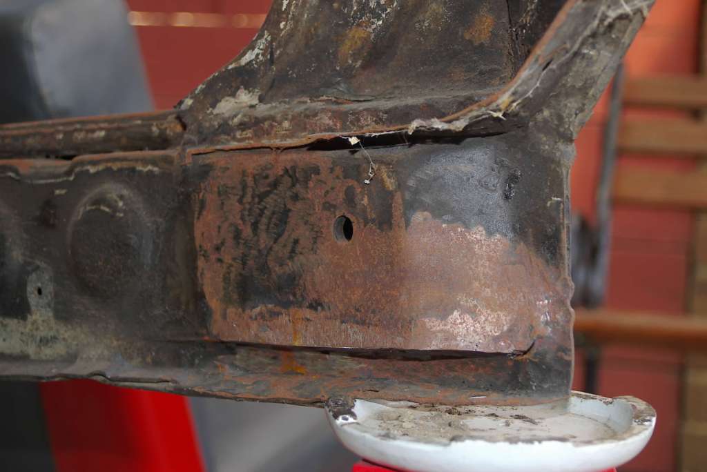

Some more pics to update the build.

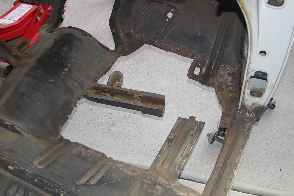

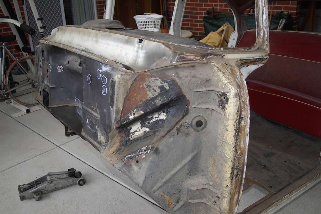

Sills and firewall looking ok so far.

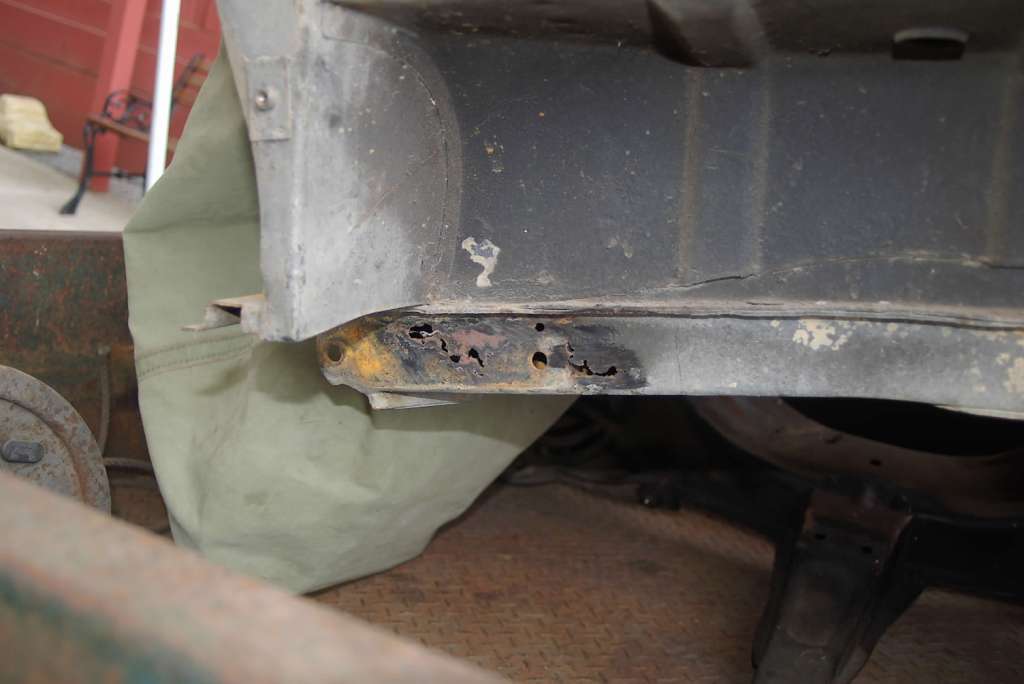

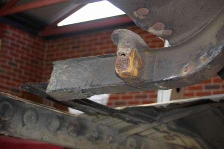

Some dodgy stuff found :thumbsdown: :thumbsdown:
Work needed on front subframe also
All panels look ok so far.
Stay tuned. :egeek:

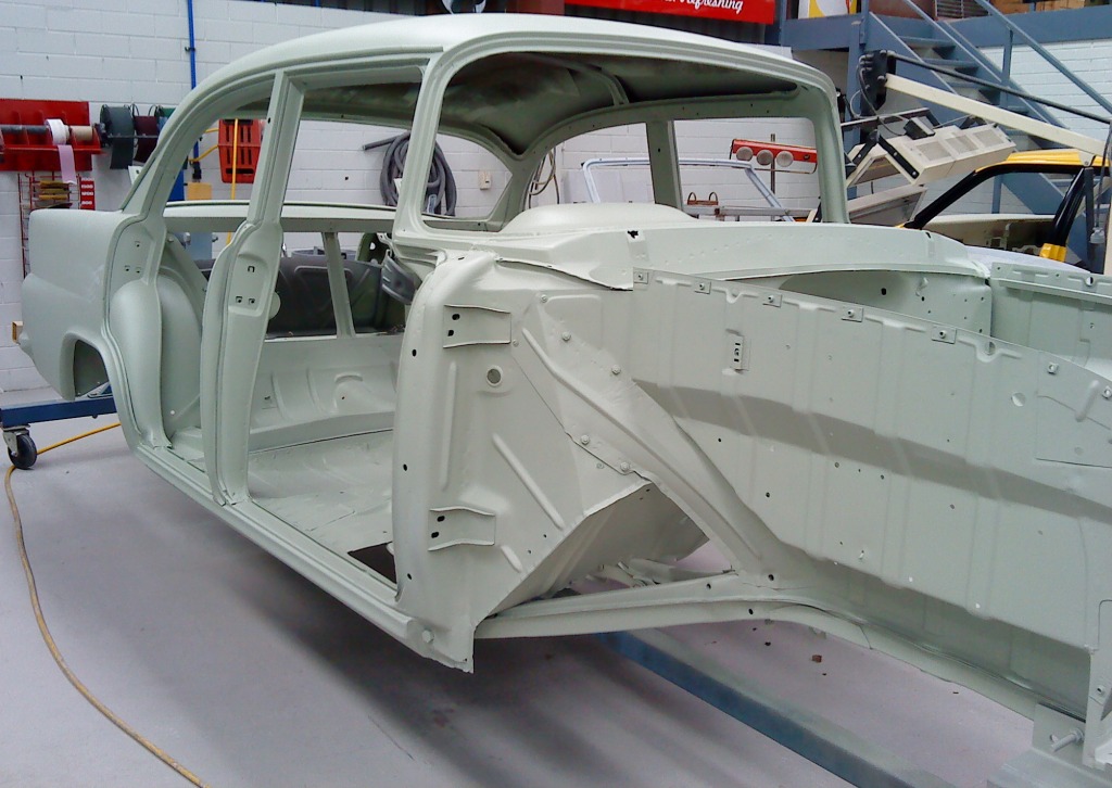

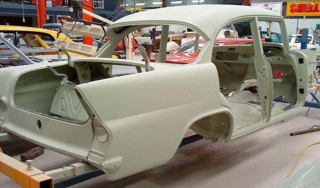

Back from the soda blasters and I'm pretty happy with it. No real suprises thank christ. :thumbsup: :thumbsup:
I was shitting that it was going to come back looking like swiss cheese. :shock: :shock:

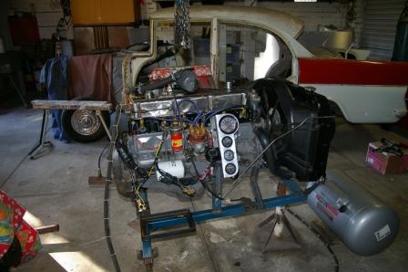

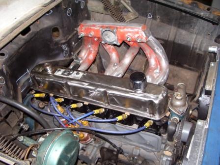

The greys been dusted off for its revival. Shown here just set up to see for fit in engine bay with Weber and Headers.
Engine is currently stripped for a bit of a check up (only done 13000 miles since last rebuild) and fitment of mild cam and less than athsmatic head.

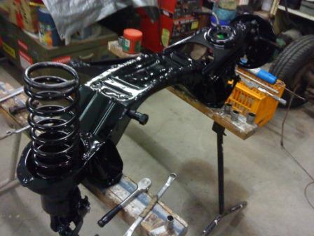

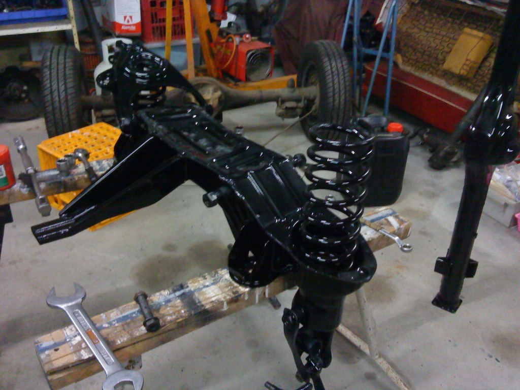

These are the most uptodate pics showing the front end being assembled after rebuild and paint work.

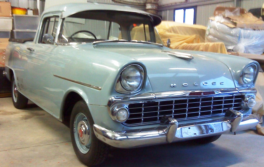

Todays update. Making good headway this week and all primed up for a big weekend of work 8)
Its Friday though :idea: A beer or two first :D then in the shed tomorrow 8)

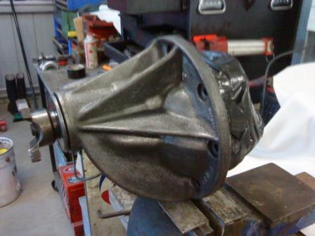

Diff centre all overhauled and cleaned up ready for paint.

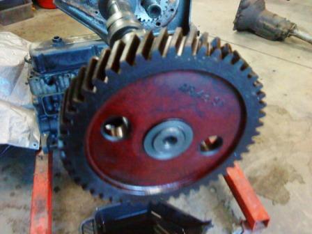

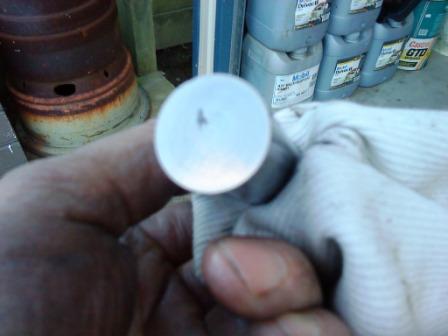

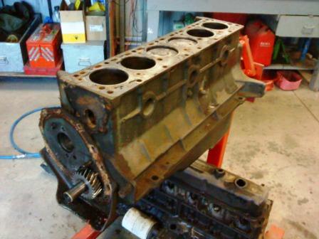

Stripped the engine a bit for cam change and a check up. All good so far, no suprises but did find some case hardening separating from the base of one lifter which was a bit dissapointing for only 13,000 mile. Fibre cam gear looks good so no issues with oil feed to that area. Will be fitting the new cam with a steel gear anyway.

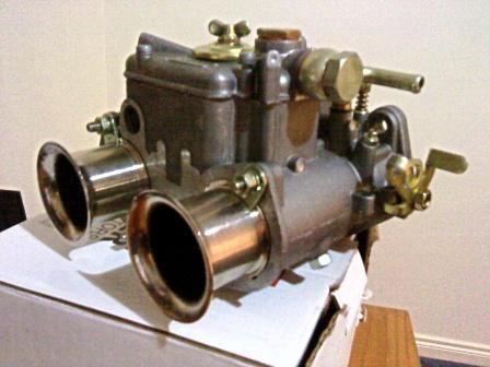

Got the new carb out of the box. Just got to set it up with a fitting for ported vacuum for the dissy and look around for a decent air filter assembly.

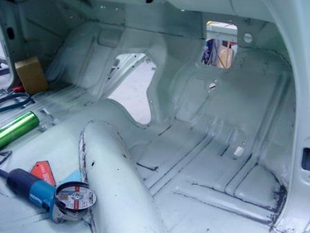

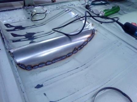

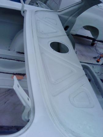

New parcel shelf is in and I'm pretty happy with it. Front floor sections are done, now onto the rear. Had to replace the rear driveshaft hump in the floor as it was a bit shitty.
Thats it for now, time for a froffy :thumbsup: :thumbsup: :thumbsup:
