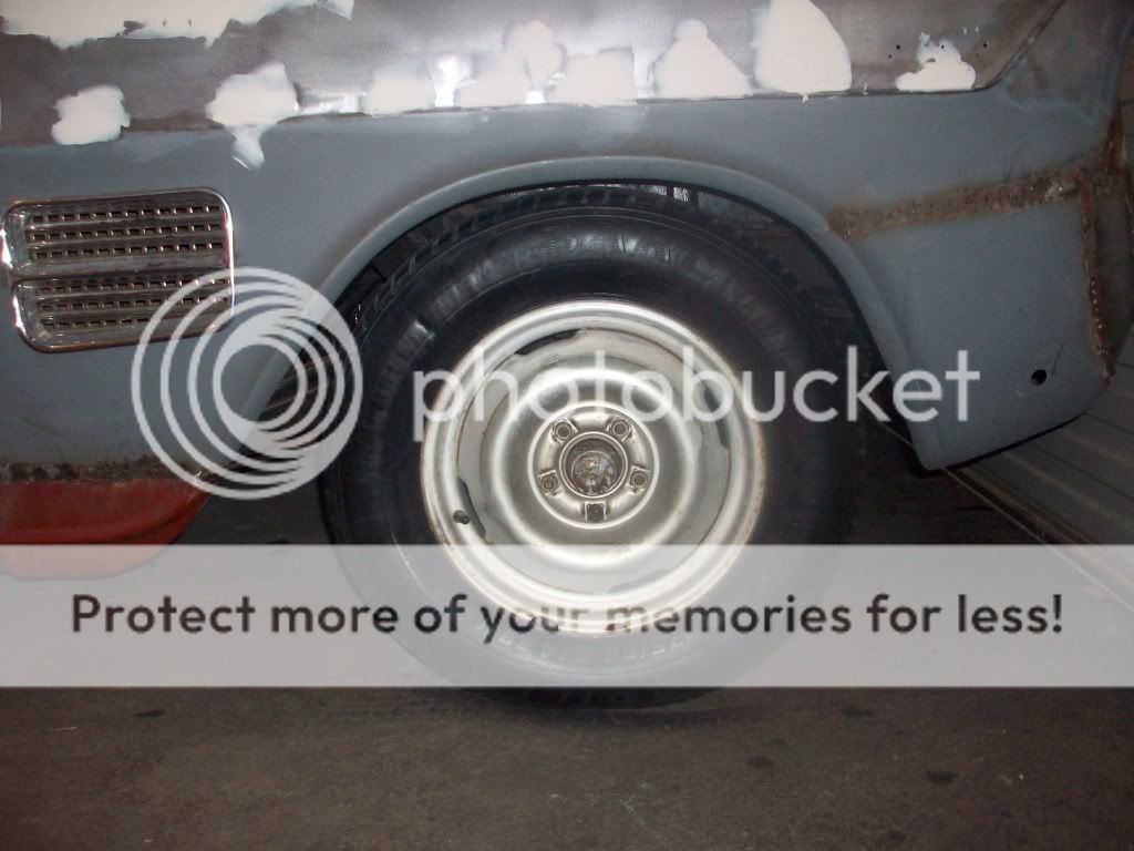

14 inch by 5 0n a ek
Post by Mick Jagger »
Got some 14s
5 inchs wide
They fit real nice,and now I can get Starburst(moon) hubcaps.
Yipee

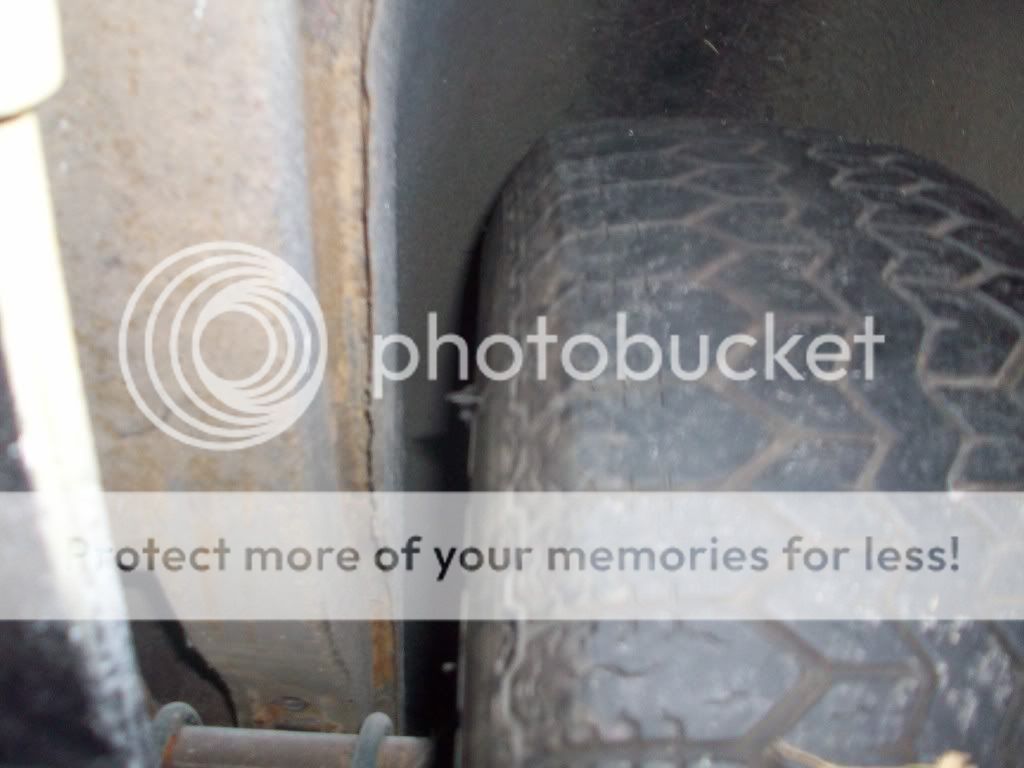

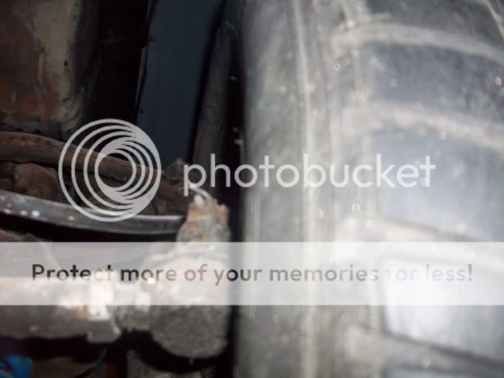

Images are Back wheel ,back wheel
Front wheel, front wheel

hope you got smooth roads :wink: 8)
you still have king pin front ? i've been told (never checked) that '53'54 chev stub axles go just about straight on and give a 2" drop may be worth sussing out

Geeze.. that tie-rod comes close to the tyre!! :shock:
