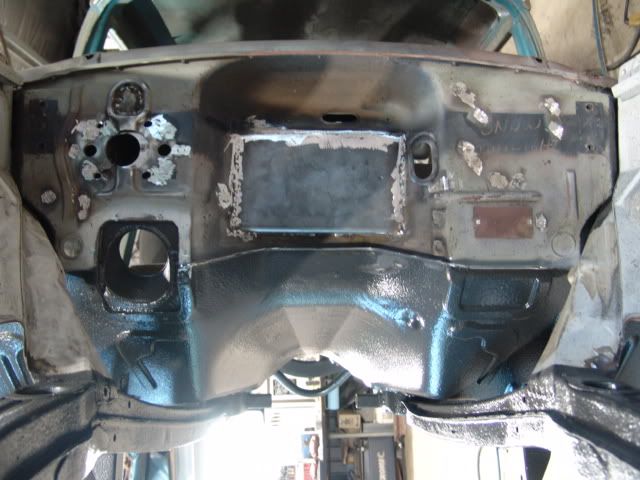

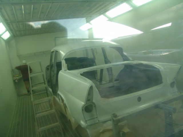

Body is going into paint this coming week, so have a few quick bits to finish off, Rick (the gun painter) is coming over Sunday to check it over (and probably add to the list :roll: ) before it is delivered to him to wave his magic over it. Guards, doors, boot, bonnet, scuttle panel etc... are with Rick already and basically ready for topcoat.

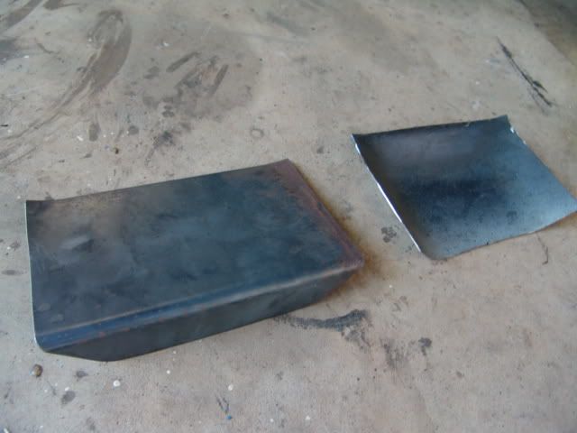

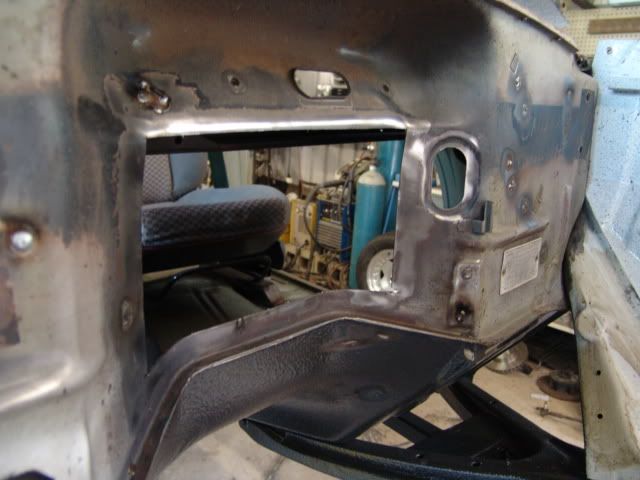

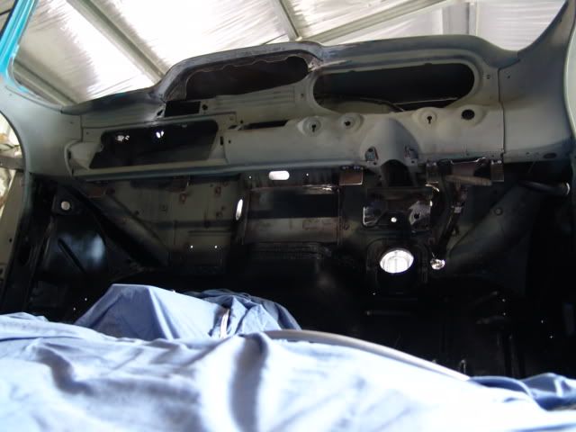

I cut out the section for the Ducted A/C unit, used a different one to Mal so I could retain the original wiper motor under the bonnet (just something I wanted to do :roll: ).
Old and new sections:
Also welded up all the holes I don't need:
The 2 pack has been applied underneath, I went with a Charcoal/Gunmetal Grey colour, hoping this will contrast well with the Gloss black Torana frontend, tailshaft, trans mount etc.... Looks a lot darker in this pic :roll:

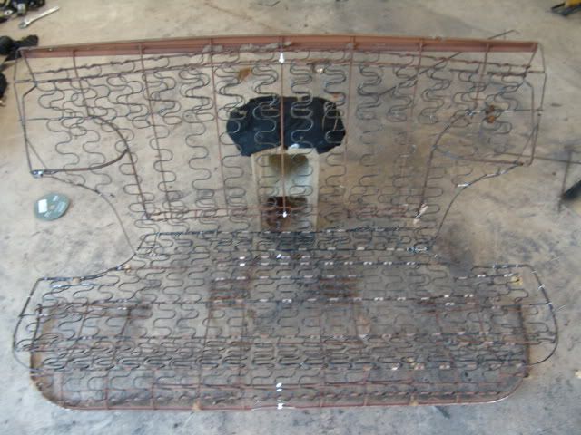

I have finished the rear seat mods prior to upholstery (to get around the tubs):

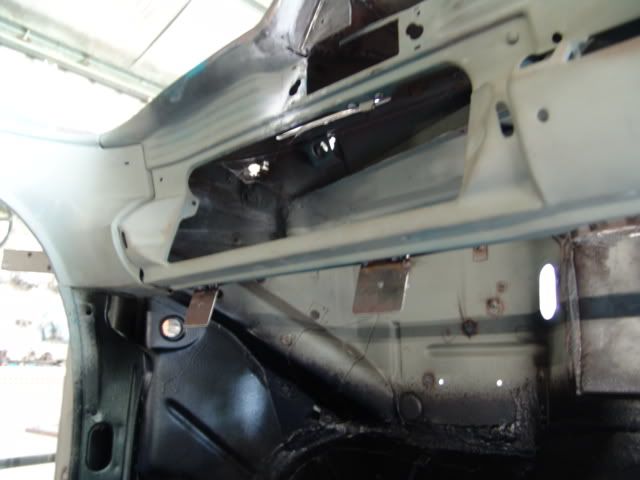

Ducted A/C facia mounting plates done:

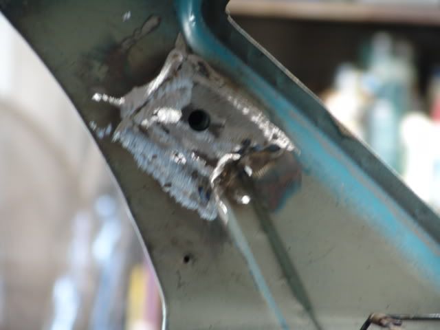

Seat belt mounts finished - this is the top mount for the rear, recoil is snuggled under the modified rear seat back rest:

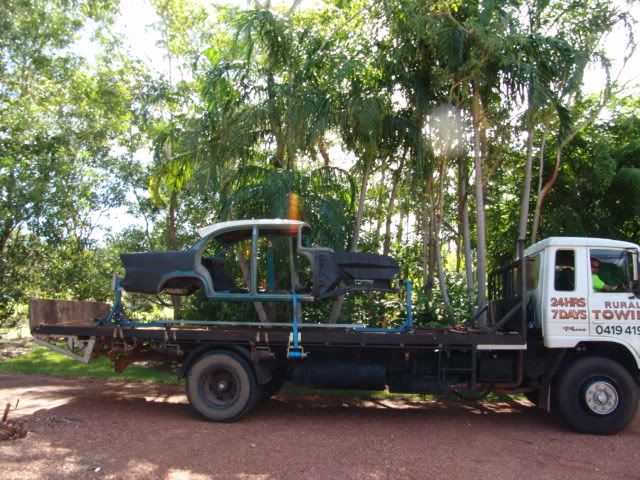

Went back in the shed and the EK's GONE!!WTF!!!! :shock: :shock: :shock:
Still looking for this truck........................

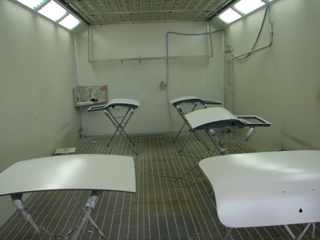

Doors, bonnet & boot primed, one more rub down and prime then the topcoat goes on.............. :D

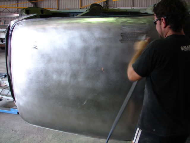

Roof back to bare metal, GO RICK!!:

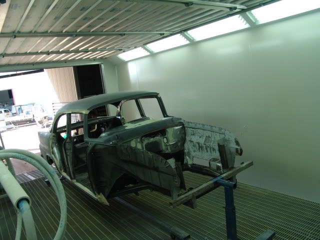

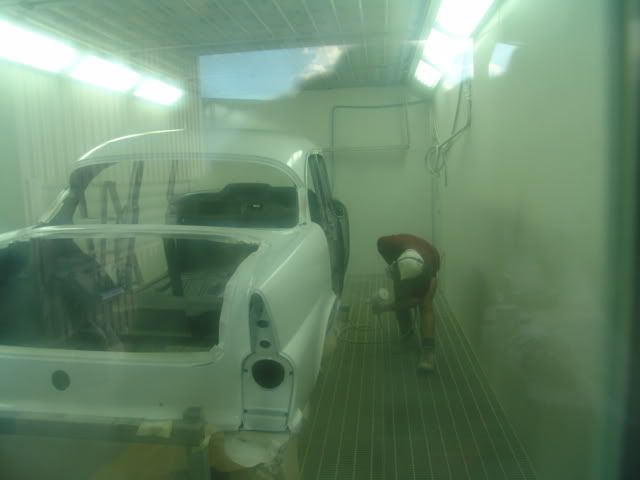

Paint progress ................ This is after body repairs, smoothing fire wall but still retaining "original" pressings, sanding, more sanding, then applying De-oxidante by brush and removing with metho, applying etch and light rub back a 2-pack epoxy primer over, will be double baked then blocked back and have next primer stage with guide coat, blocked again ...... if all good then Colour next week!!
