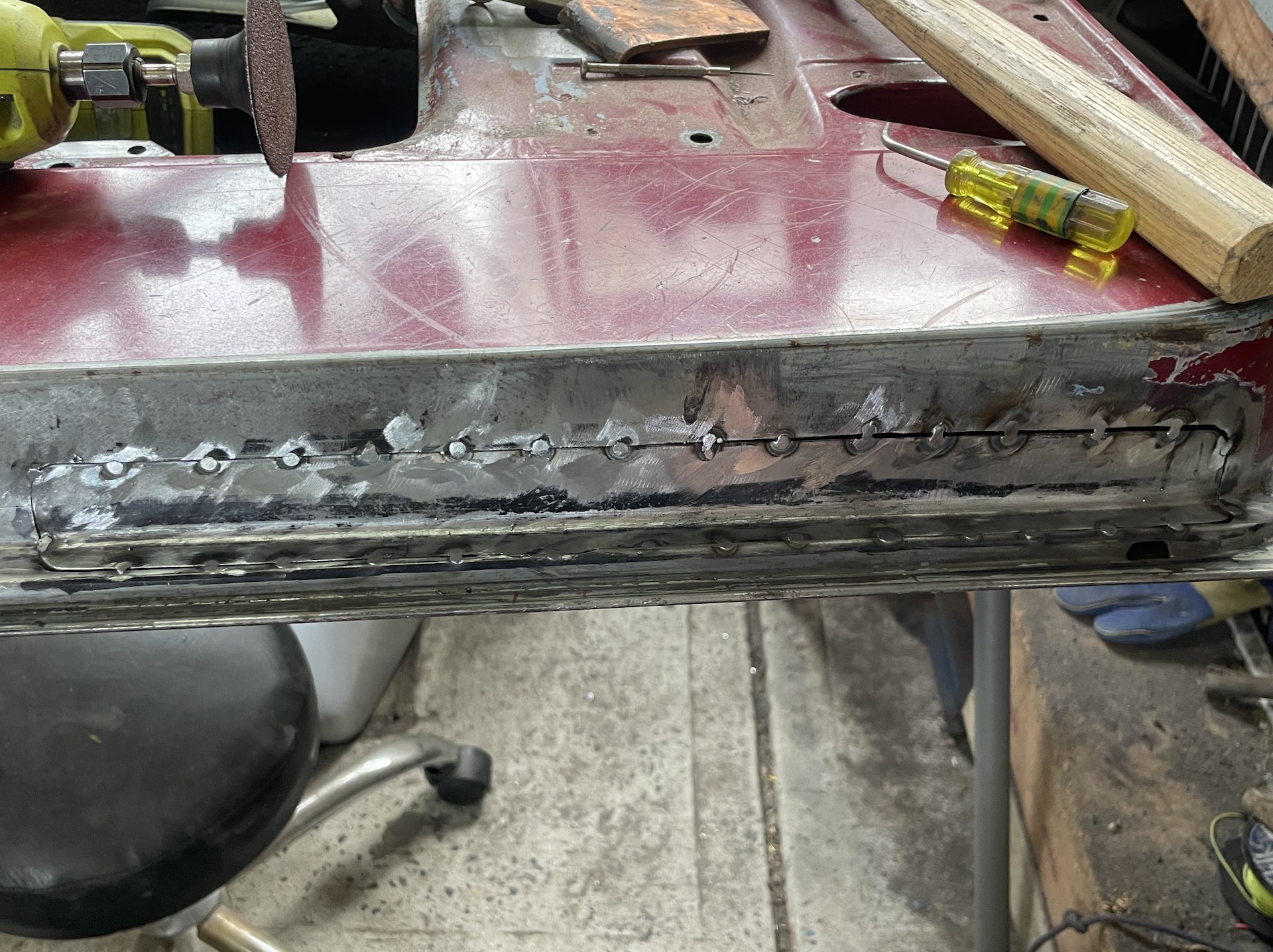

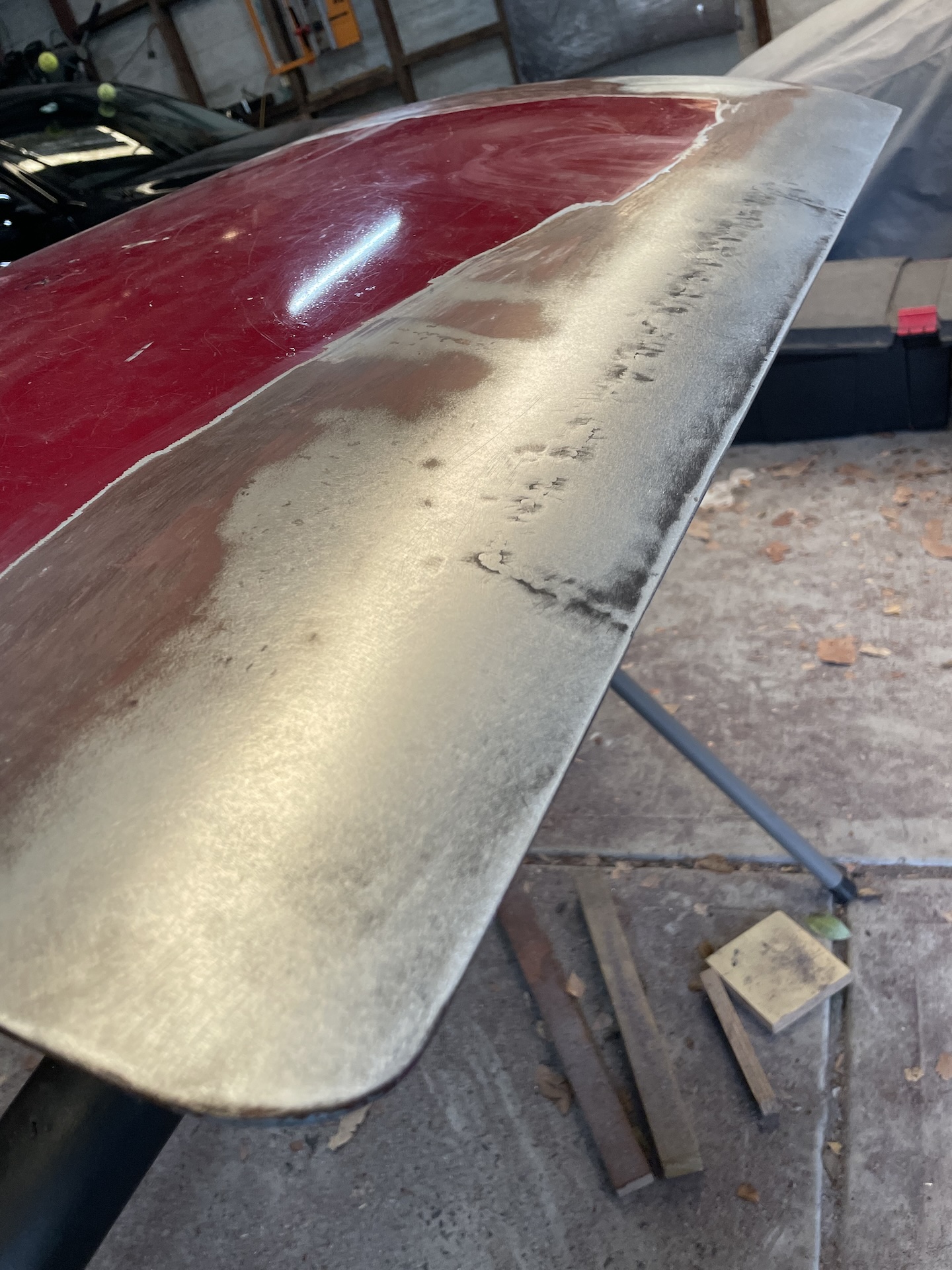

So after a month off I'm back into the car. Over stainless trim polishing so thought I'd tackle a door or two.

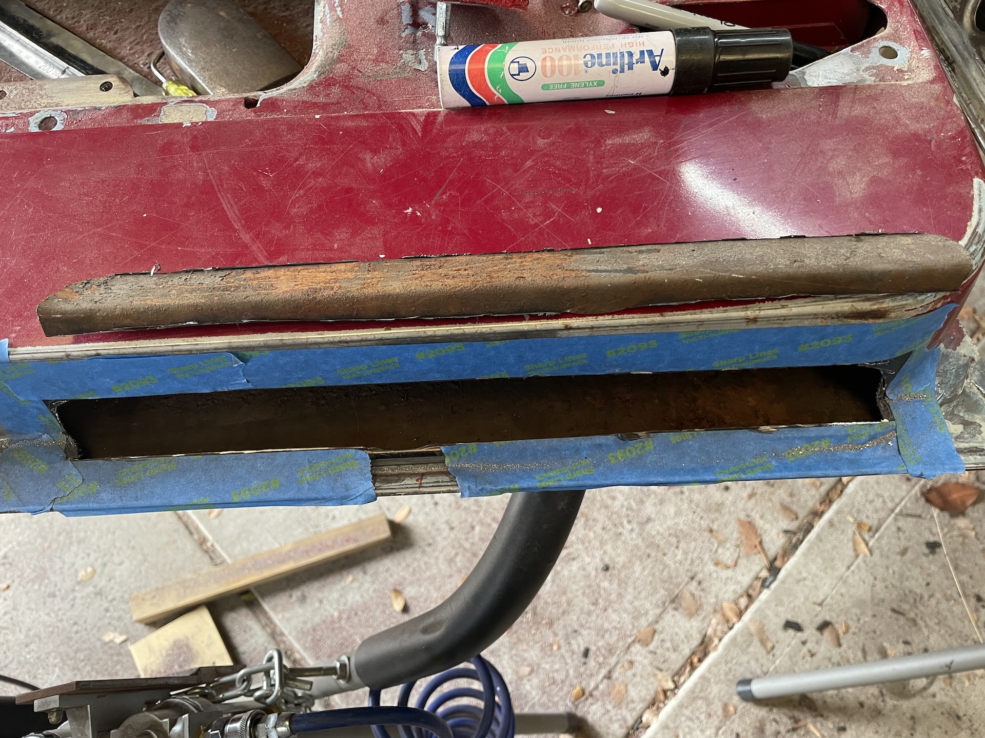

Front passenger door has rust in the bottom of the door inner. So made up a replacement and prepped for surgery.
Ugh - should have got my inspection camera out . Nothing to see from the inside. Only rusted on the outer surface.
Oh well come this far. Gapping of new piece was not great on the right but MIG bridged the gap.
Done
Down the other end I took to the few spots of rust with the die grinder.
Filled with MIG
Done

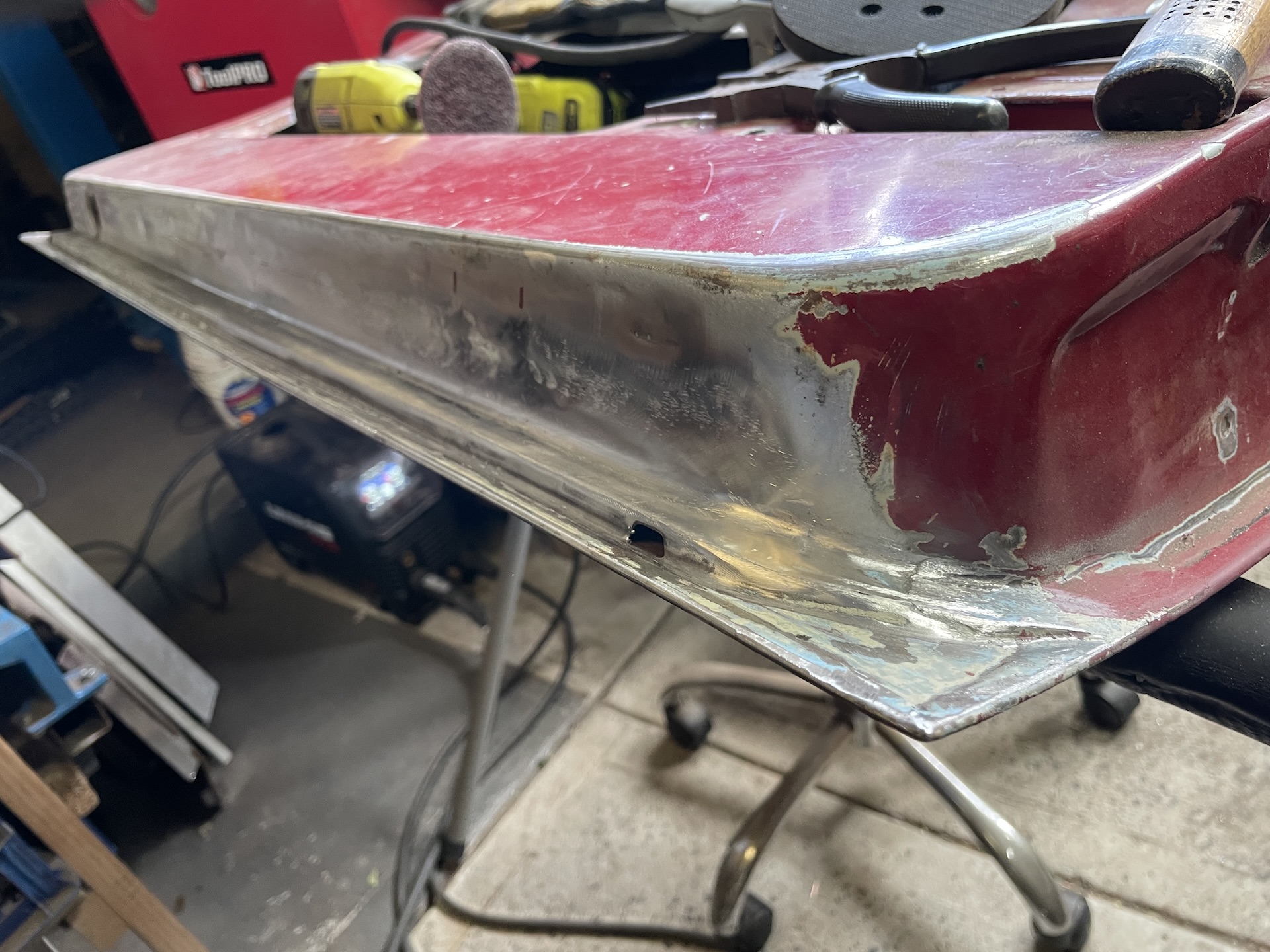

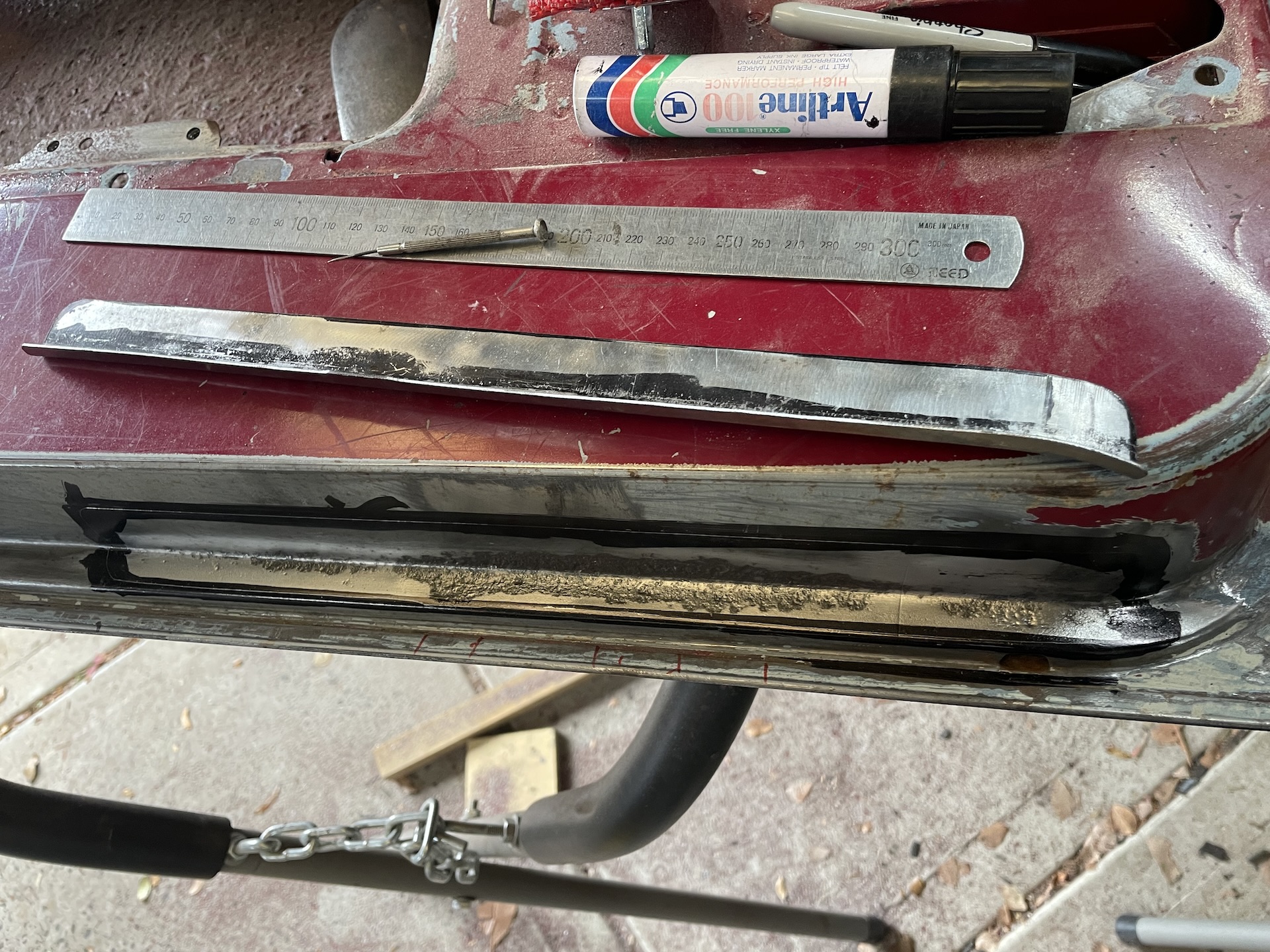

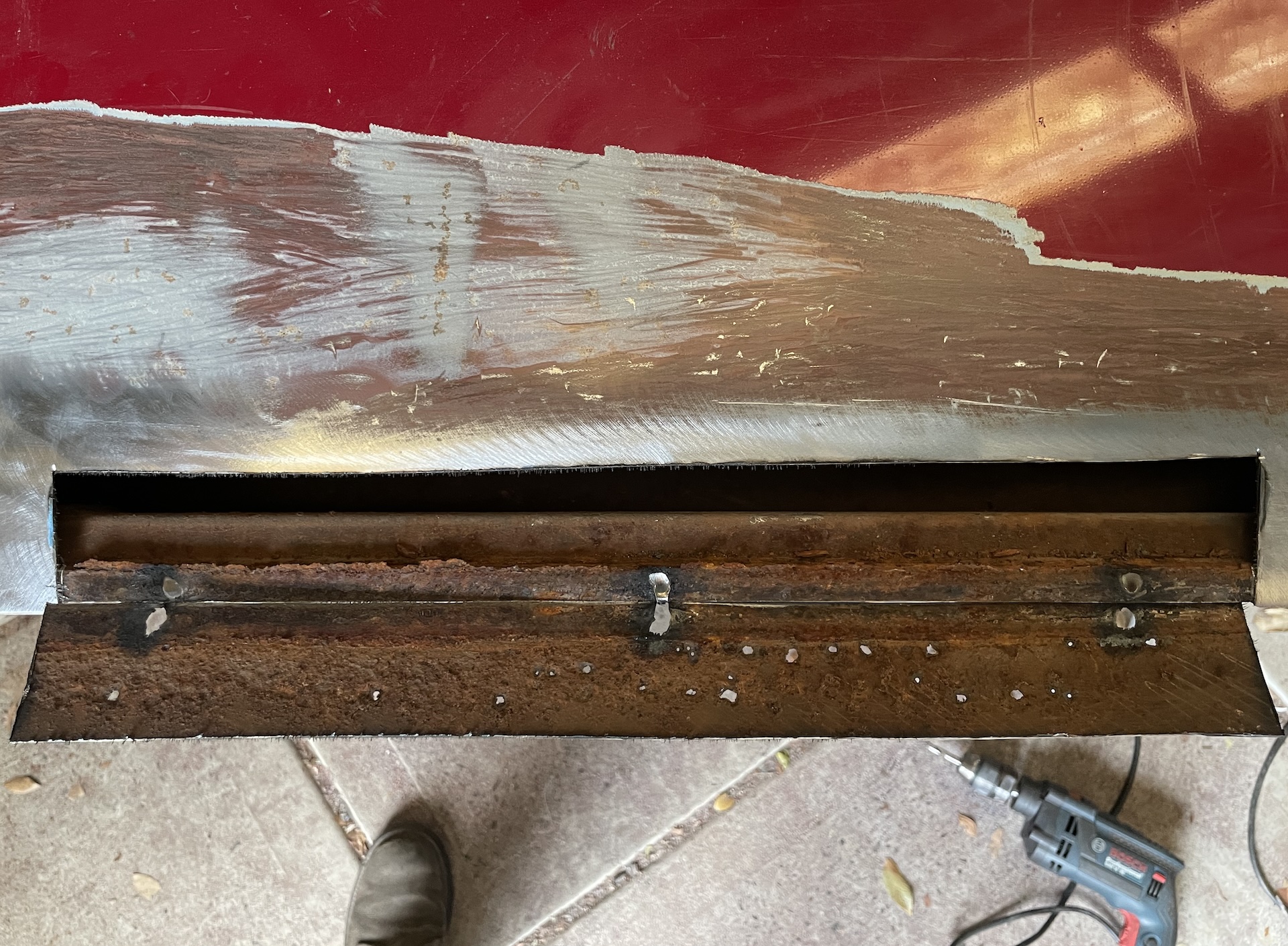

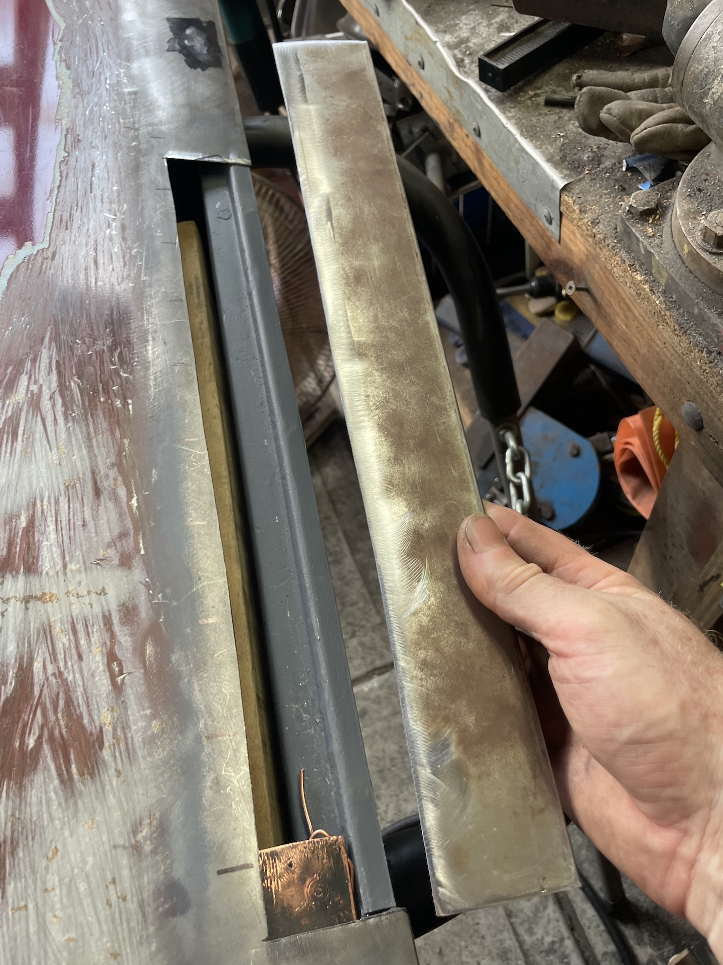

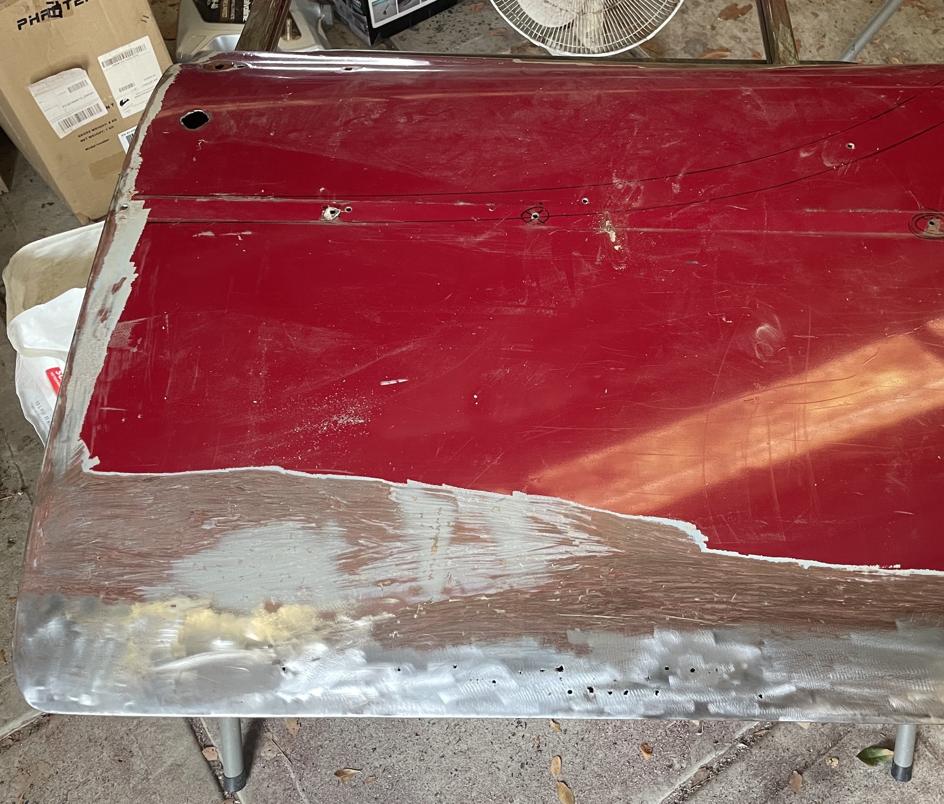

Front drivers door outer skin has a few holes at the bottom. This time I had a look inside and yes it is rotting from the inside out.
So cut around the rot and ground the bottom lip off.

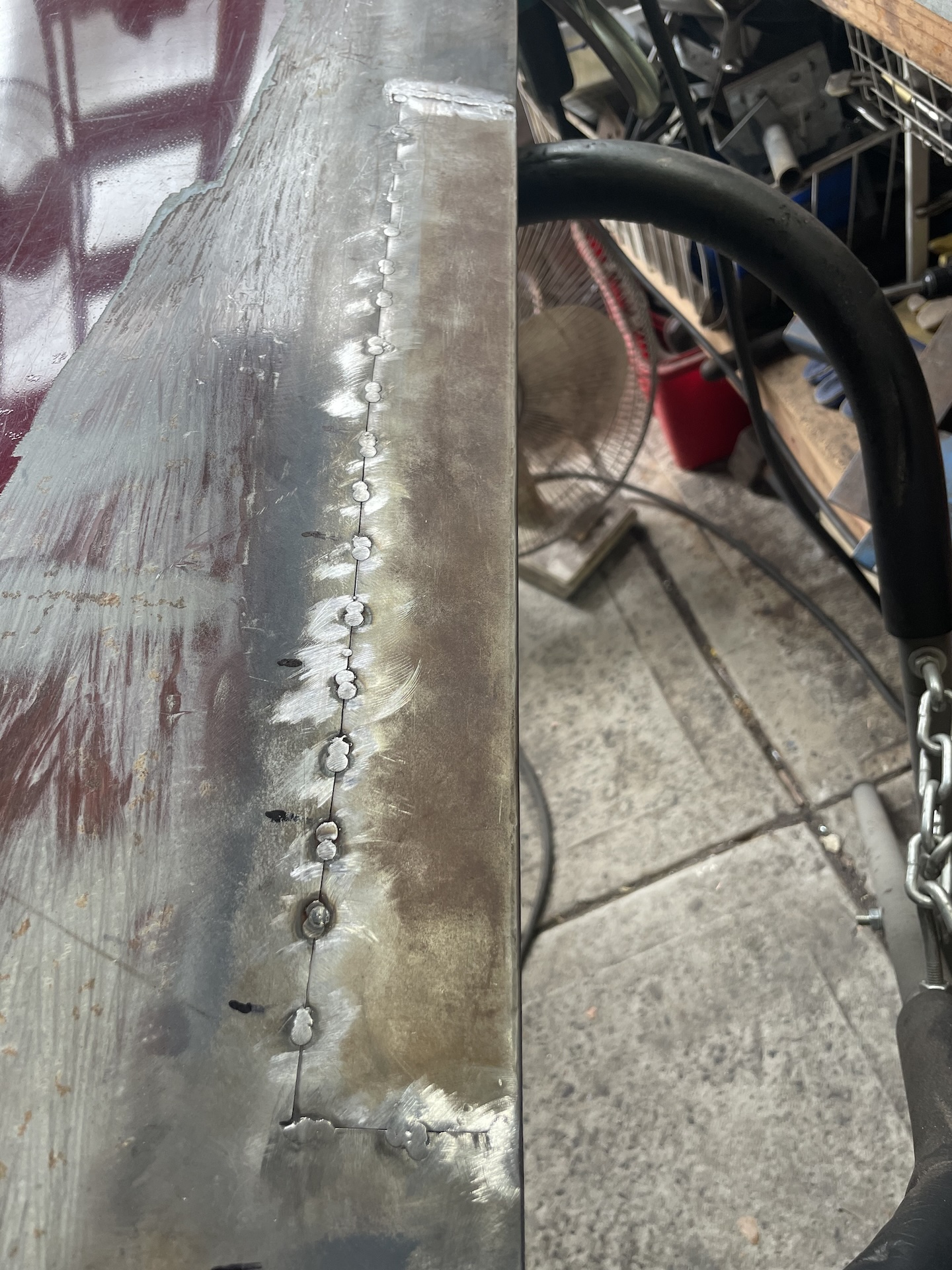

Grind down the spot welds and peel back
Clean up

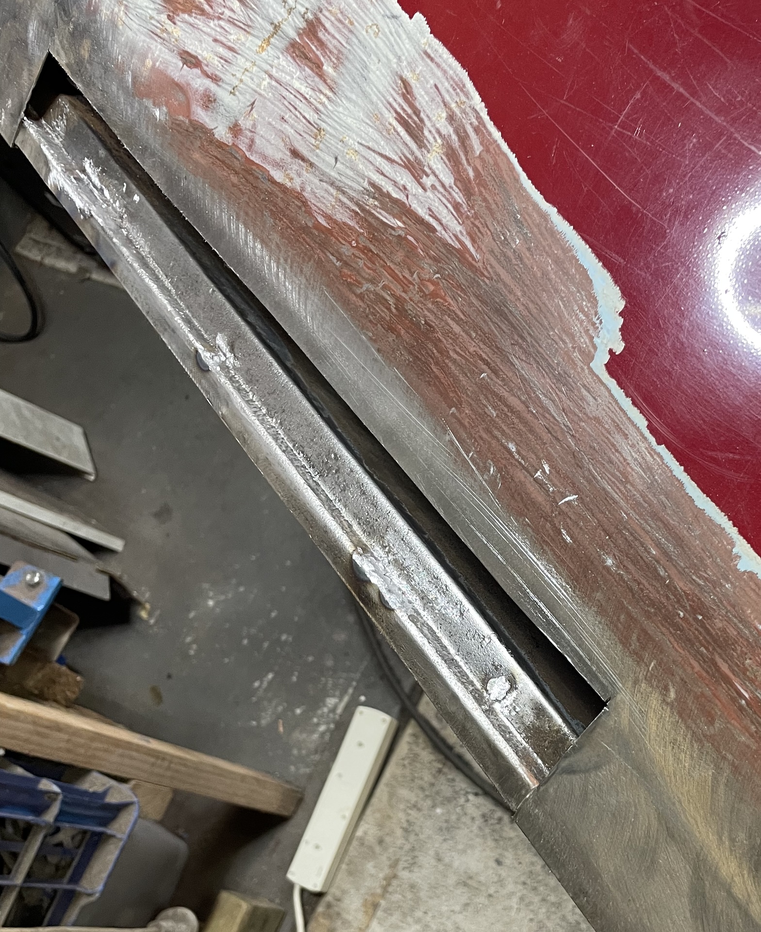

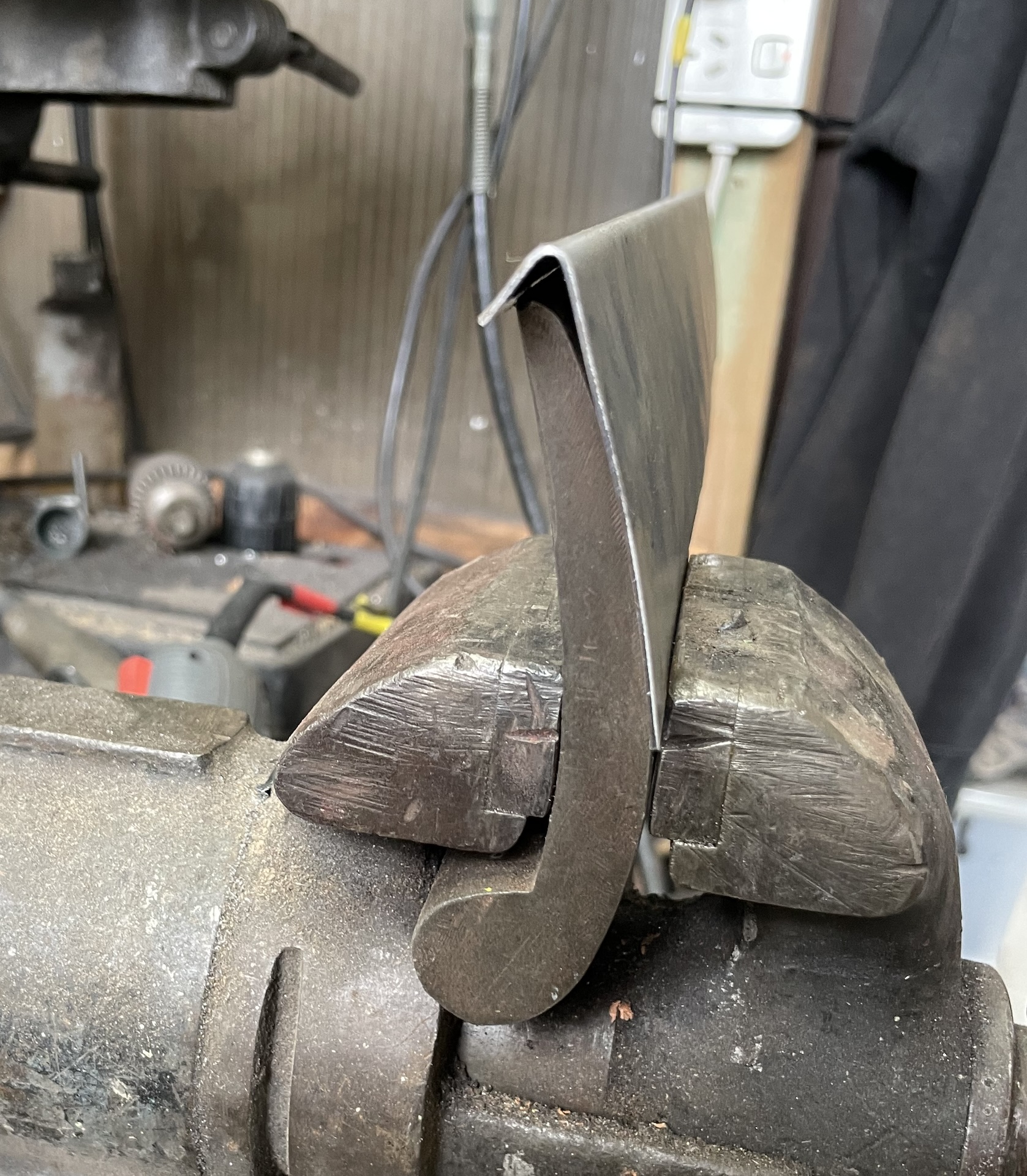

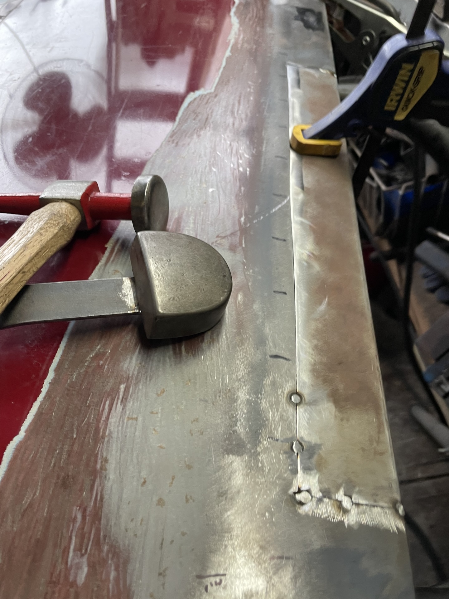

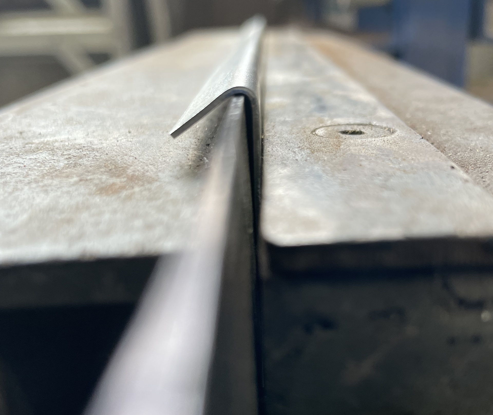

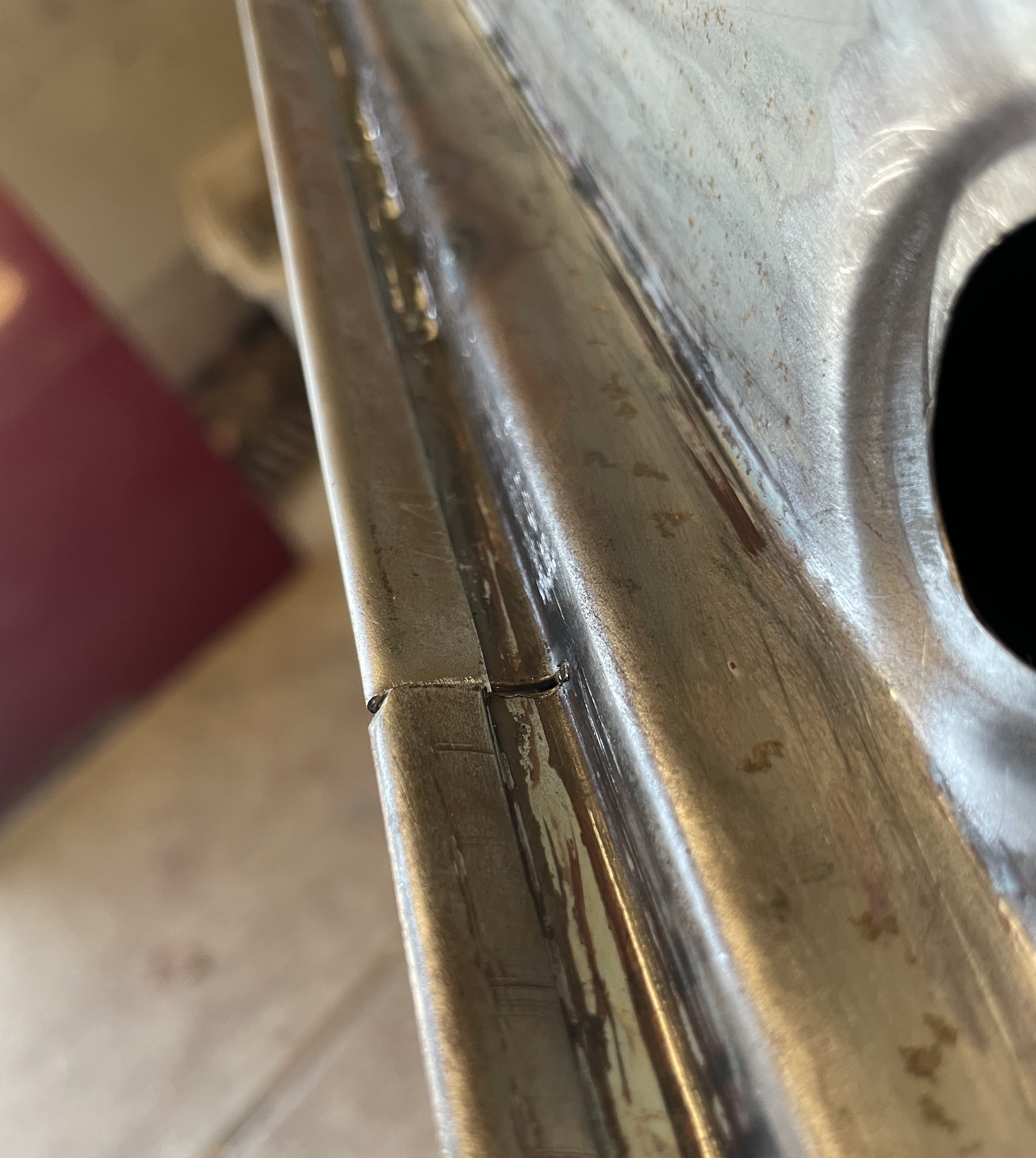

Start patch making. Tip an edge to 90 then used a steel ruler to fold over.
Find a dolly that matches the curve and bend metal by hand.

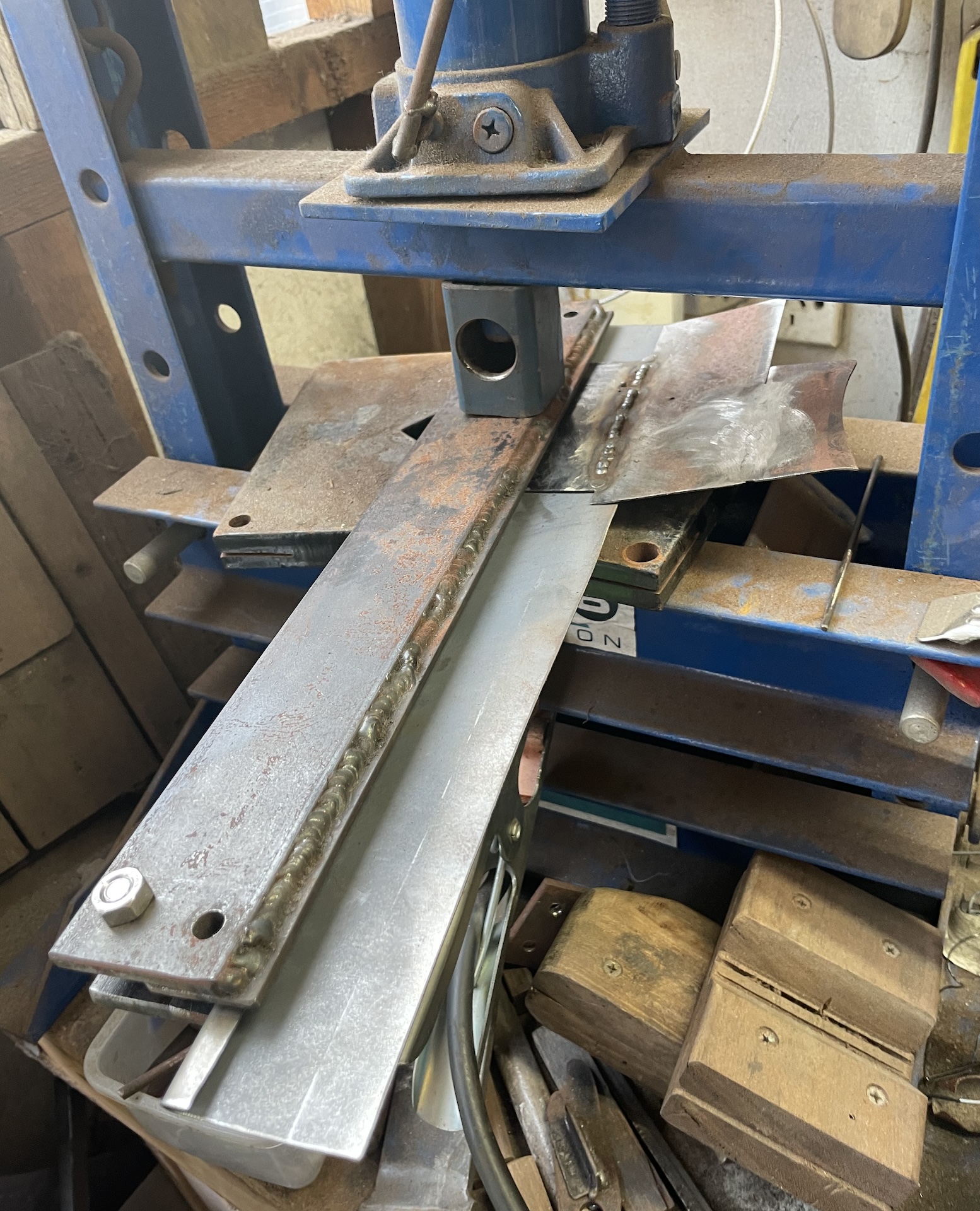

Test fit and when happy complete fold of skin bottom using press and scrap sheet metal as a spacer.
Tap on to inner frame for a snug test fit.
Scott

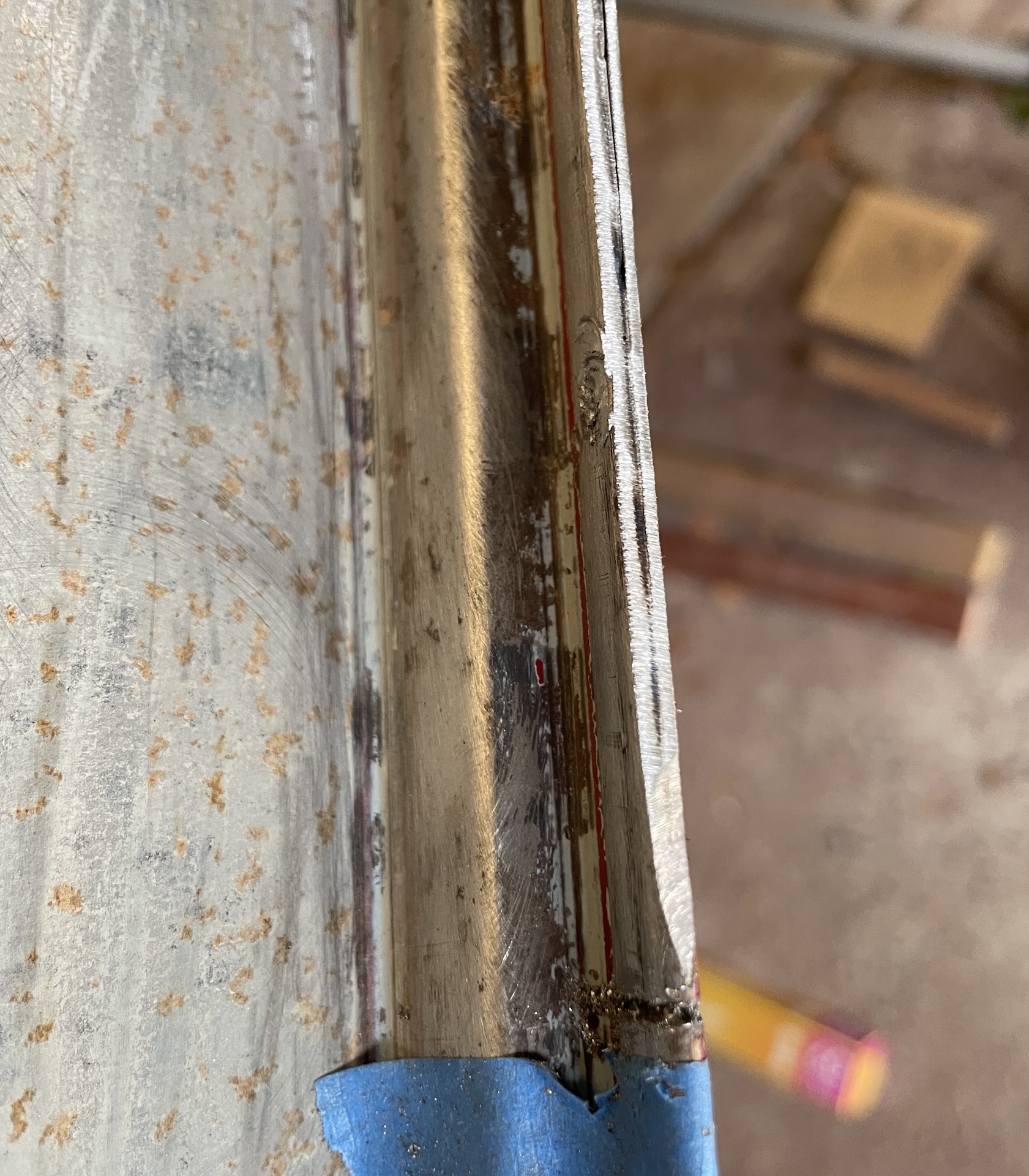

funkyscooter
Posts: 724
Re: Ol' Rusty - FB/EK Sedan
Post by funkyscooter »

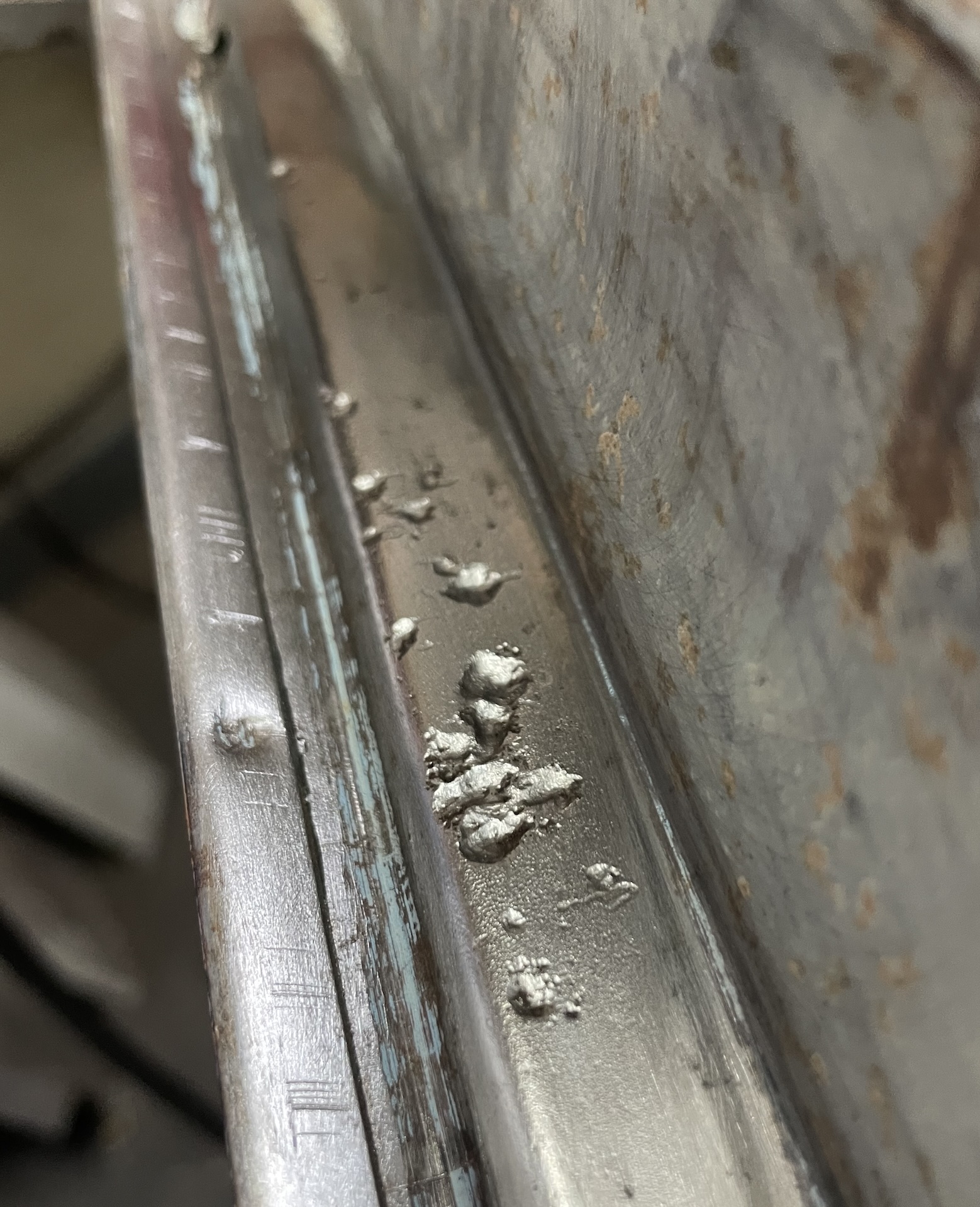

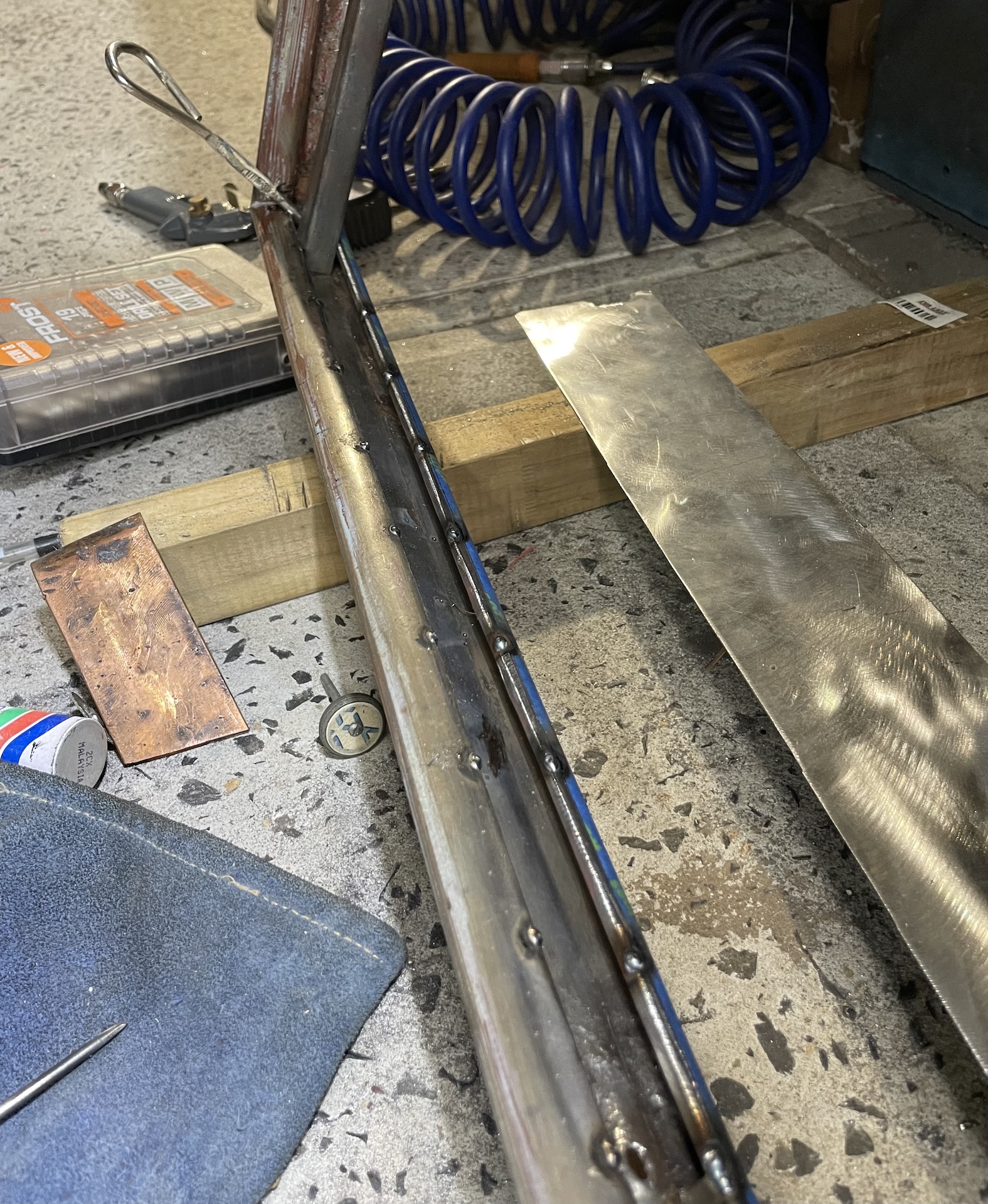

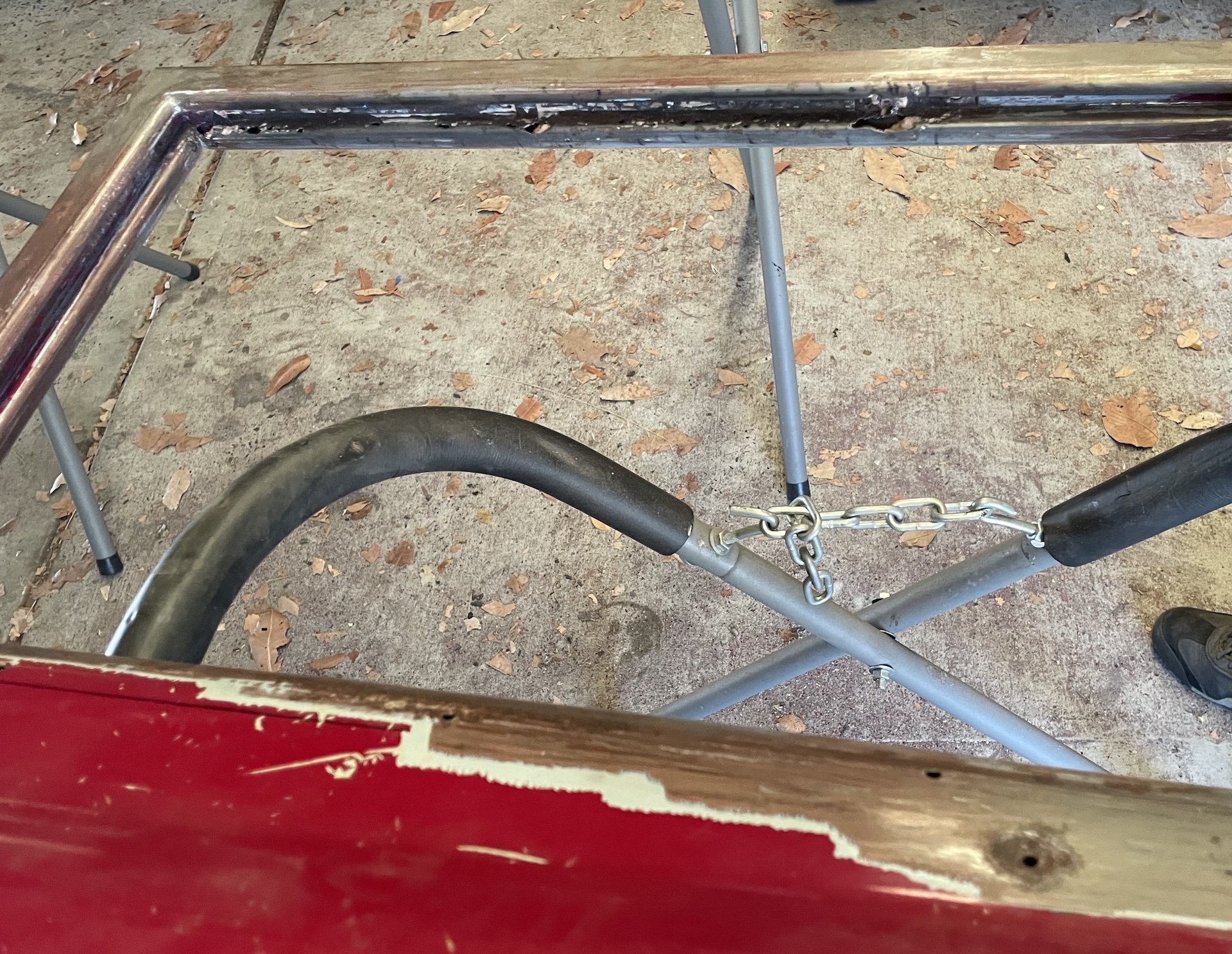

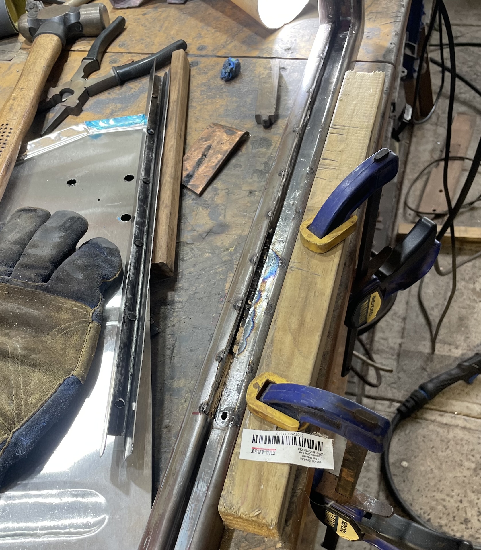

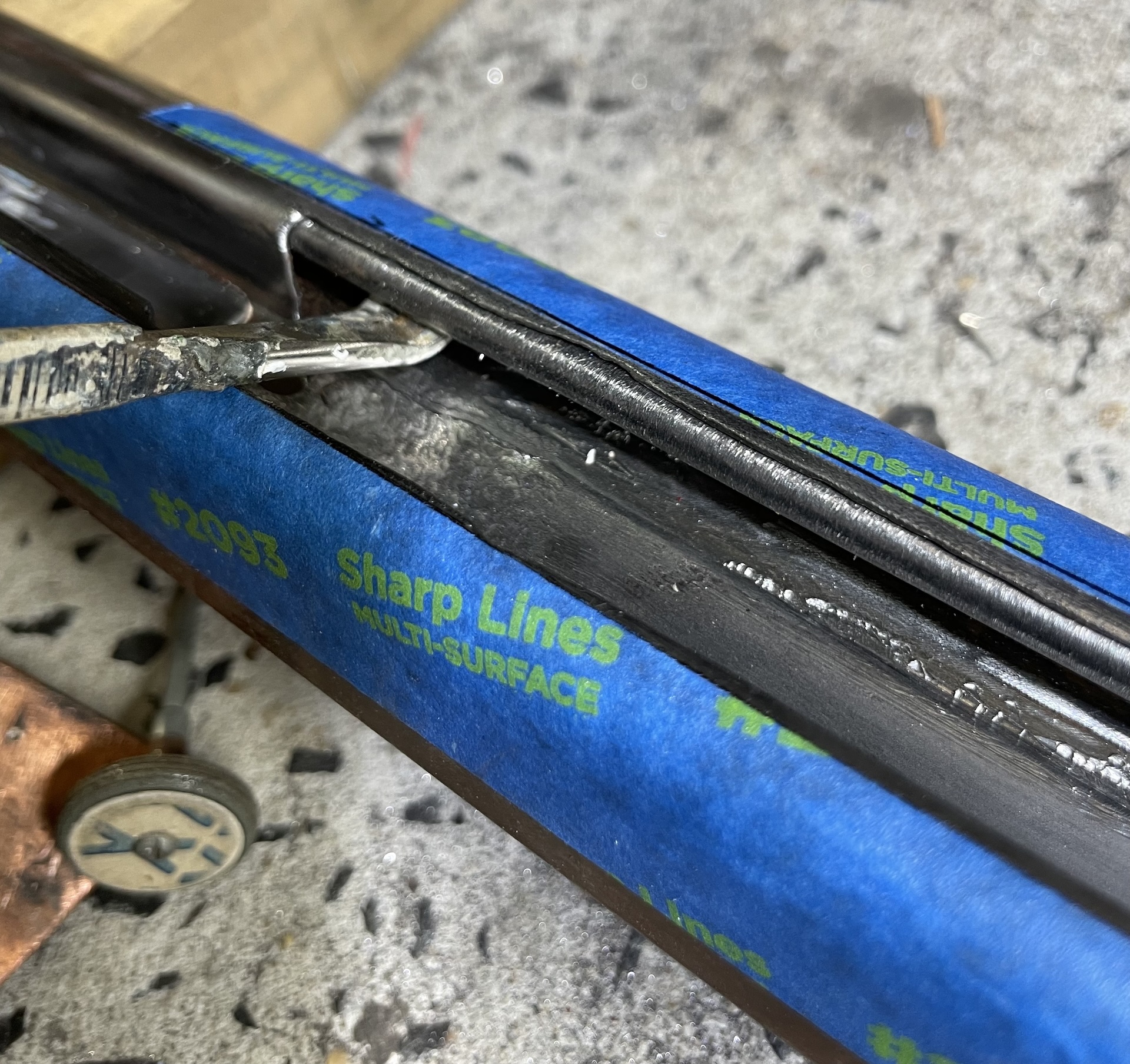

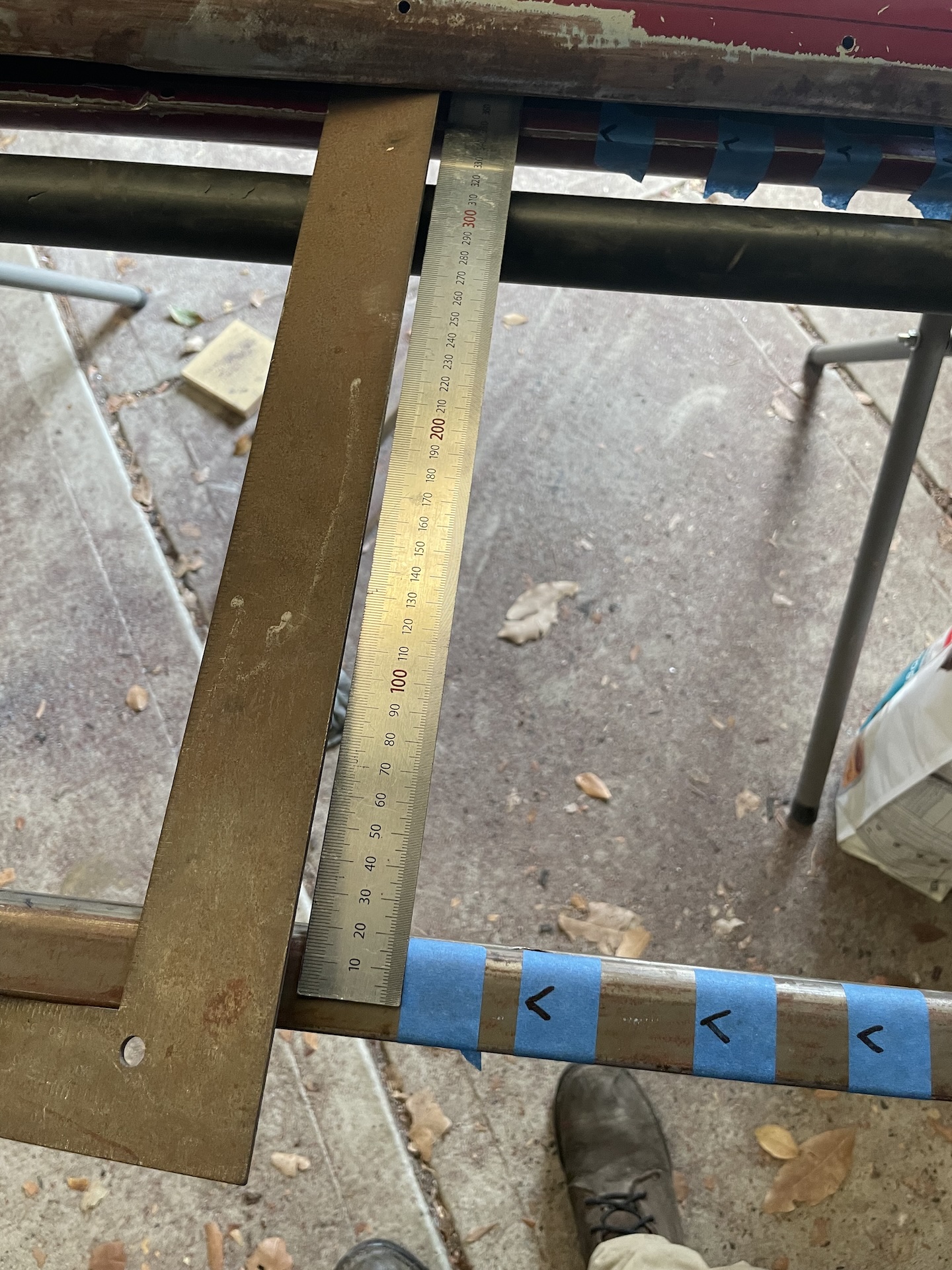

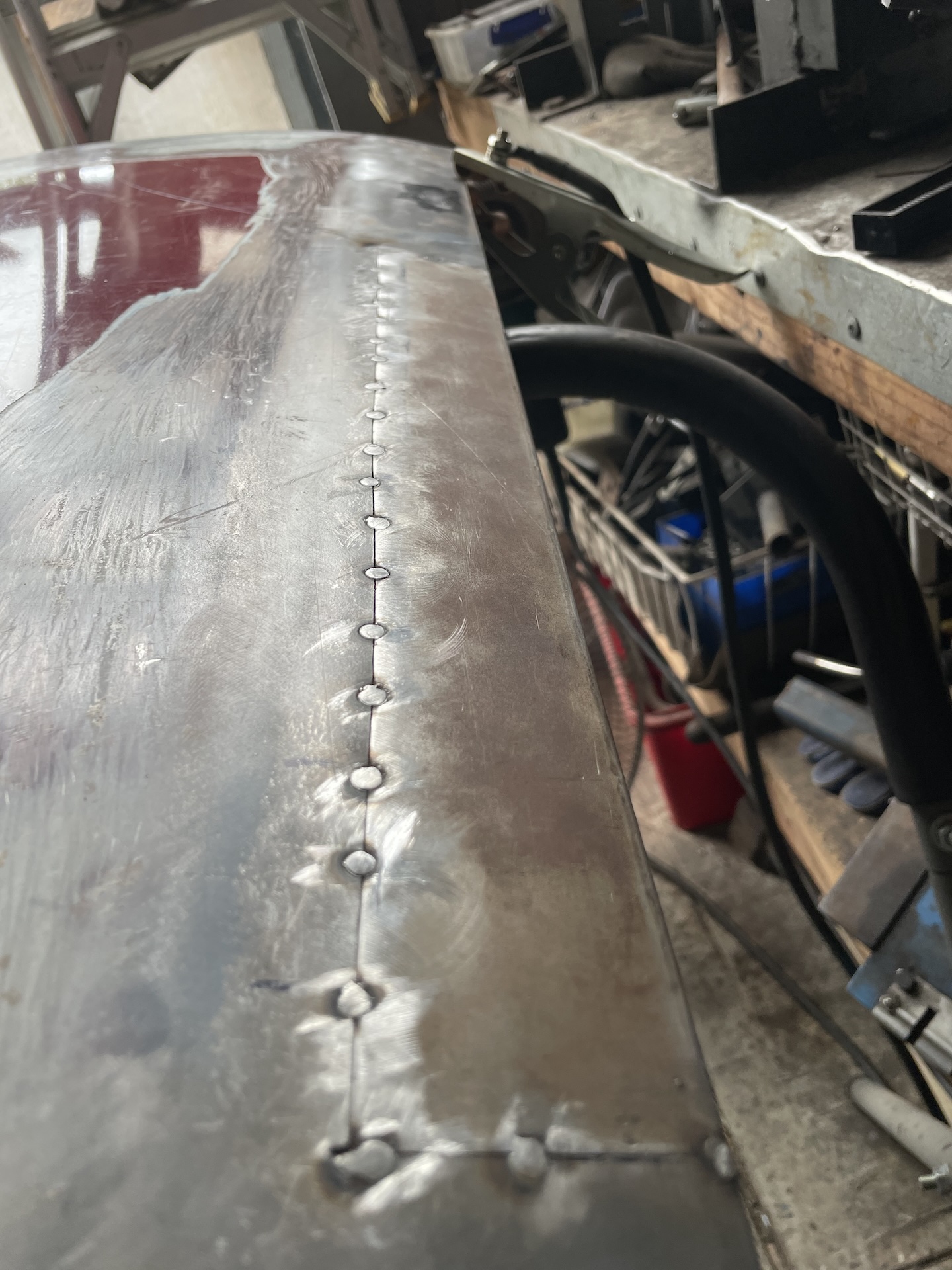

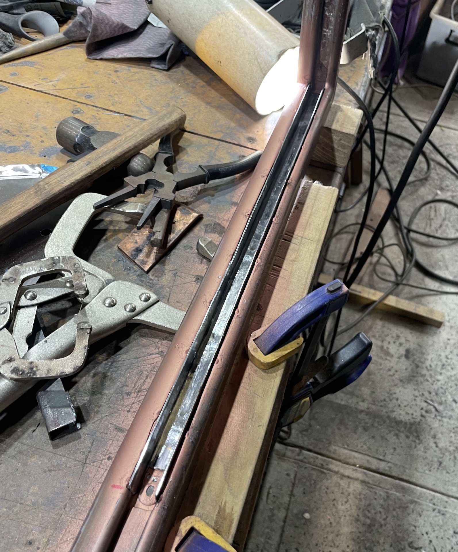

Took a bit of time plotting and planning how I was going to accurately back the weld with copper. Used a square and a ruler to mark the top of frame and top of the door, then used the ruler to help position the copper which was wedged in and held by a dolly welded to a bit of metal bar. Simple.
Ready
Tack, cool, grind, dolly, move copper, repeat.
And repeat
And repeat
More hammer dolly, and then a bit of shrinking disk.
Done
Scott

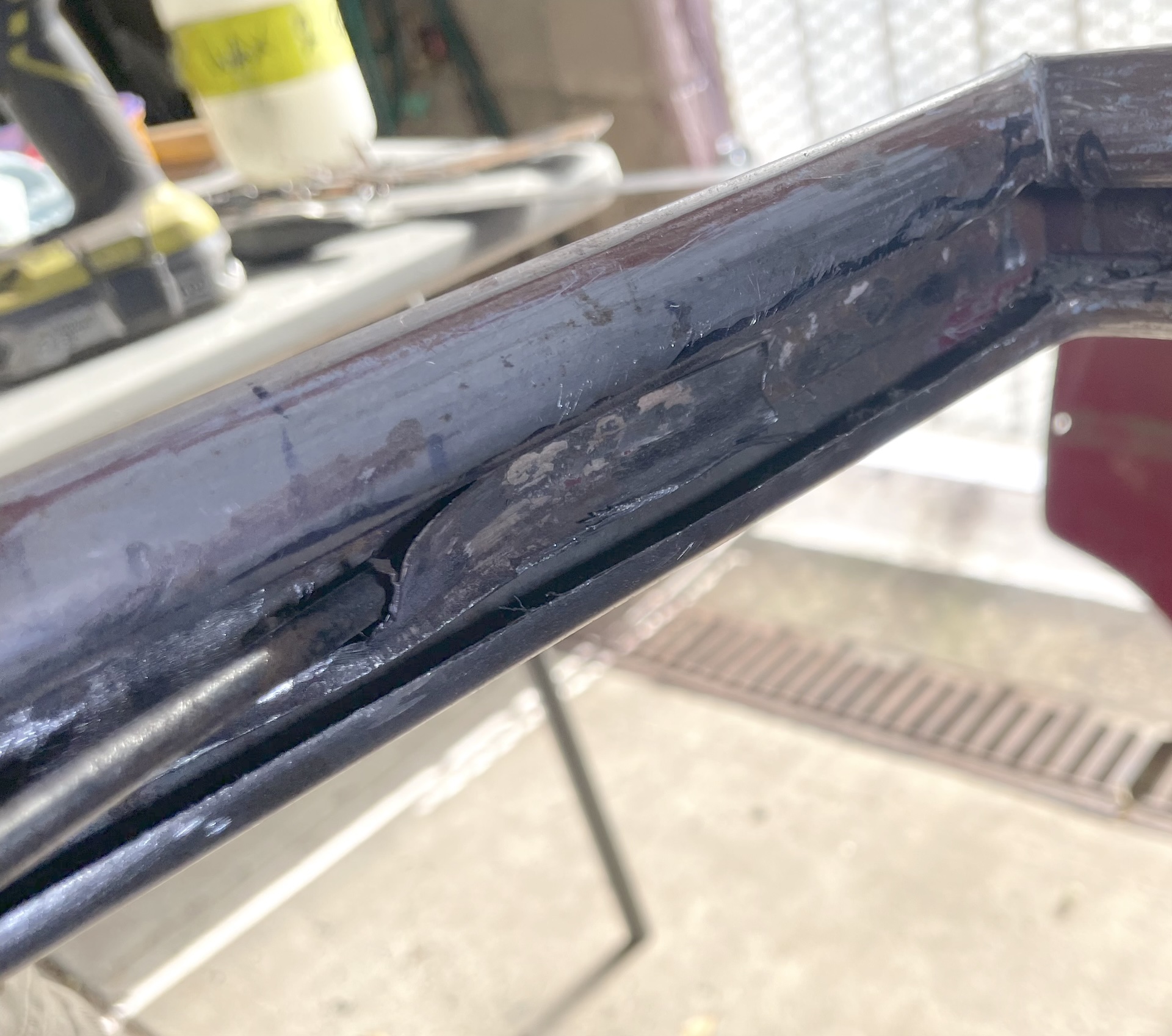

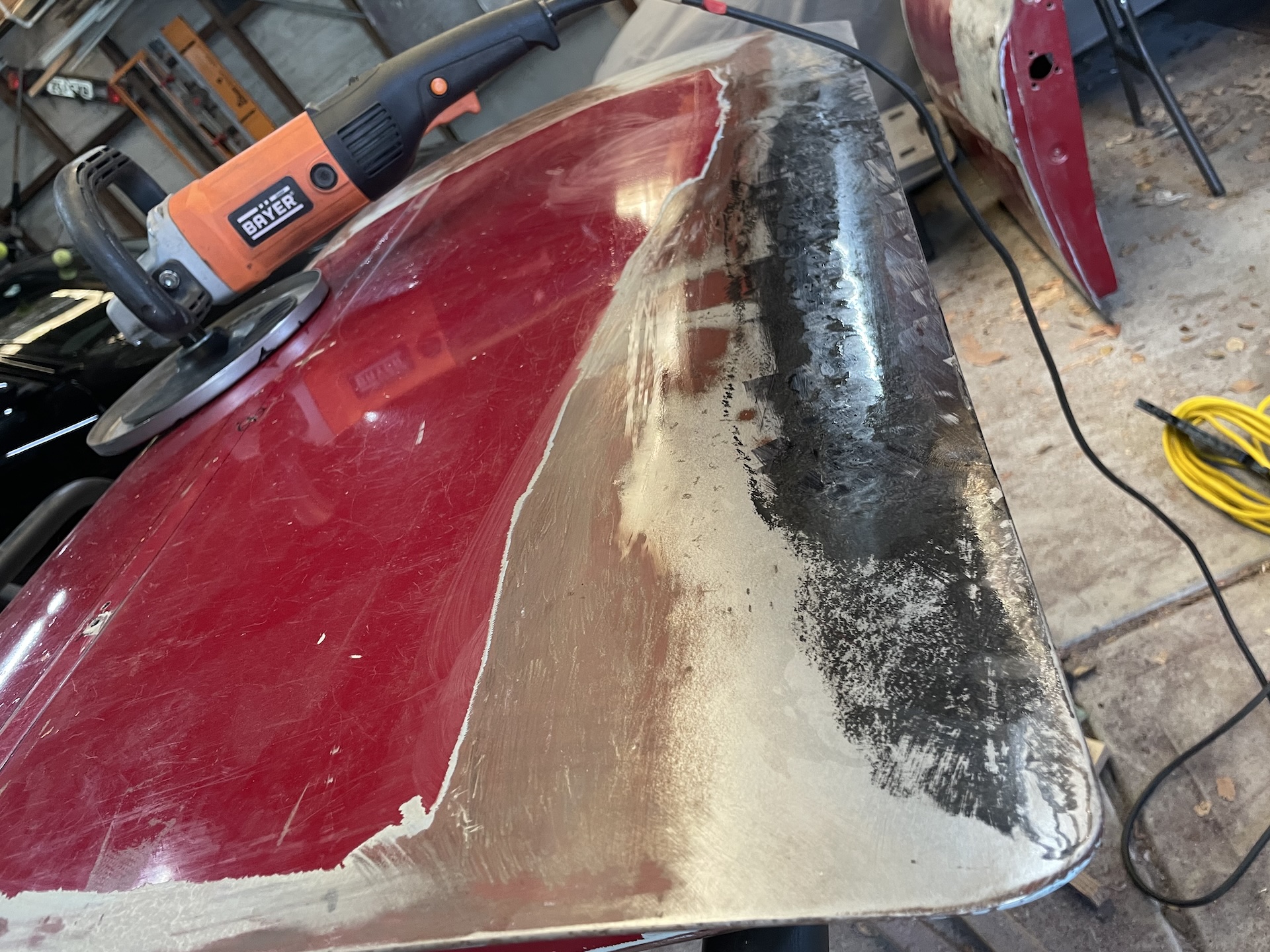

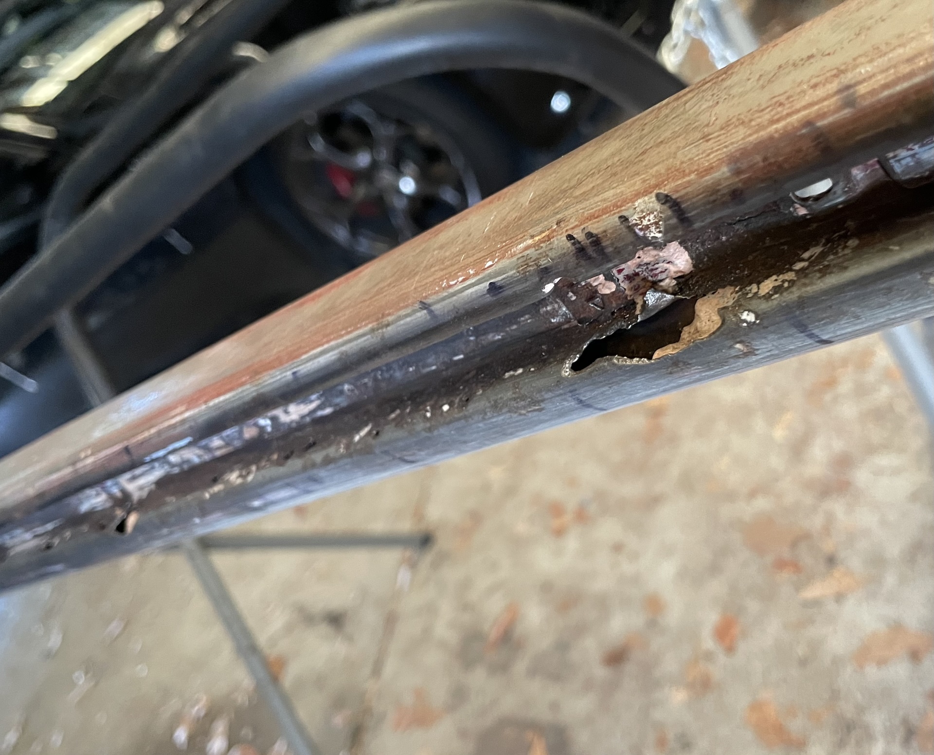

Are we there yet - no! Discovered a world of bog from a previous repair on the top of the door frame. The inner channel is toast on both sides.
If in doubt, cut it out.
Prise the bottom of the channel off its spot welds which let go with a little effort.
Looking in (it's a bit hard to see as the inner curve of the door frame looks the same as the inner) the internal metal is rust free. Must have rotted from the outside in.

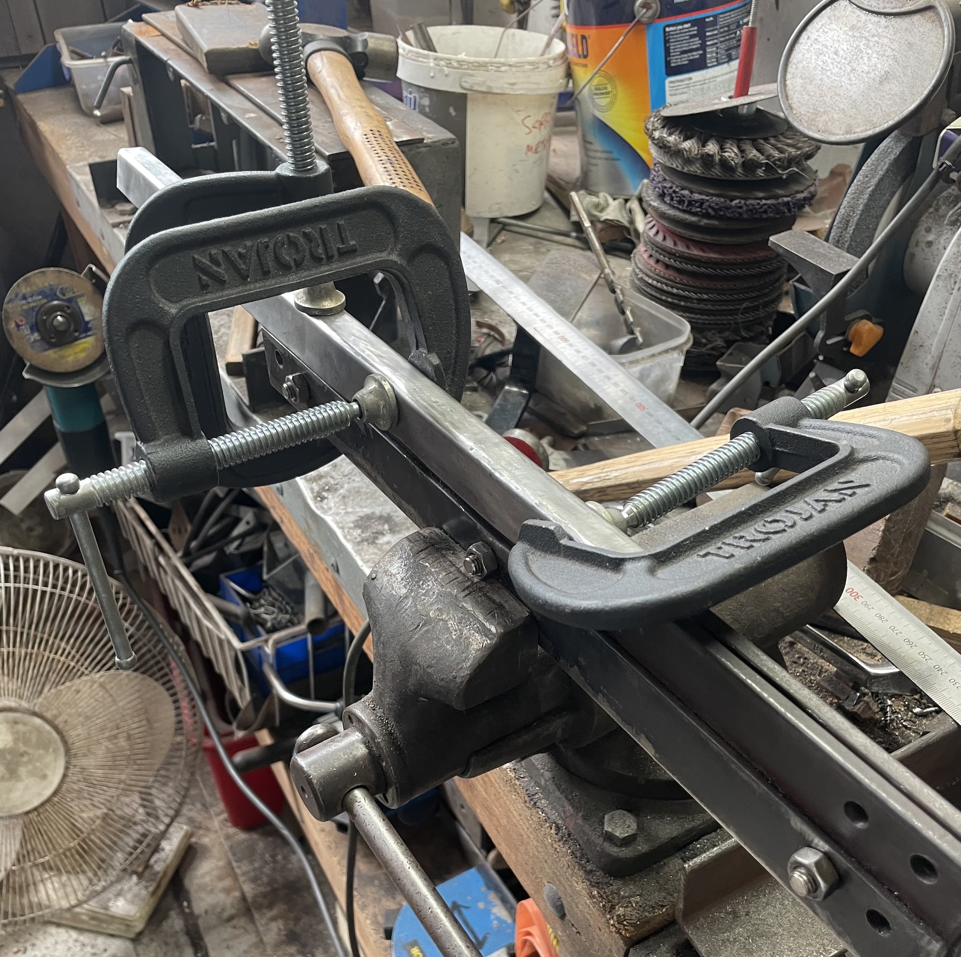

Found some steel rod which I matched the radius of the curve of the channel with a bit of sanding. Used this to add a bit of meat around the weld to avoid blow throughs.
Tacked rod in on both sides.
Scott

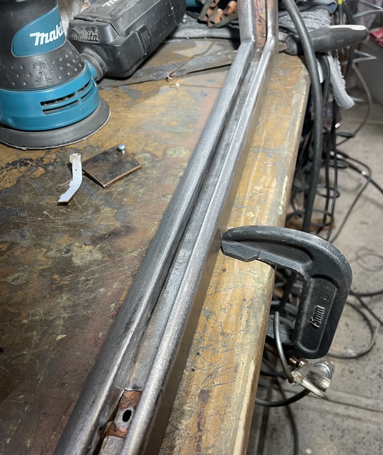

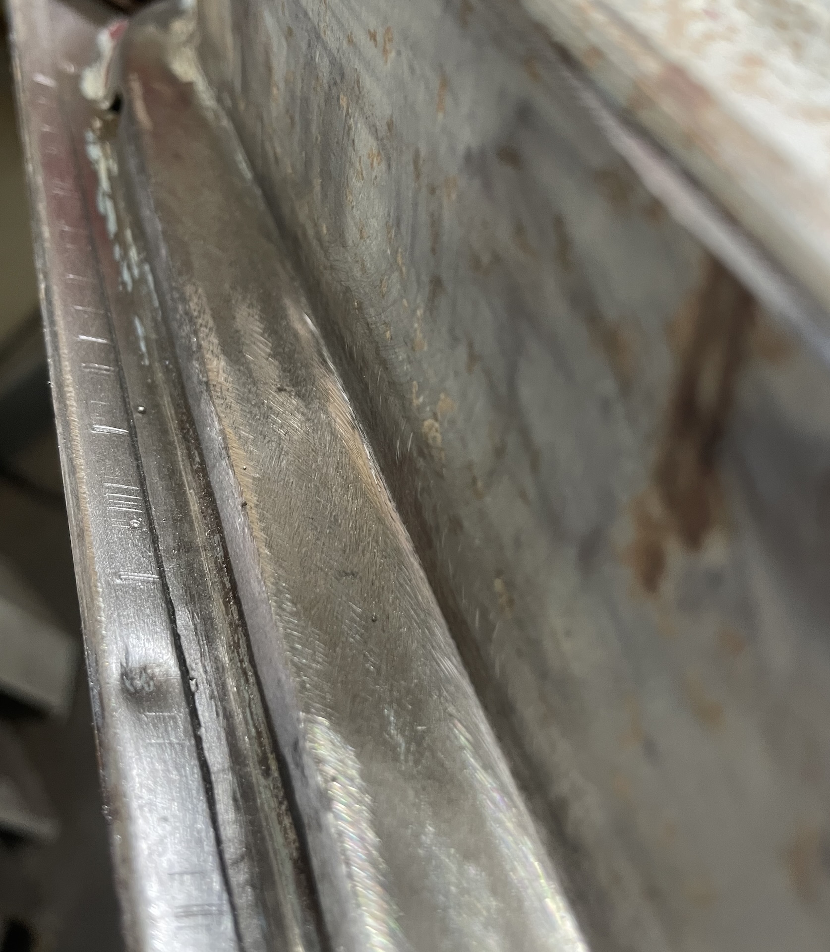

funkyscooter
Posts: 724

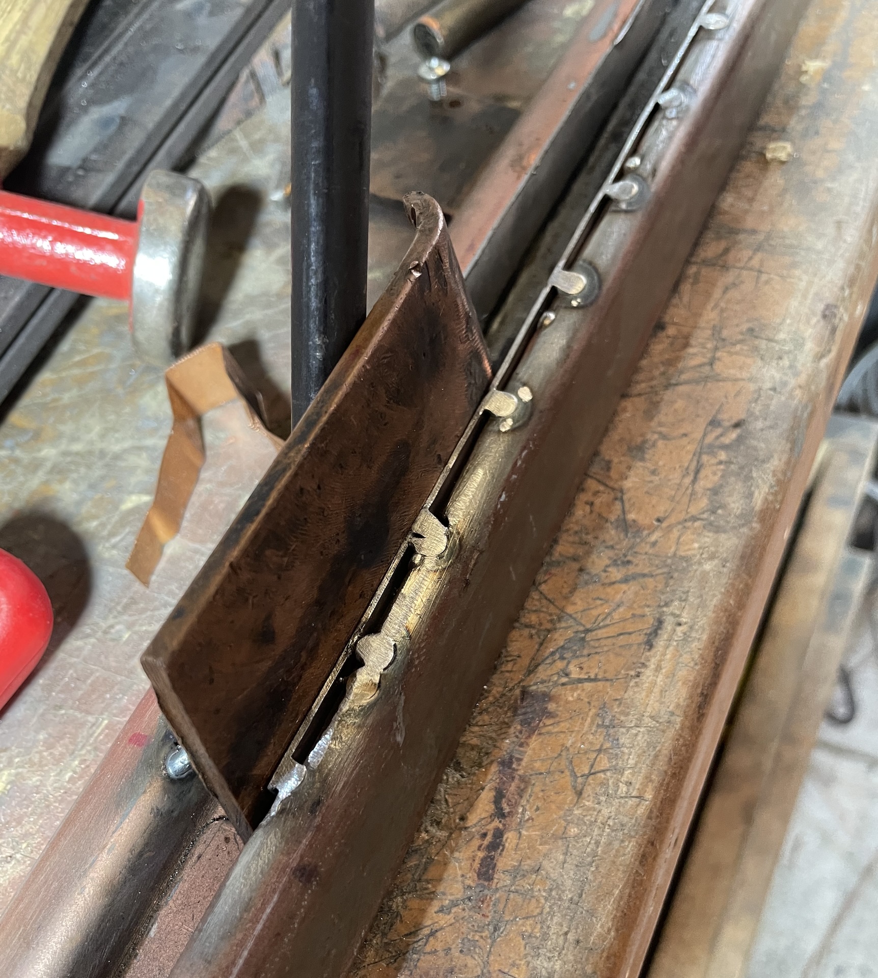

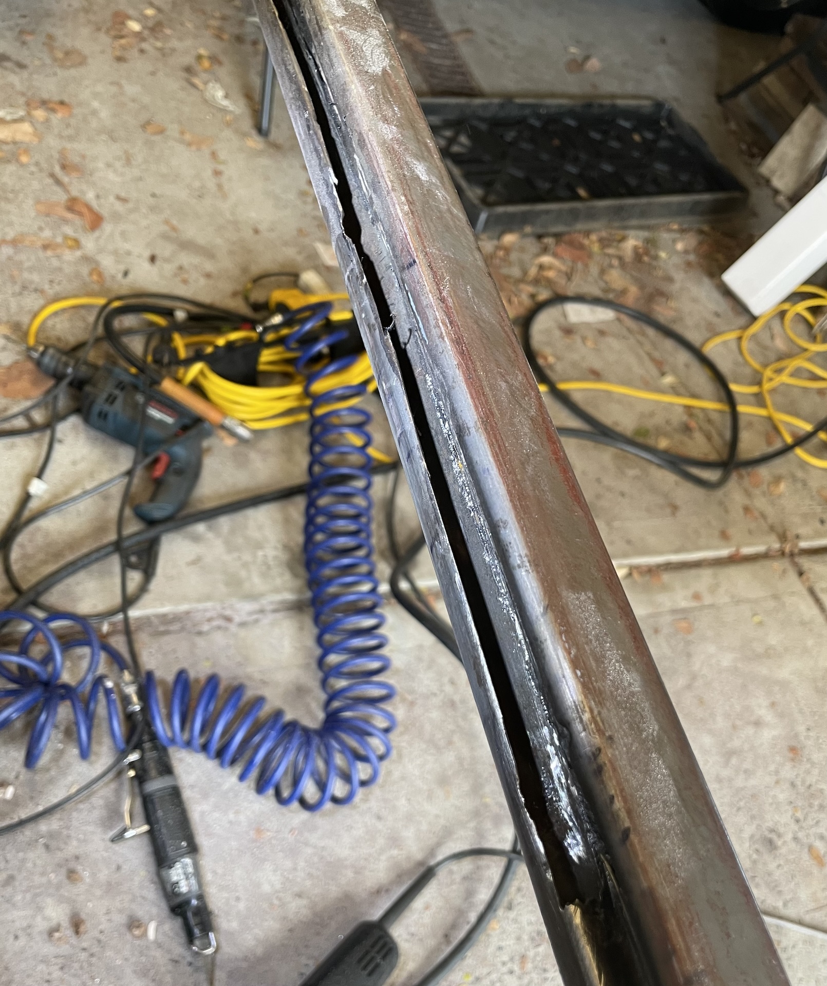

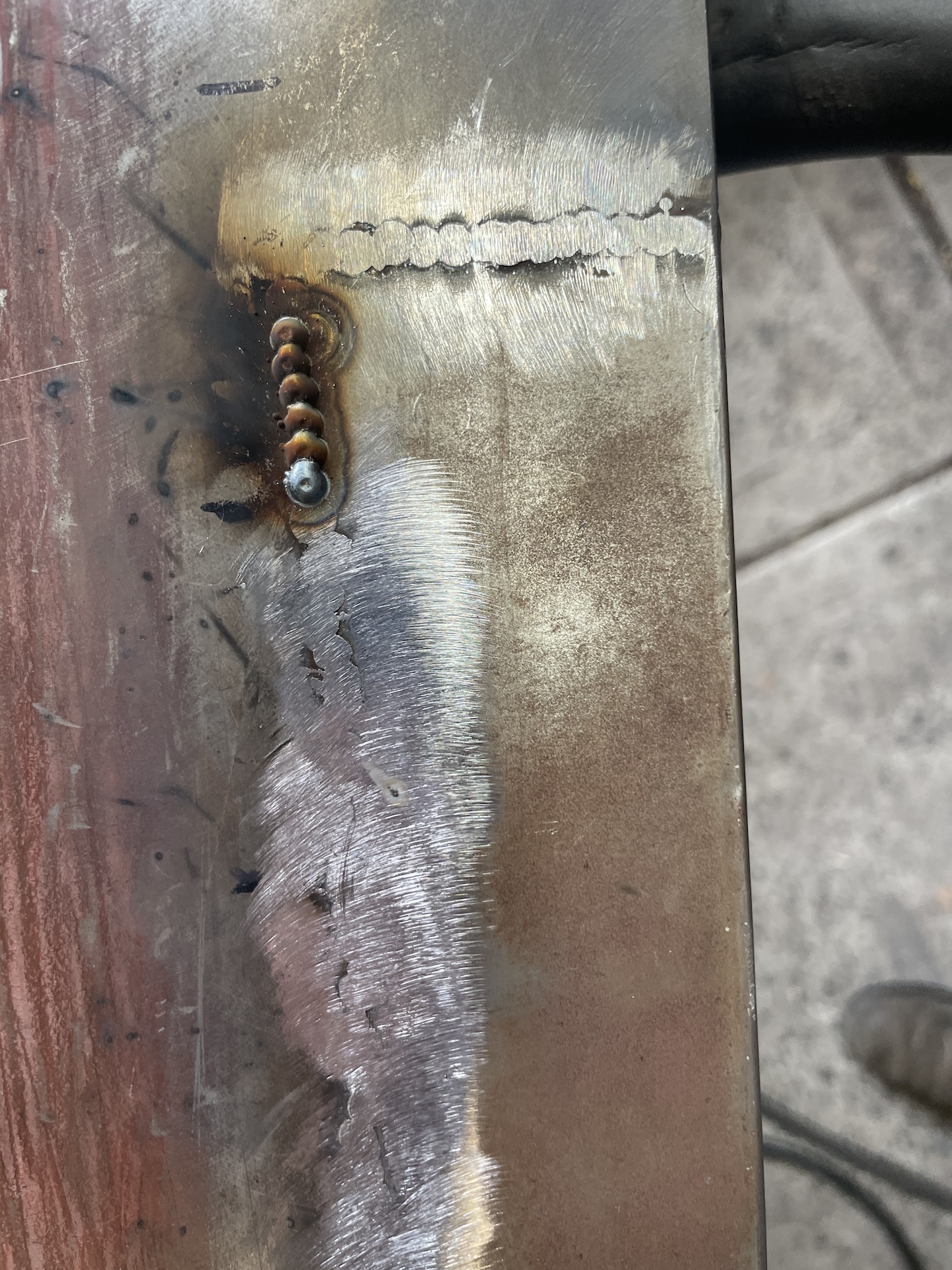

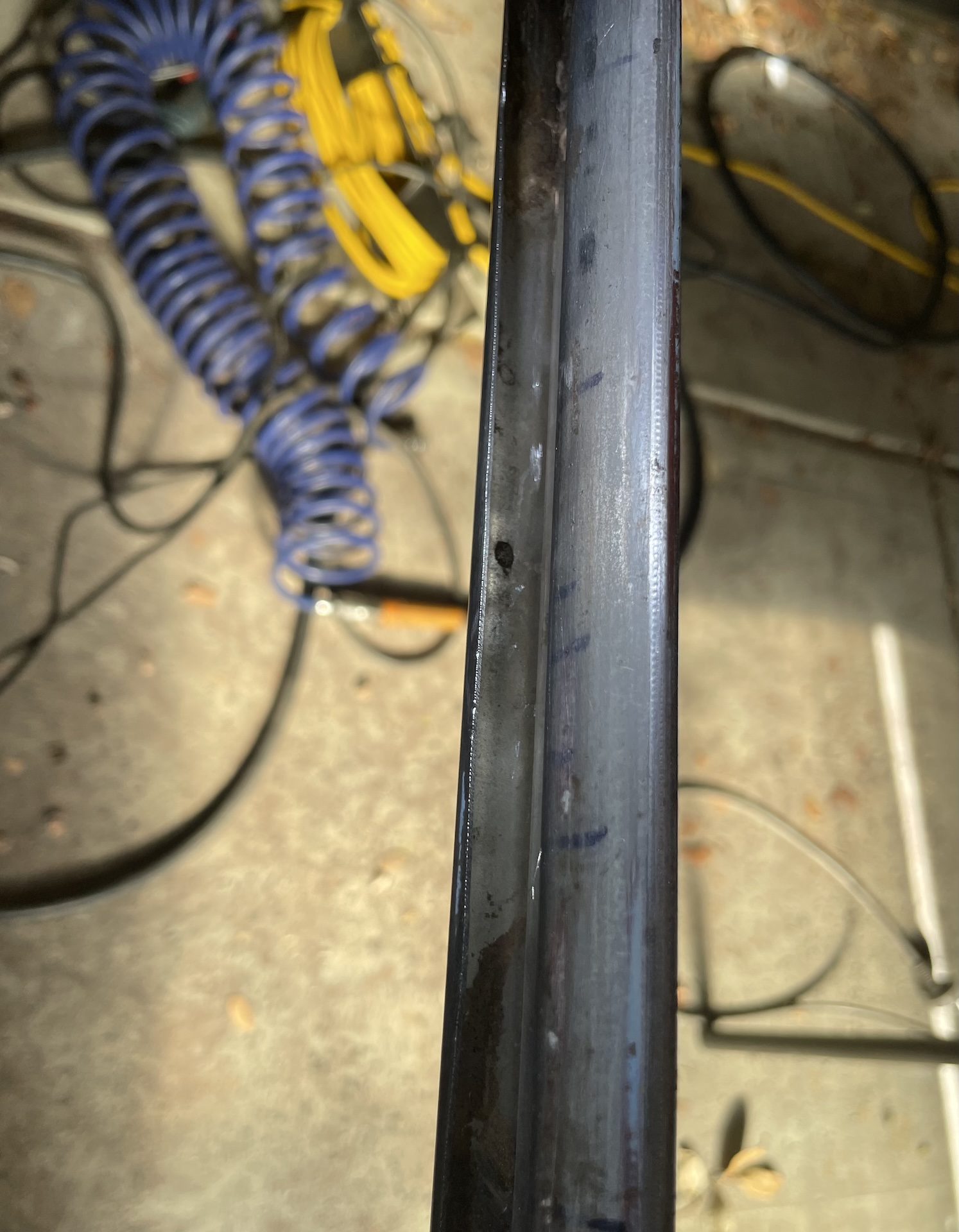

Formed up a channel.
Channel ready to plug weld into the frame
Copper primed and channel welded in - plugs dressed.

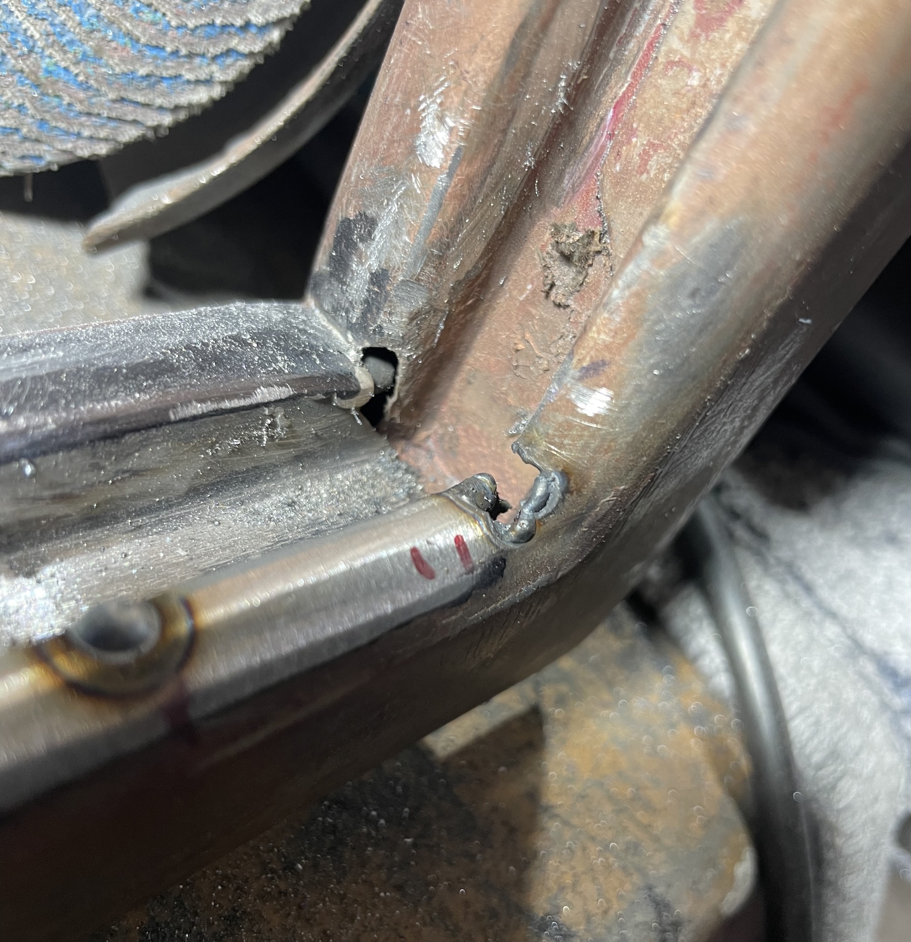

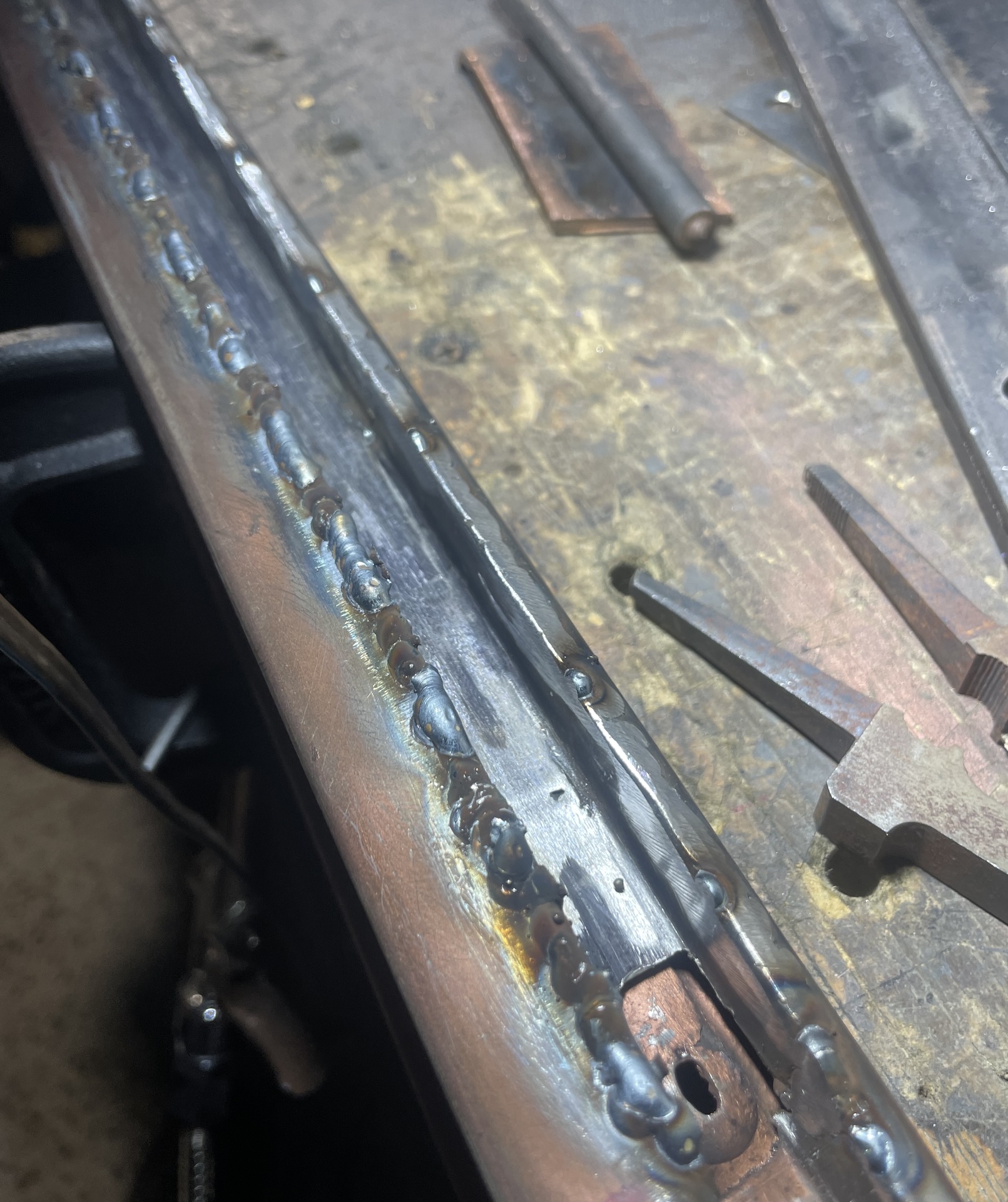

Building a new edge. Probably should have ground the channel down a bit first but was worried that welding into the edge would blow holes.

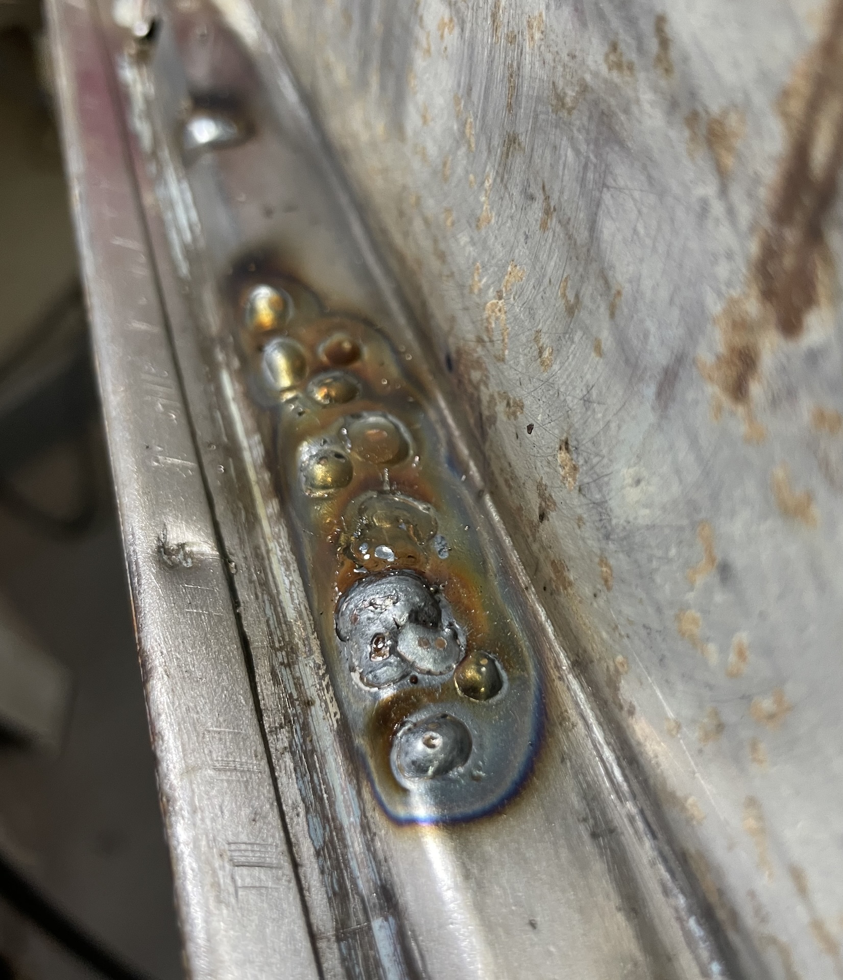

One side welded and the other dressed with some pin holes filled
Forgot I have nothing backing the corners and immediately blow a hole in the frame
Grind, fill, grind, sand, done.
