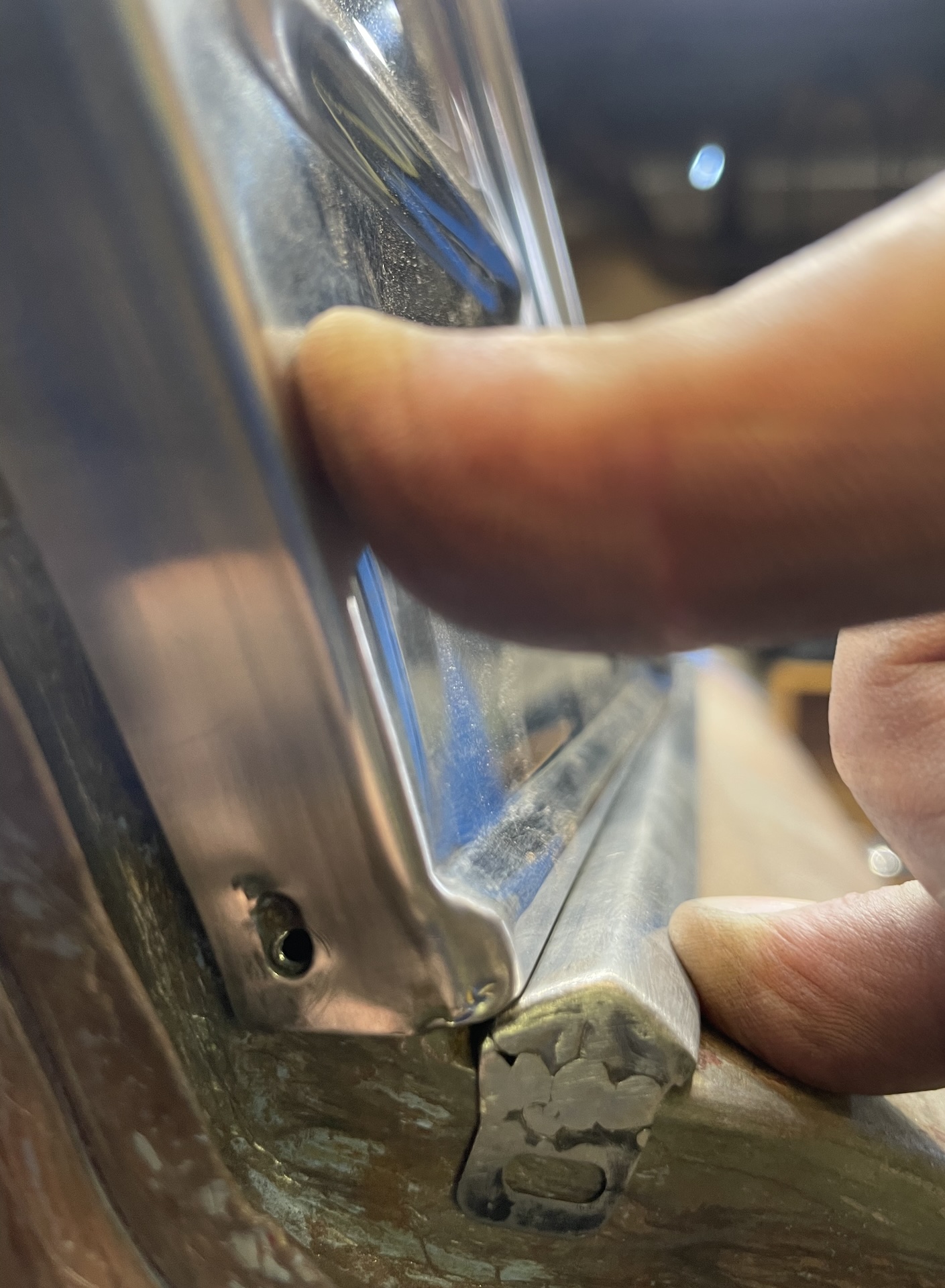

funkyscooter wrote: Sat Jan 10, 2026 10:56 amHey Stephen, I used hardwood pieces profiled to the curves and a steel hammer to knock out the fine creases, and then a plastic mallet to form the rest. Was hoping that cutting out the piece under the curve would force it to hold the shape, but the trim is only 0.5mm thick so it was asking a lot. Used 0.9 316 stainless wire to fill it all back in.In the Shed wrote: Fri Jan 09, 2026 10:37 pm Hey Scott
Good work there, the stainless trim will polish up nice. Did you use a steel hammer on the window trim, is that why the trim has stretched? What did you use to tack the trim back together?

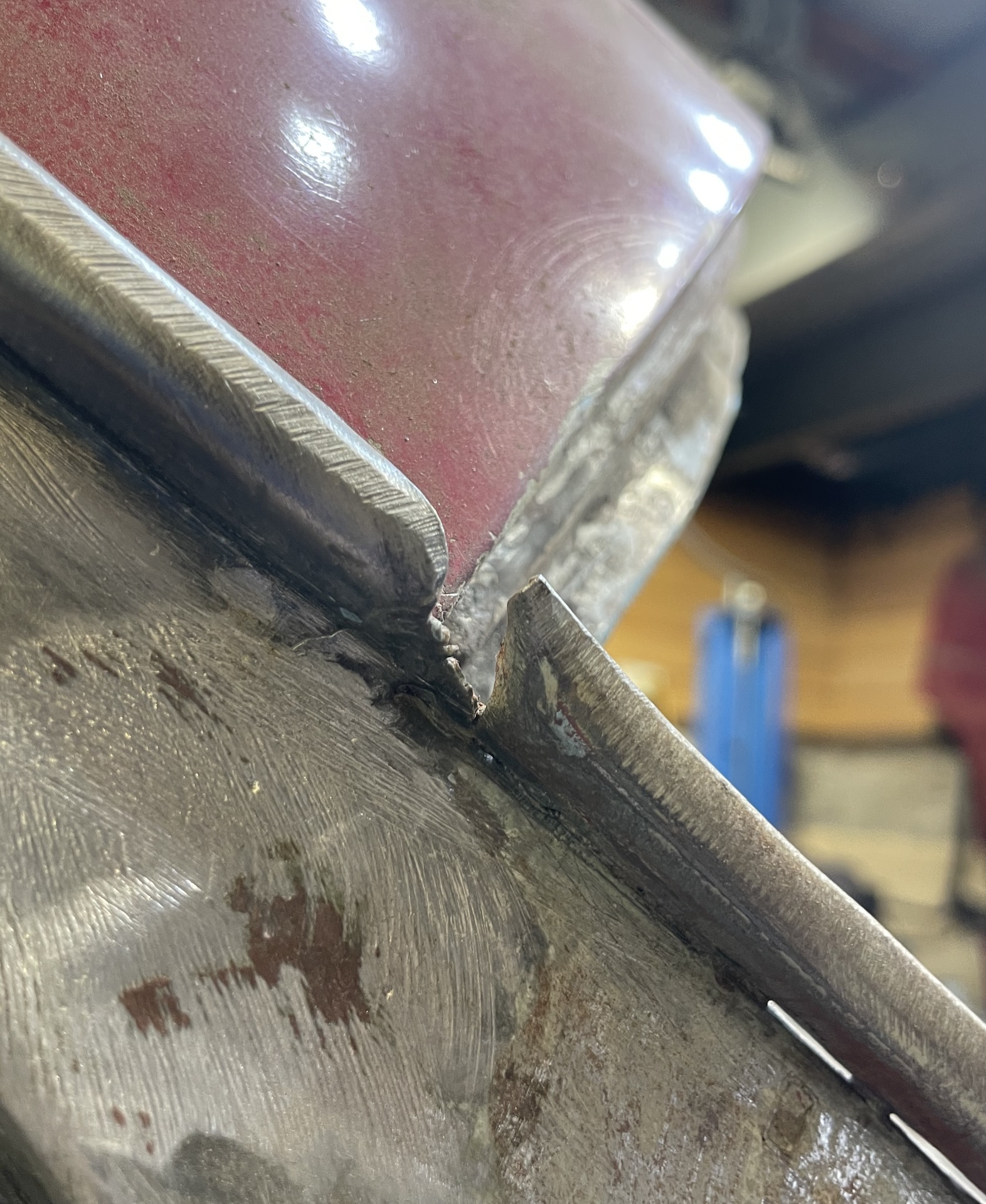

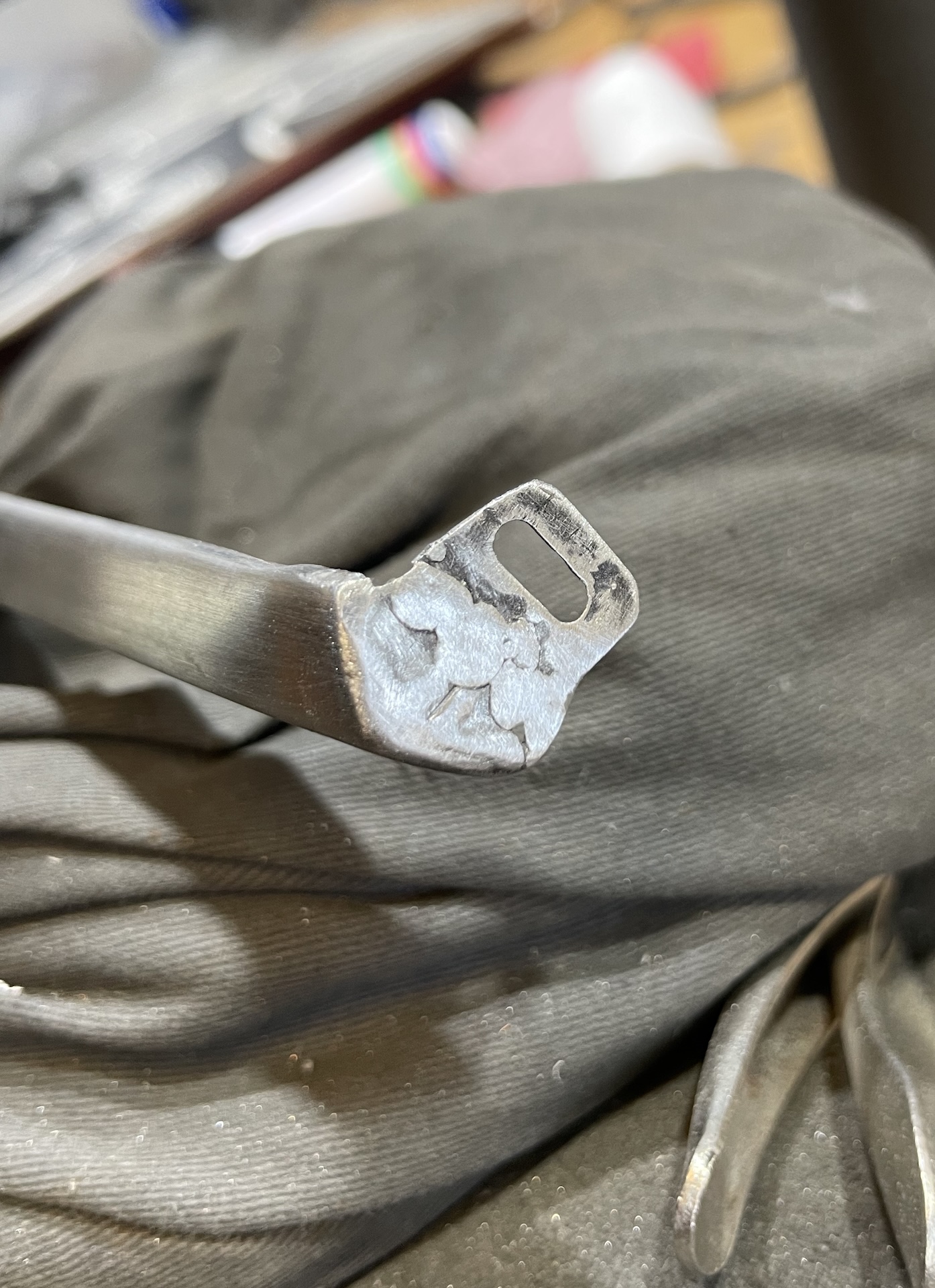

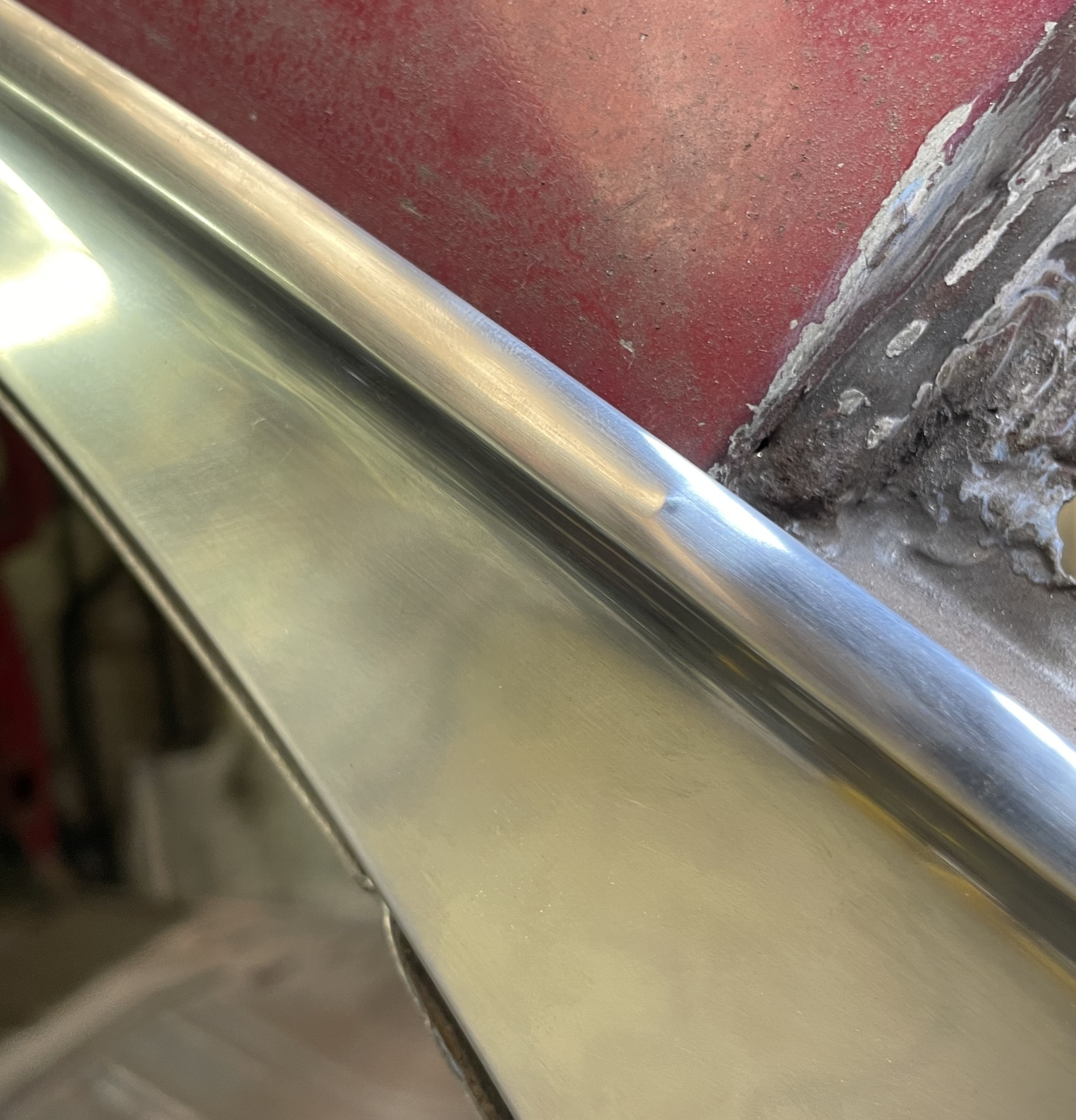

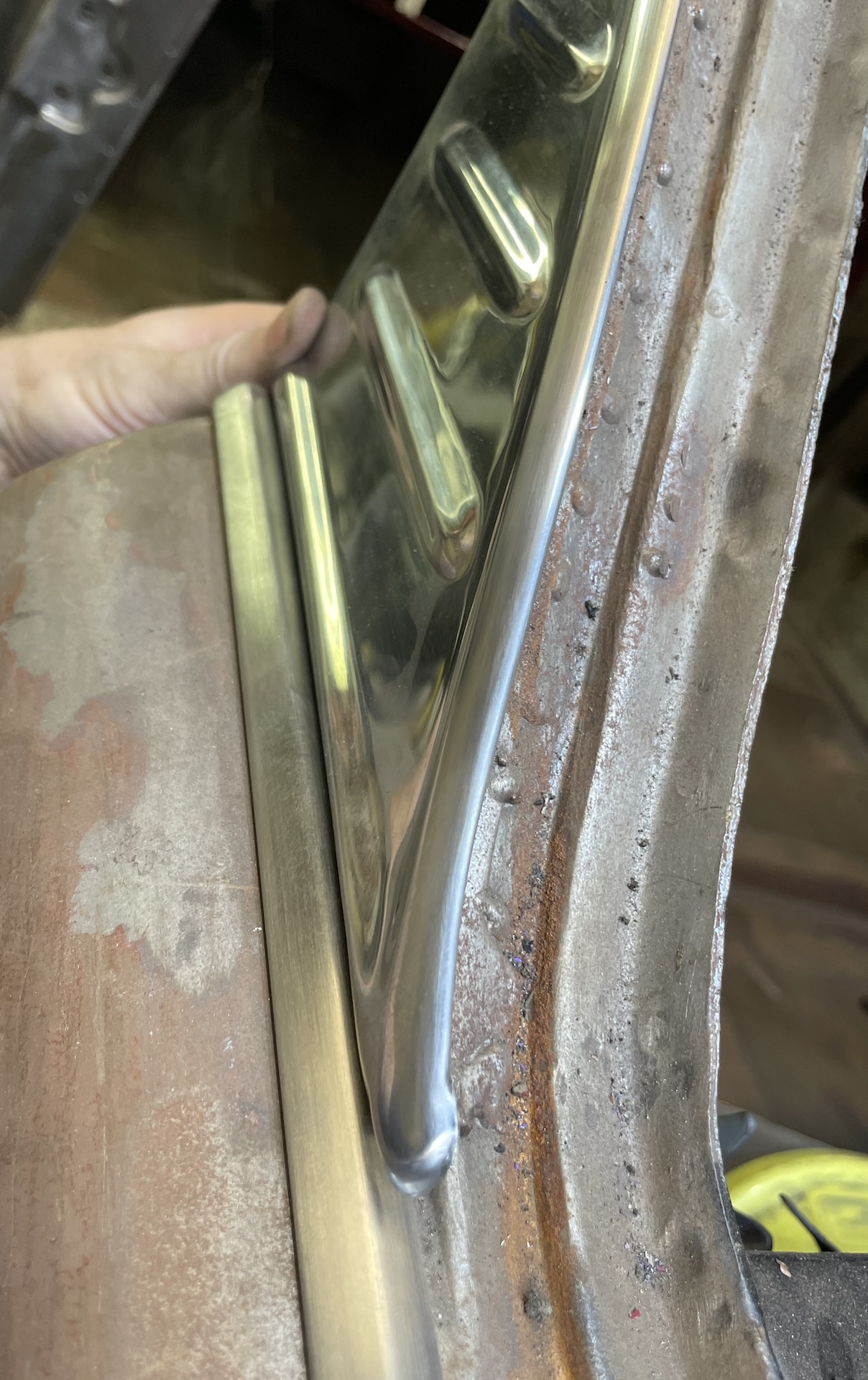

First up - rear quarter top. This had a broken end so I stole a good one off a shaggged bit I have in my stash. Think this material is about 0.6mm thick, but with a copper backing, and using 0.9mm 316 stainless wire, it seems to work. Put the C Pillar flash on and lined up the top trim along the crest of the fin. Result at the other end was not so encouraging as the top trim and C Pillar trim converge at the bottom of the window. Checked images online and from what I can see this seems to be the case. Checked the drivers side at it was doing the same thing so I guess it is what it is.
On a side note it was back to the hammer and dolly for the C-Pillar trim which grew an unexpected pimple. The culprit

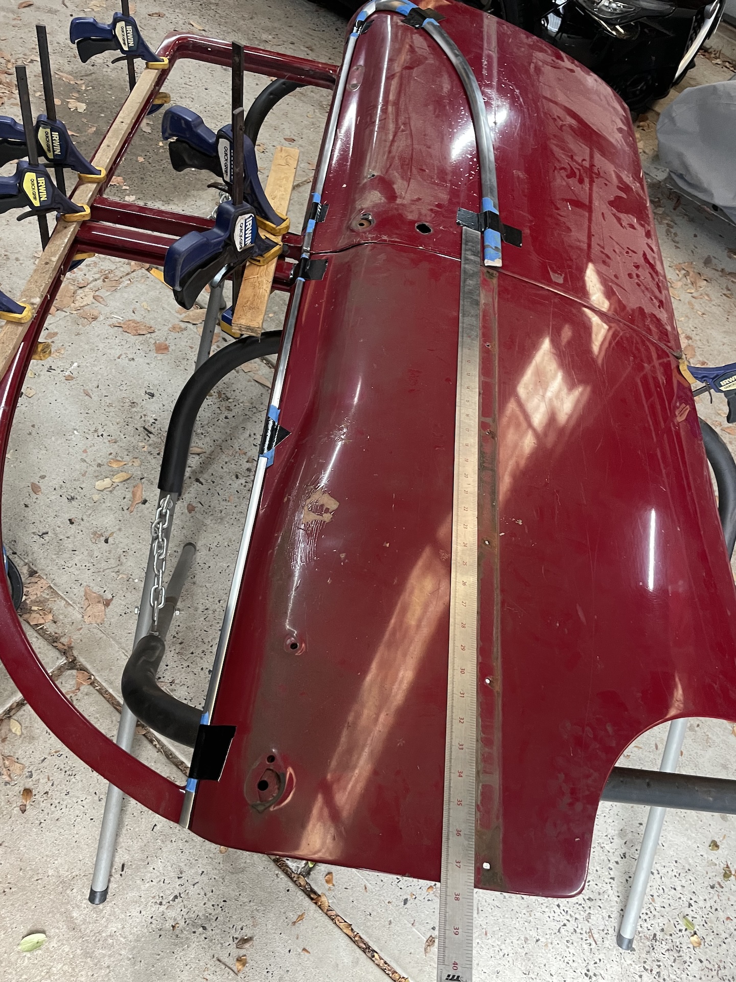

Didn't mark and drill the rear quarters. Put off and unsure about the flow of the trim from the doors so figured best to get them done first, then trial fit the doors, and I'll drill the top of the rear quarters last.
So on to the doors.

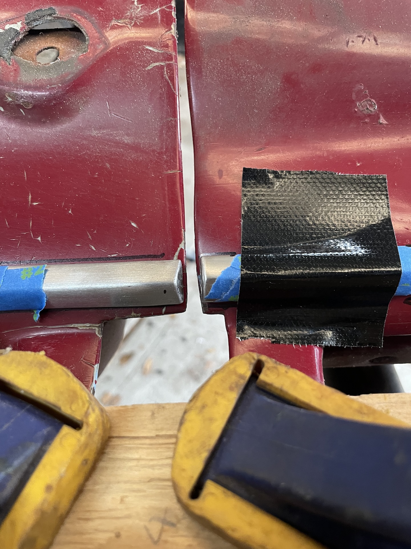

Clamped the drivers side doors together after lining the top and bottom of the them up. Needed a bit of extra help holding the trim down so out with the gaffer tape. Positioned the ends and again used images to help me get things lined up. Bottom sweep of the front door was lined up to the existing hole for the EK flash. Ran around everything with a sharpie and then marked centres, punched, and drilled the holes. Went with 3/16", but might step them up a size to give me a little bit of play room.
Then forgot to take a picture of the end result. Repeated the process for the passenger side. And forgot to take a photo again.

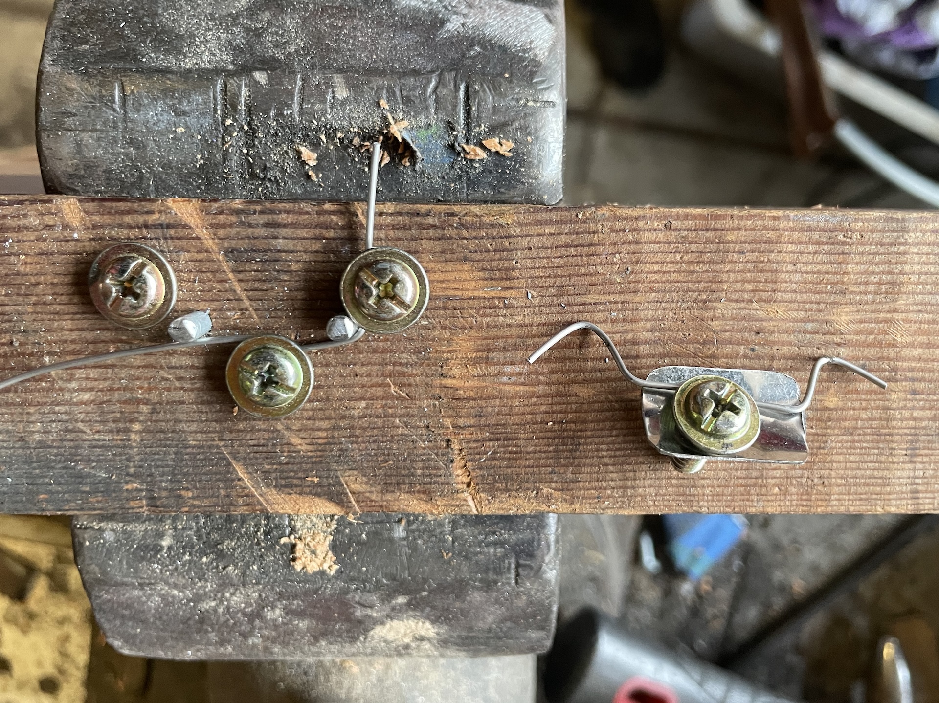

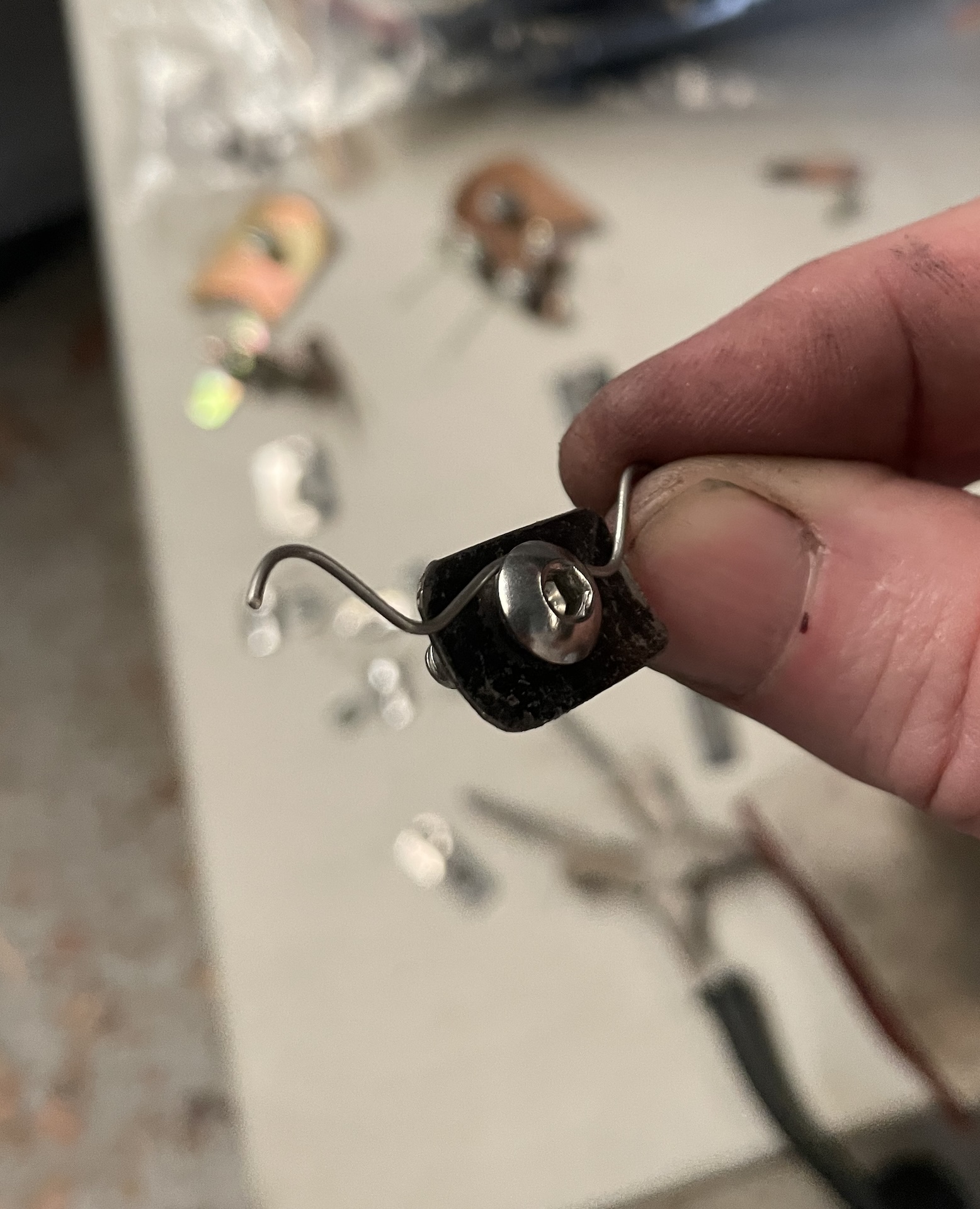

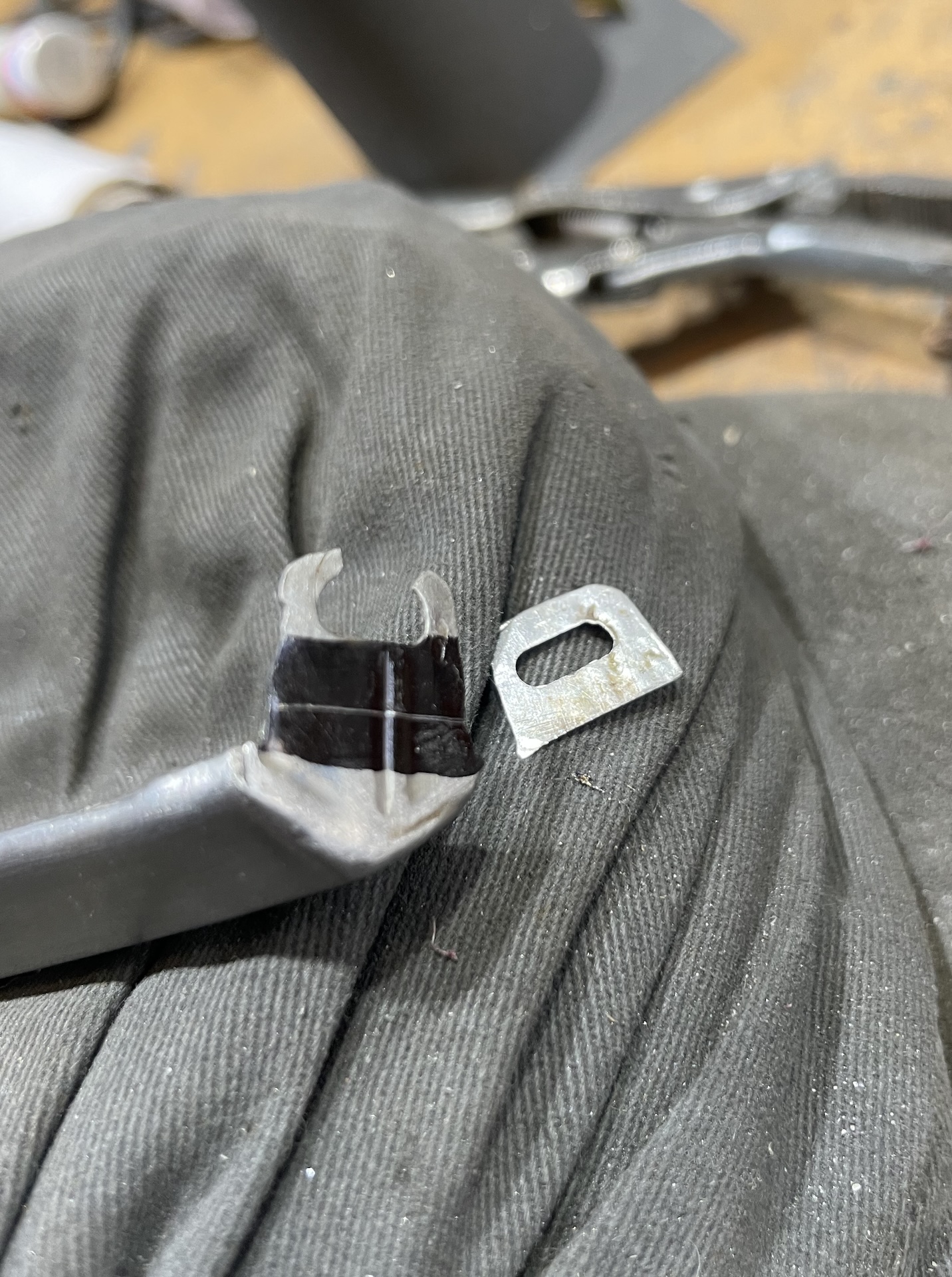

Got out my collection of trim clips and fitted up the drivers side to confirm that I had all the bits and they held everything. Noticed a flaw in my original design which had a bent over tab to hold it in the trim. Every second one broke off when I fitted them, so came up with plan B. Stainless 316 0.9mm welding wire as a spring. Set up a little production line.
Some time later
Ordered some 304 domed head 3/16" bolts online, screw the bolt into the mounting plate with the spring sandwiched in-between and you get this.
Here is a complete front door kit.
