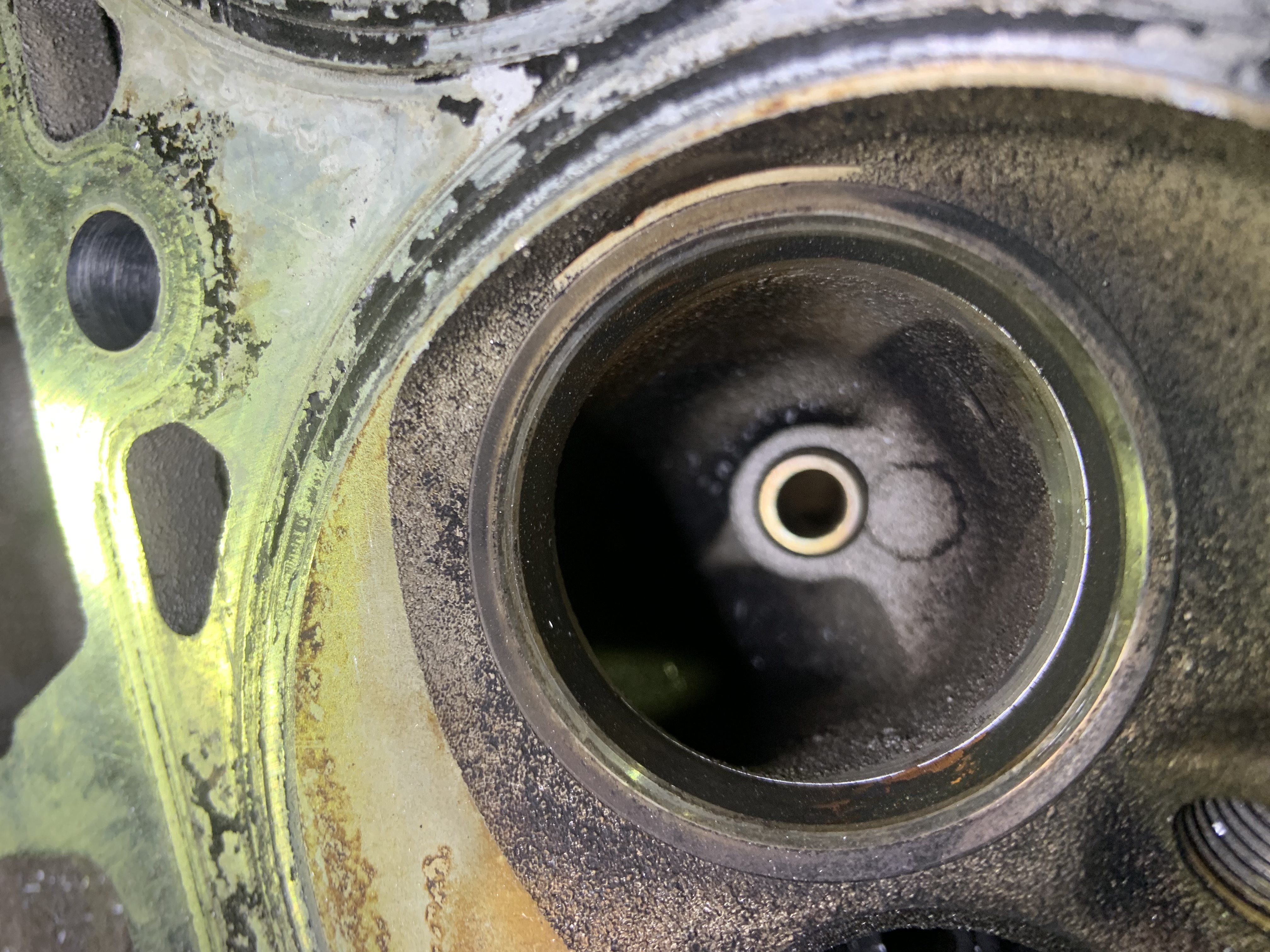

Started the port work of the heads, can’t beat YouTube tutorials.
Block and rods going to the engine shop tomorrow.
Posts: 14211
Re: LS1EK
Nice work 😎😎👍

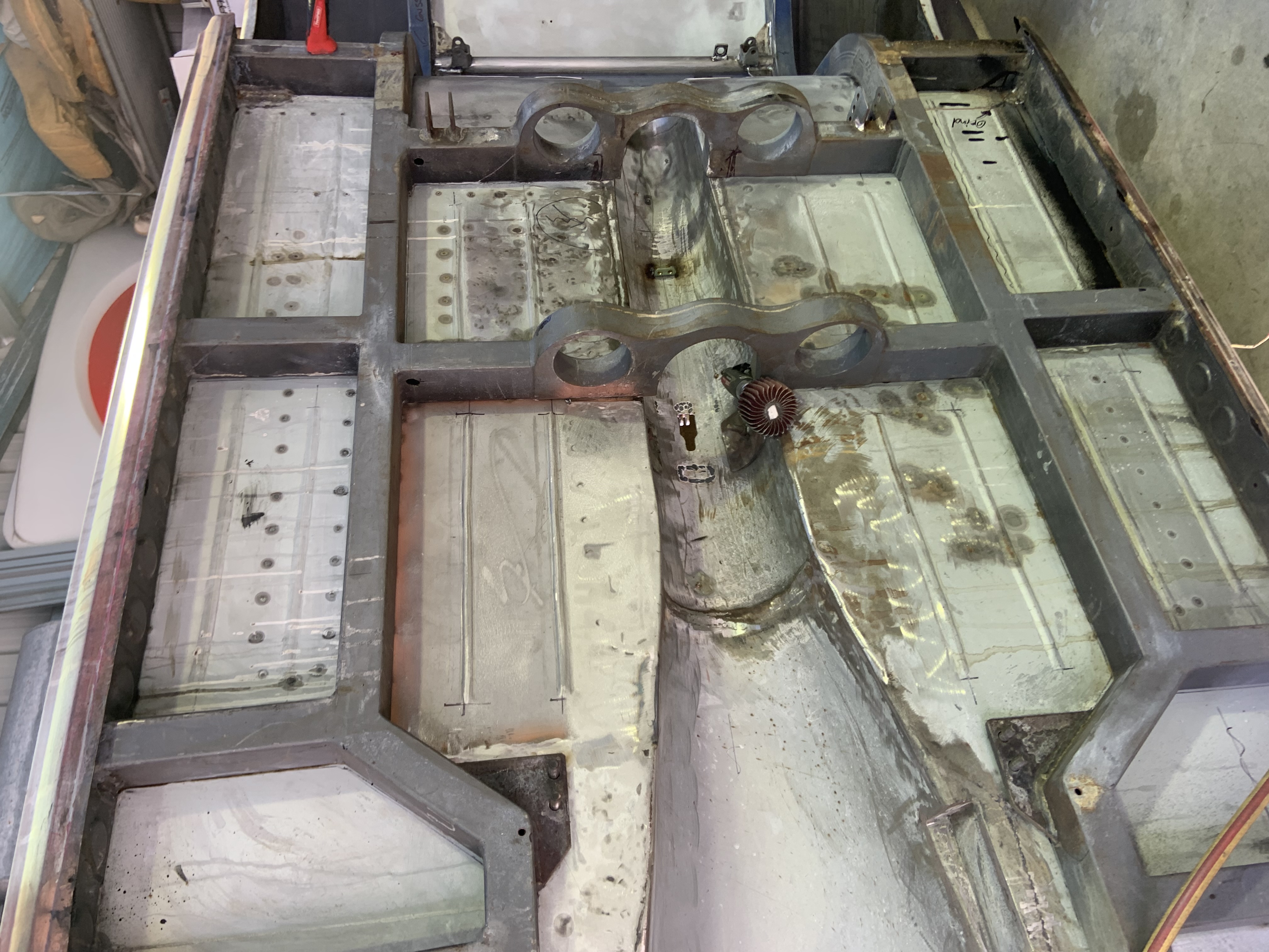

Another milestone achieved yesterday, floor pan treated for rust and ready for epoxy.
Before treatment
Before treatment
Have everything a sand with 80 grit.
Then treated with rustgo.
Posts: 11599
Re: LS1EK
Looks fab Taz
Posts: 14211
Re: LS1EK
I need to get me one of those rotisserie things for when I get started on the tubs and rails in the 2 door 👍👍 looks mint Simon 😎😎
