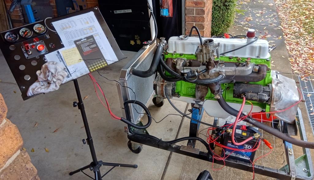

And more car related I finished my first engine build, as practice for Betty's grey motor.
The Junk 186. 3 pistons were completely stuck in their bores and I broke 2 persuading them to come out. No 1 bore is waaaaaaay oversize, out of round and tapered and understandably only has 30 psi dry compression and 50 wet. The rest average 80. But it runs, so I didn't do too badly. The only new bits were bearings, rings, gaskets, fuel pump, spark plugs, leads and bits and bobs. The rest were original to the engine or used parts sourced elsewhere. It was good fun and I enjoy running it and disturbing the neighbours!

A green Holden six….. wow!! With cylinder bores like that no wonder you don’t see too many in action 😊

I've lost count of the number of 186s I've had to bin because no. 1 cylinder bore wore badly at the front, and then the rings broke.
But I like the engine test setup. The music stand sets it off beautifully.

I can vouch for the green. It's very loud. Imagine a green motor in an orange car. It hurts just thinking about it.

Hi Rob, why is it that the #1 cylinder wears more than the others?

You asked why number 1 wears out faster than the others. There's probably a Ph.D. to be had in this. It's peculiar to red motors. Some half-formed ideas:
The water pump impeller sits hard up against number 1 cylinder. You could imagine a situation where cavitation seriously reduces the heat transfer from the cylinder to the coolant. The top of the cylinder bore dissipates more heat, and the front of number 1 is subject to poor cooling anyway because of cavitation. So it gets hot. And it's the most "uphill" place in the motor, thus the most prone to lubrication failure. So I think it's a bad combination of high heat load, poor cooling and poor lubrication. If the motor was driven hard and not well cared for, all the conditions for rapid bore wear would be met.
And another thing - all the 186s I've binned because number 1 bore was flogged out at the front were 192s. So I think that thin cylinder walls are a contributing factor.

Not me. But I can attest to 192s having cooling issues.

The Low Compression (LC) Green motor was the model between the Red and Blue motors. :mrgreen:

I can only tell you greys break the snout of the crankshafts in the number 1 bearing cap.
Reds will pull the block apart and crack horizontally to the bores, from memory number 1 was the worst.
When I used to be involved, the HQ boys would bore the 202's out in all cylinders except number 1. This may have been because of Robs info but the smarties did this so when the blocks were inspected by the officials they would measure # 1 only and move on. That was of course eventually found out. A liitle advantage was always required in such a tight ruled class !!!!!
