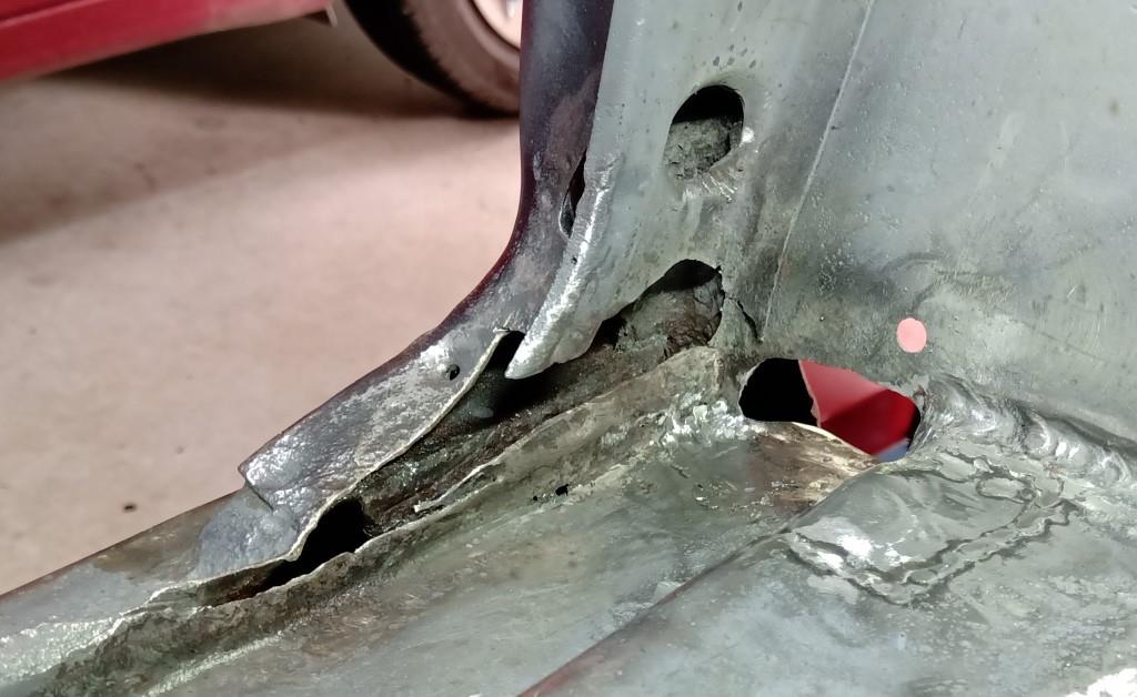

Thanks all for the support, some more slow progress on the right hand rear seat pan all but finshed
I thought with more original metal remaining on this side it would be easier but I was wrong. Lots more smaller patches made for more work. And this corner was tricky
But mostly done, just have to finish grinding welds and checking for pinholes. But what is the purpose of this raised tab and the large hole?
What is this.jpg (114.24 KiB) Viewed 3642 times
There was a plastic bung in the hole. The other side was so rotten I couldn't tell if it was the same. Any thoughts appreciated.
Onto the dogleg next
Dave
62 EK Sedan in slow progress
Posts: 2413
Very neat work Dave.
There is a hole on each side of the rear pans hopefully worked out to be the lowest point ( but the pressings make them less effective). I reckon they are next to useless😁. And yes, they have bungs that come with the rubber kits but they are nothing special.
