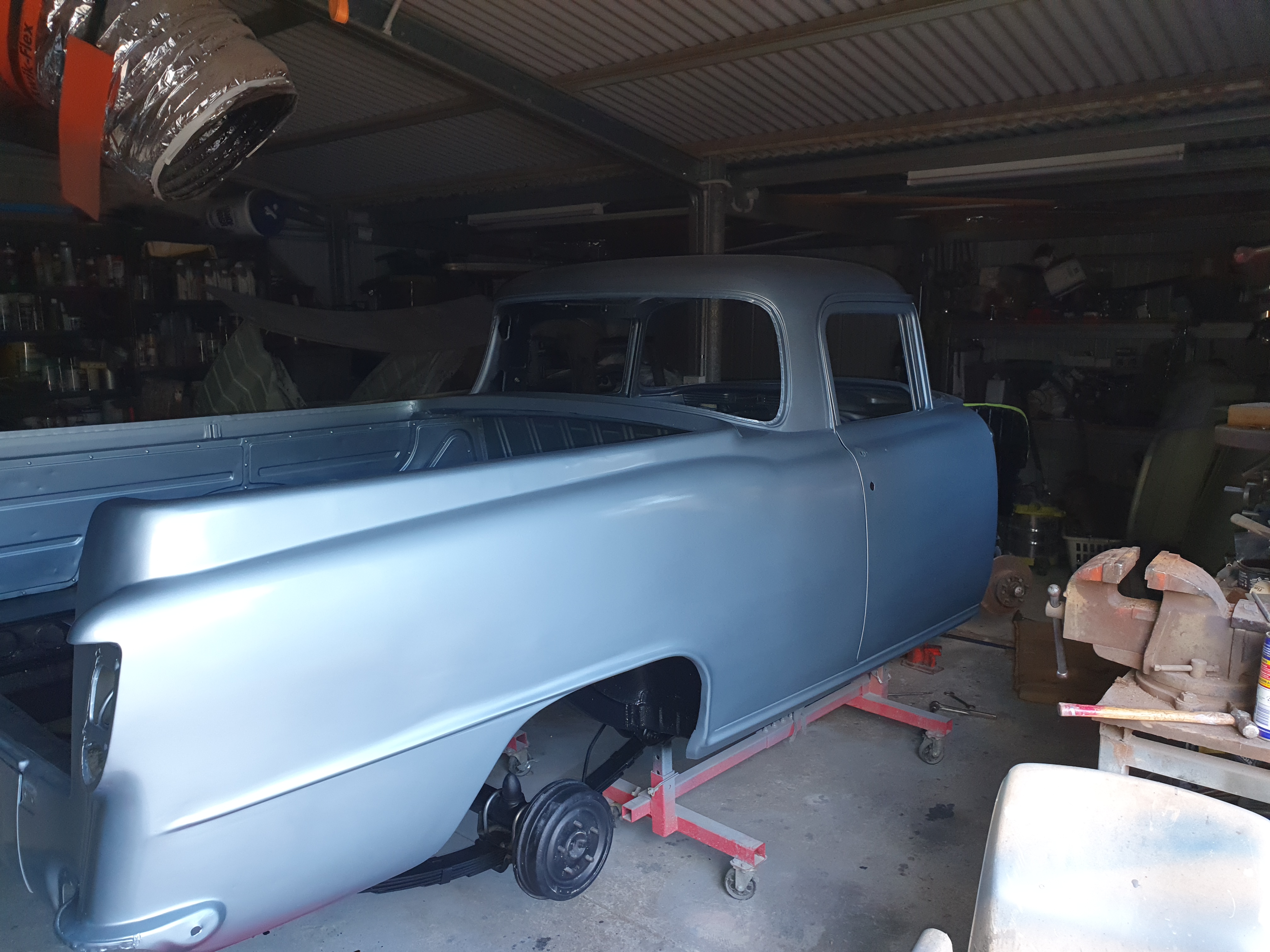

On another matter, this colour is pretty good. Blues come out in shade, silver in light. Pity its not on a more perfect body.

You don’t want it too precious or it won’t get used.
Posts: 11677
Re: Project 2.
Any way, looks the goods from here….
Posts: 2290
Re: Project 2.
Yep and from here too 👍
Posts: 2538
Re: Project 2.
Should've gone to Specsavers😀

Brett,
All you have to do is take 3 years to rub and recoat every panel then you can throw your glasses in the bin !!!
Its a great hobby and as long as you are happy that's all that matters. The colour is very soothing I must admit, job well done.
Posts: 2538
Re: Project 2.
Thanks Greg. Very happy with paint, best I've ever done. Not so happy with panel smoothness, but considering all things it's not too bad.
