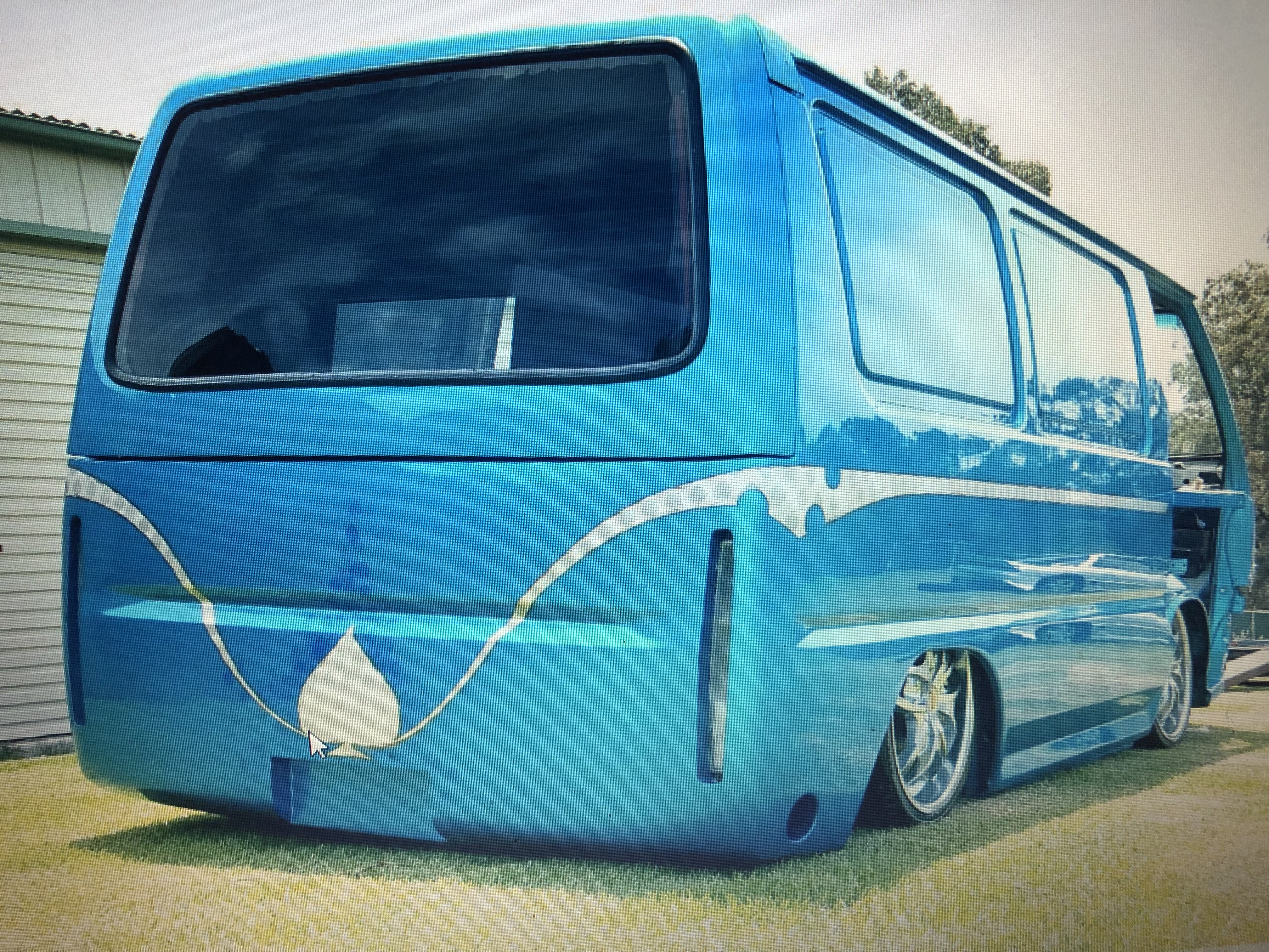

You can do an airbag setup with monoleaf. That’s taking all leafs off except last one and that keeps diff located. I wouldn’t do but it’s a cheap way to get a cool look without 4 link. Otherwise you won’t get the drop you want.
I have had a couple of cars with airbag setups and a lot goes into fabrication to do it properly on the back.
This is my van
gpi

yeah thats about how high it needs to be

Looks as though he did mono leaf setup. Neat setup though. My van has way to much done with 4 link , chassis notch and and tubbed. Looks like the ek will be a lot easier to get down!! Good luck very interested to see ur progress. You doing the install yourself? Where are you located
