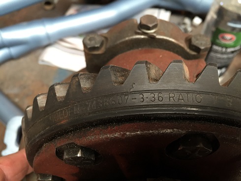

Re: Holden Diff Ratios
Looks like I have 2 centres both at 3.55.
Better than the factory 3.89 I guess!
Both very rusty and in need of rebuilds though
