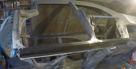

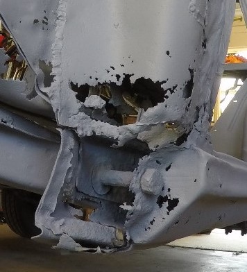

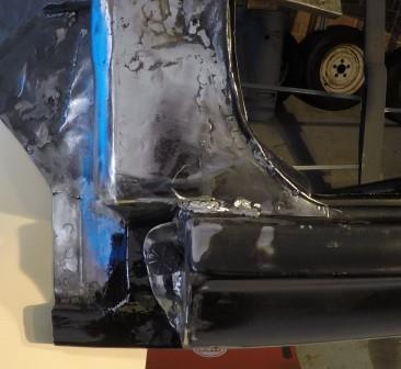

Well it's been nearly a year - progress has been slow - but progress nonetheless. Finally put the new Rares left outer sill on after having to remake the bottom on the A pillar and dogleg.
They were this:
Dogleg 1.JPG (35.71 KiB) Viewed 1190 times
OB LH lwr A pillar.JPG (80.43 KiB) Viewed 1190 times

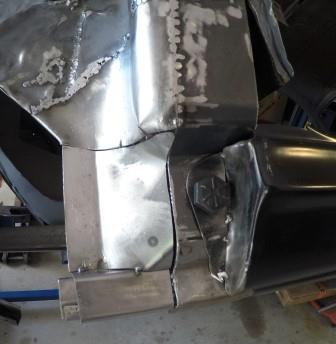

Did the Frankenstein patch on the A pillar and some modification to the outsill bolt hole flange:
Frankenstein patch a pillar.JPG (34.46 KiB) Viewed 1190 times

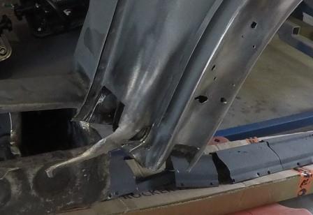

and ended up with this:
A pillar 3.JPG (36.45 KiB) Viewed 1190 times

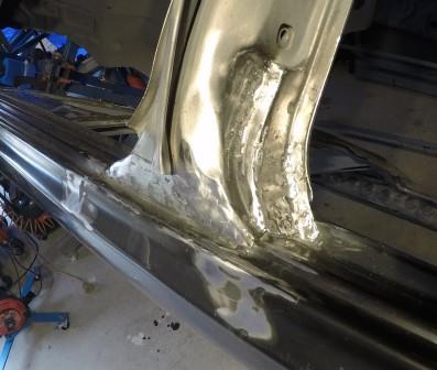

B pillar was easier and even managed to insert a seat belt mounting plate in there for later:
B pilllar.JPG (39.8 KiB) Viewed 1190 times
Dog leg wasn't so easy with all those panels meeting up and folding in on each other but I'm happy with the end result
Dogleg 2.JPG (39 KiB) Viewed 1190 times
and sill is welded on:
Sill final.JPG (34.75 KiB) Viewed 1190 times

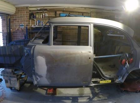

And the subframe and door still fit!
Door fit.JPG (40.09 KiB) Viewed 1190 times
Good news is that the drivers side doesn't look nearly as bad so I think I will get away with A pillar and outer sill repairs in-situ.
Dave

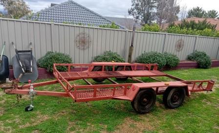

However I could always chauffeur Betty around if she isn't ready, on the next side project:
Needs suspension, rear end bracing, brake overhaul and ramps made. Will be nice to weld with some thick metal for a change!
