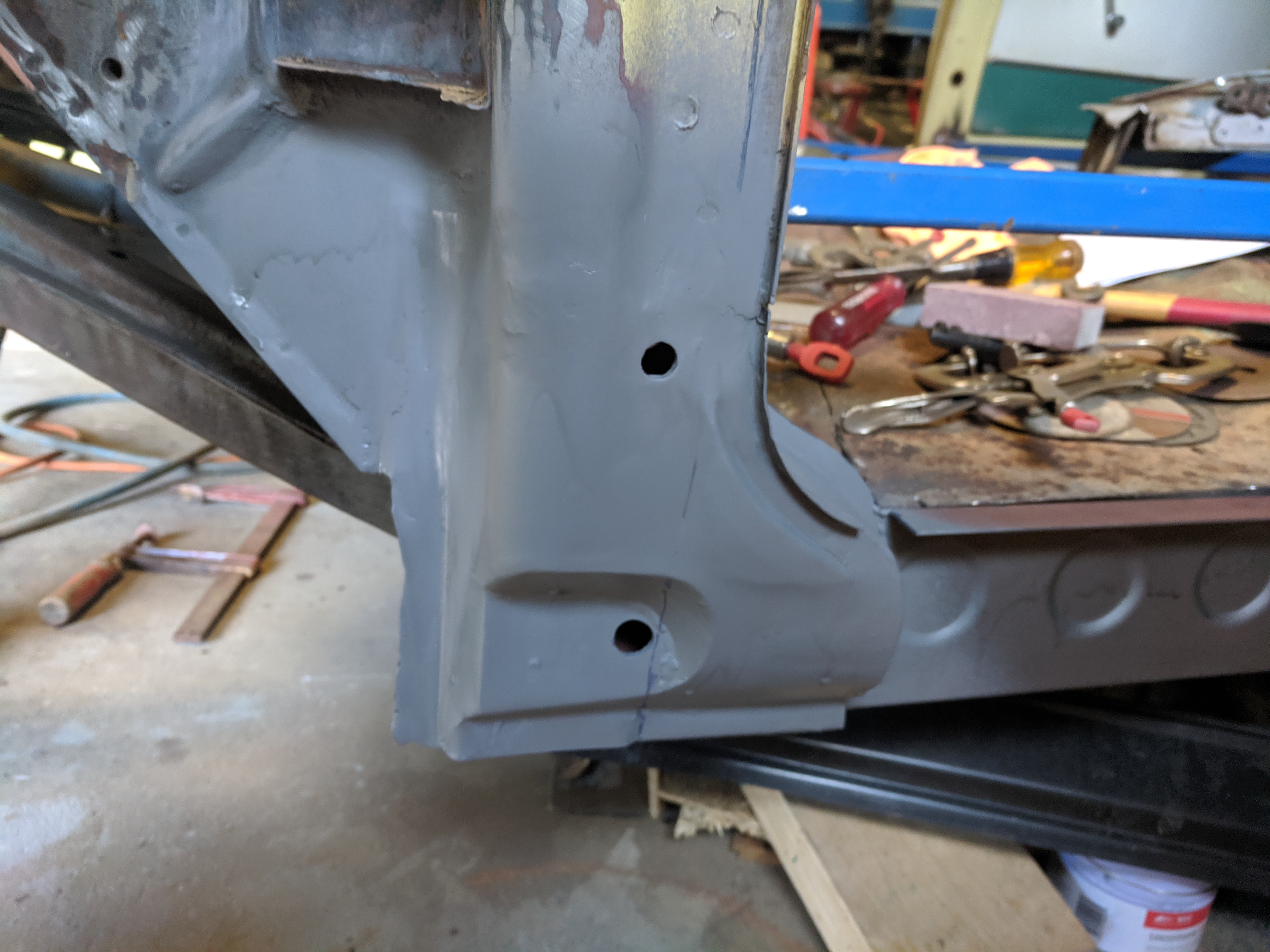

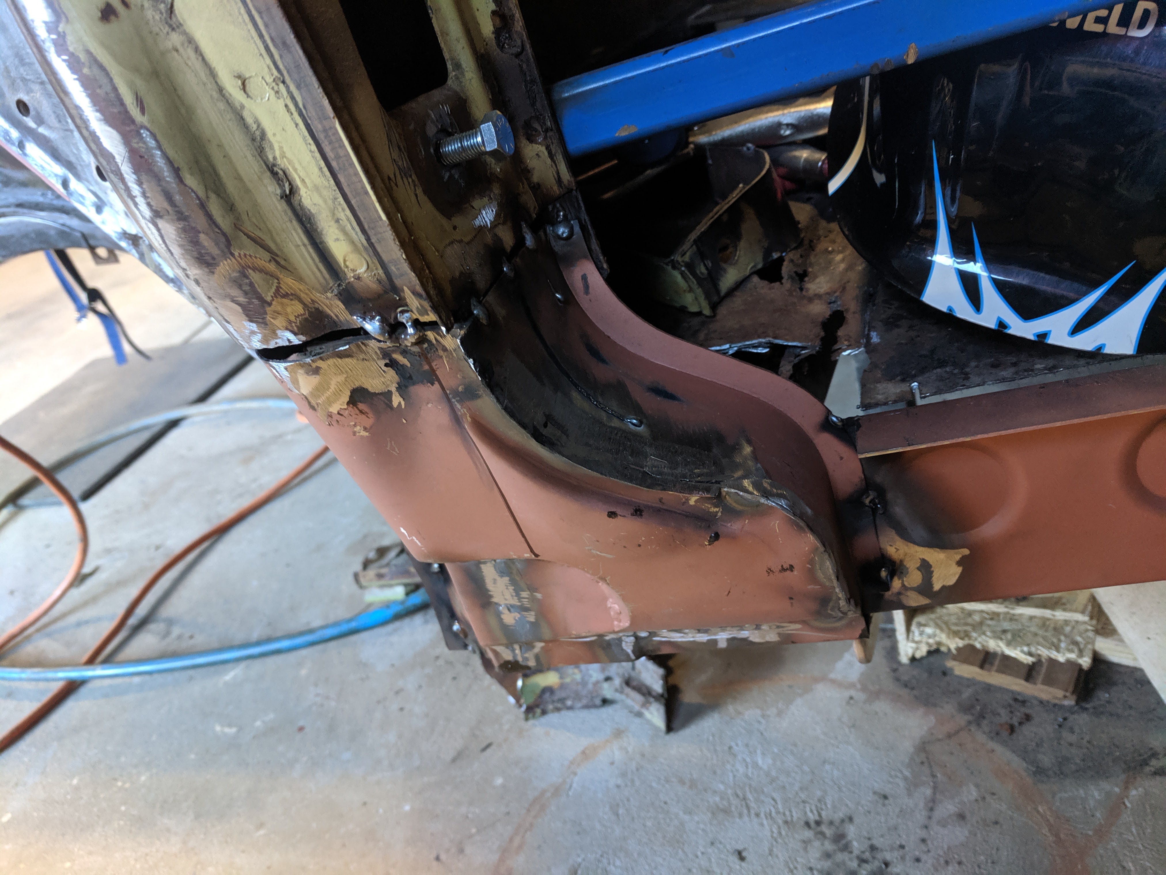

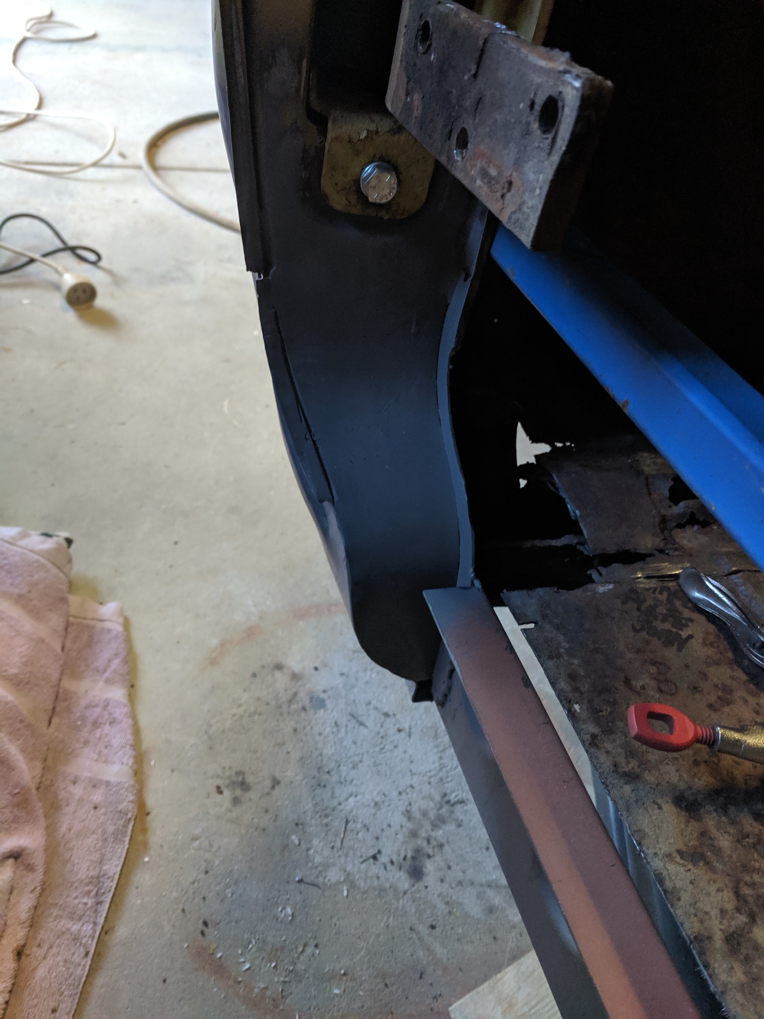

Once the inner sill was in place, A pillars were next. Not having cars to look at and never having done this before, meant that A pillars bottoms were probably the most challenging task. Some may recall questions on the forum about how the inner sill and outer k frame mounts work. Old timer restoration was a particularly valuable resource for me. Thanks Blacky, and also Dave White in Canberra who had a car that I took photos of. There were a few PMs to forum members used to get an idea of how the angles worked. I had purchased left and right mounting blocks from different suppliers and it turned out that one of them had the shorter angled part that fits against the sill cut wrong. Lots of head scratching and not at all helpful when you don't know what you're doing. Fortunately I had enough left of the old bits and a rusty A pillar cut that made it obvious that the mount was wrong. K frame ( which had arms repaired by then) was used to ensure mount was positioned correctly.

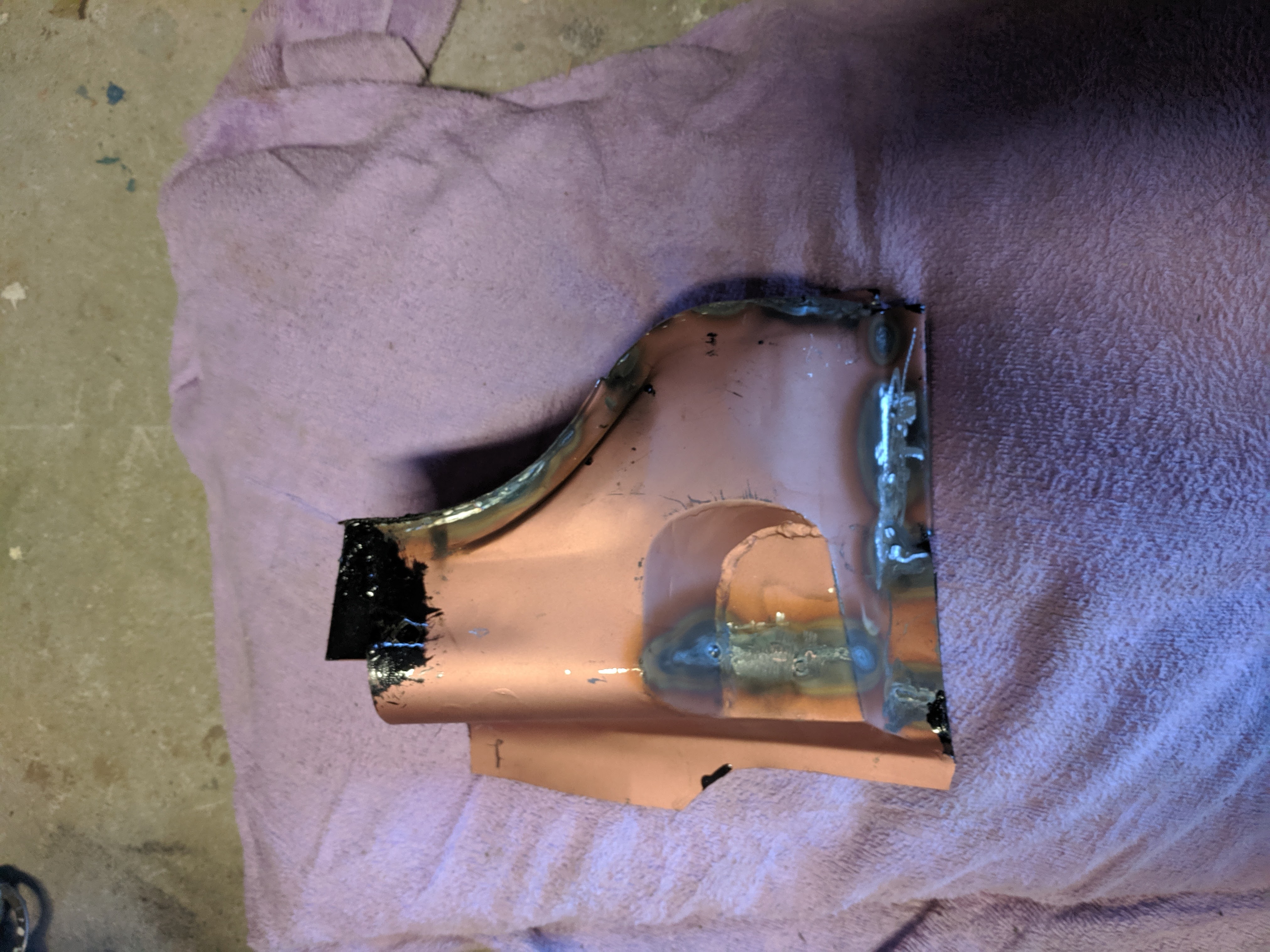

Next was A pillar bottoms. I bit the bullet and bought Stark A pillar kits. These were about $300 retail per side, but they are made of thick metal that matches manufacturer specs and I didn't have the gear to shape the pieces using that gauge steel. They come in two pieces in case you only need an inner or an outer, but I needed both so first job was to weld the 2 bits together. Then make the appropriate pillar cut and tack in new bit. Happy, then final weld. It was that simple.
