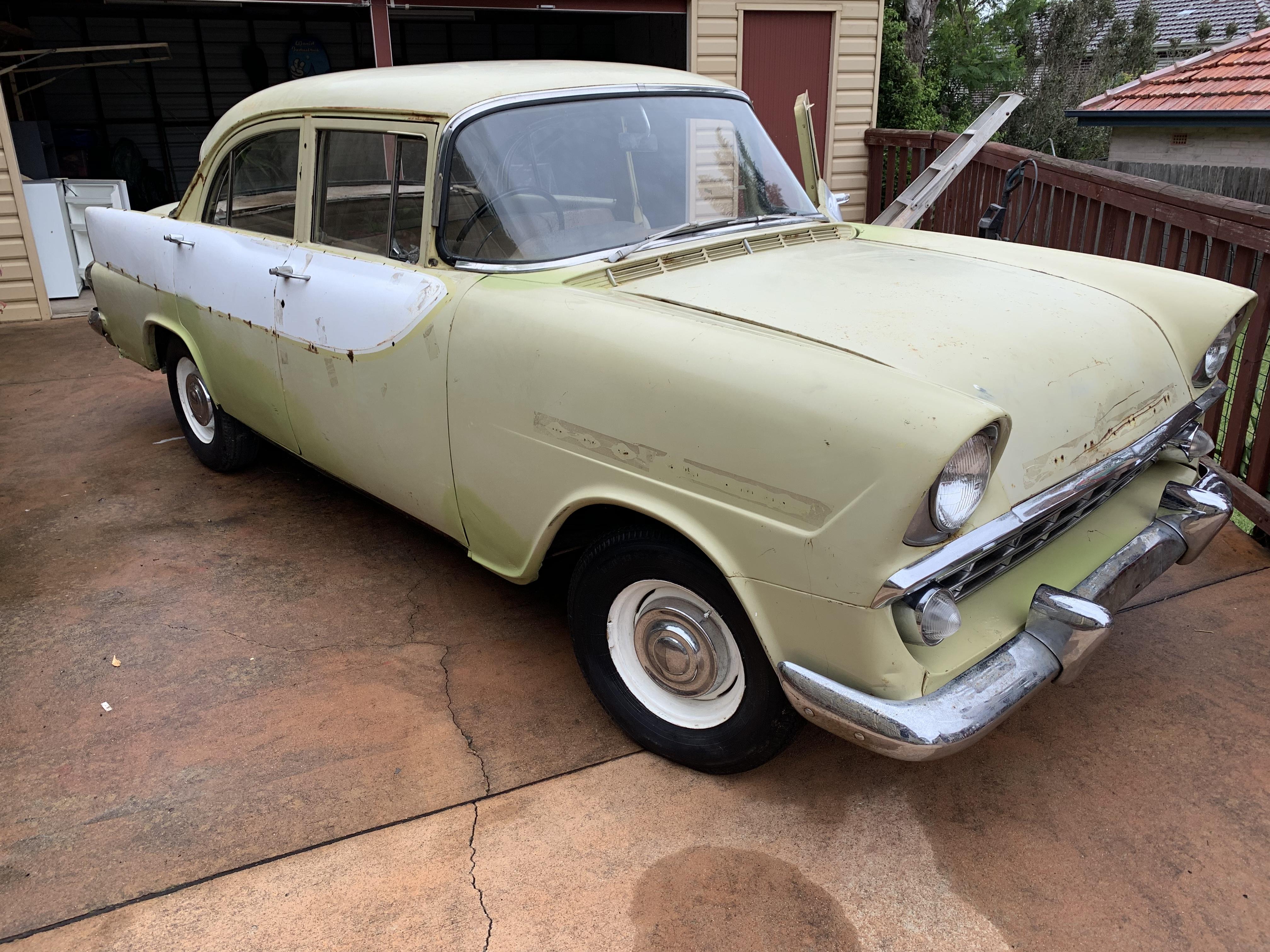

My first sighting of Wilma. Photographers beware. I knew the street and house number because of this photo long before the owner was convinced I was buying.

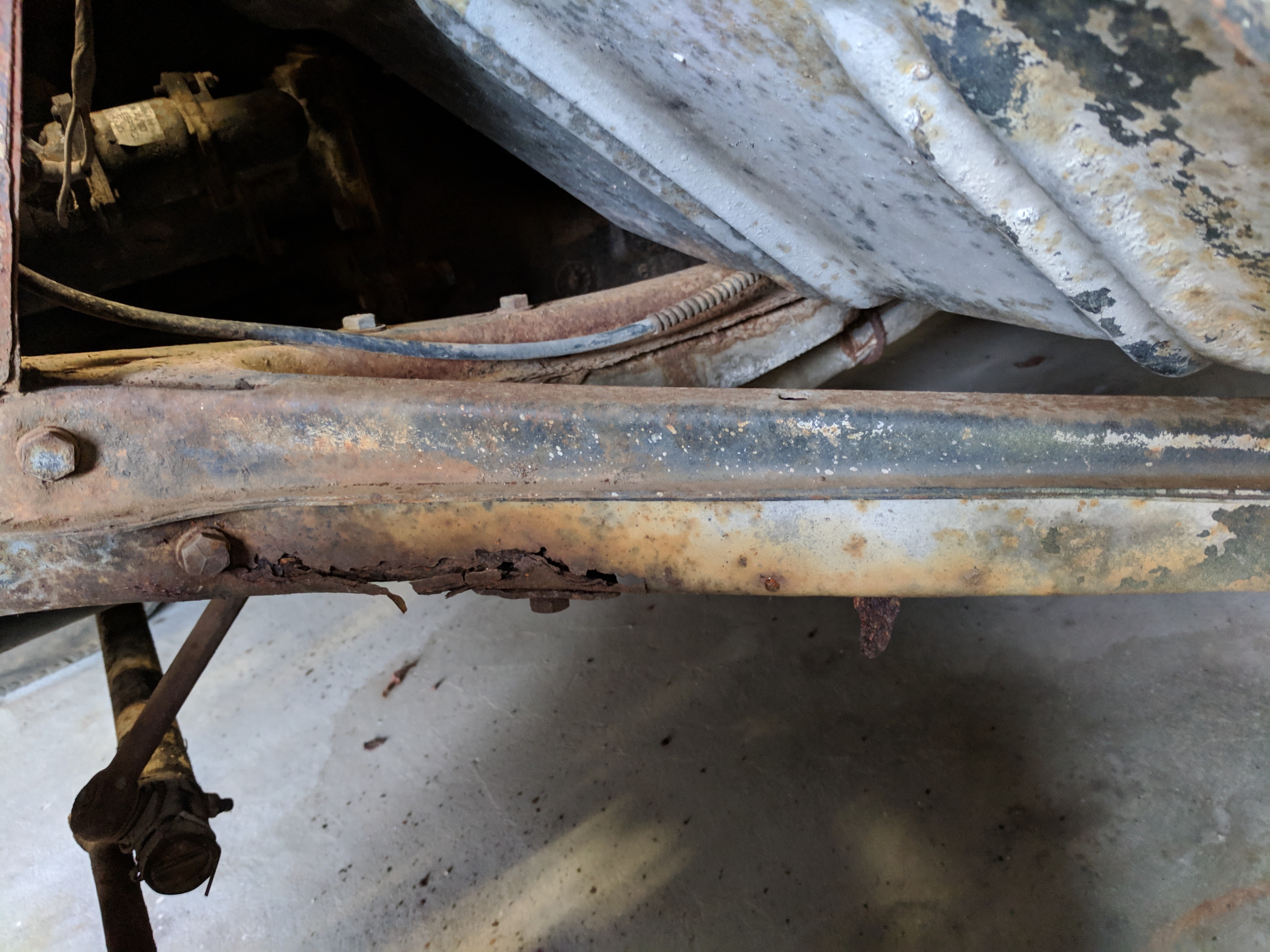

Astute observers may notice there are a few things awry. Like there was no outer sill. A few more photos showed a mixed bag of the good the bad and the ugly.

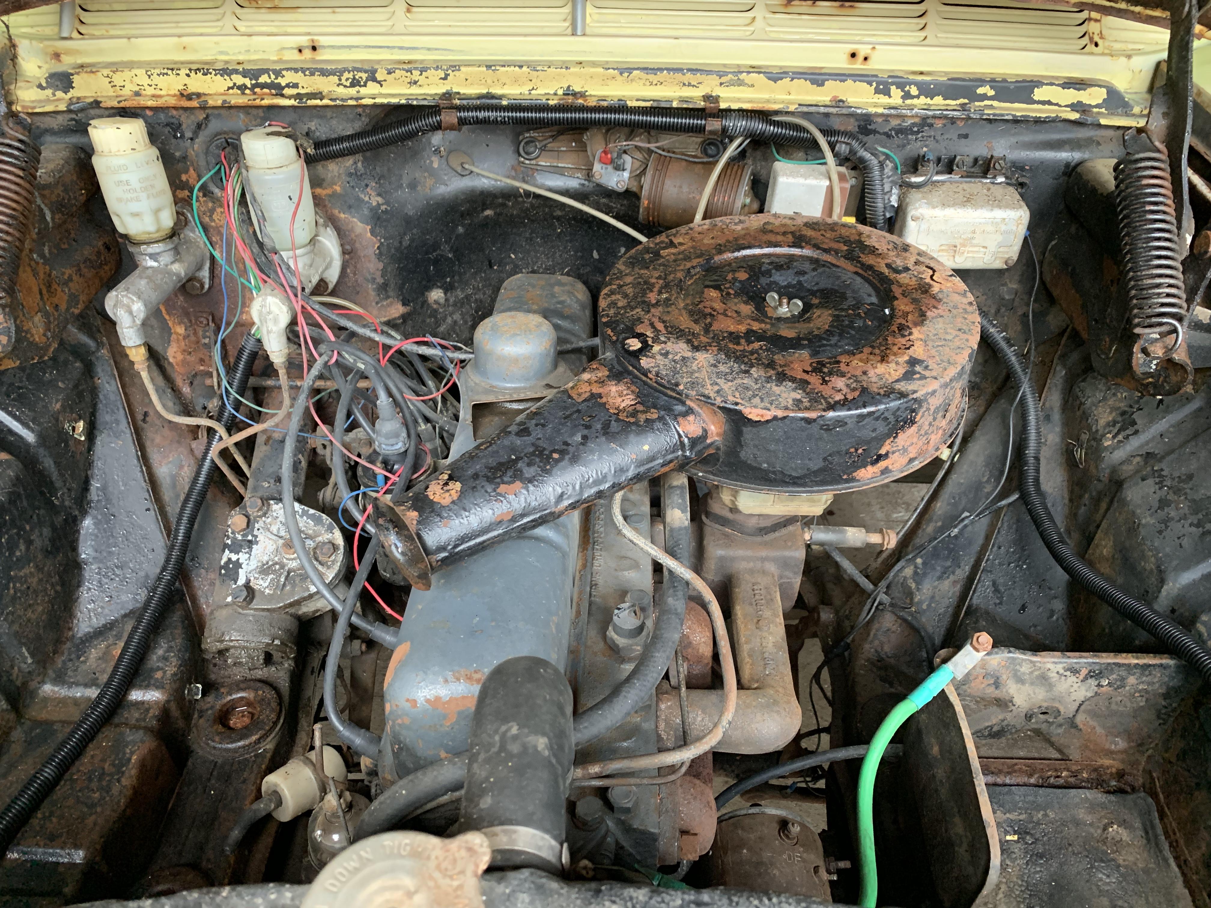

There was an engine. A mighty grey. A Repco reconditioned motor that had done 12k miles.

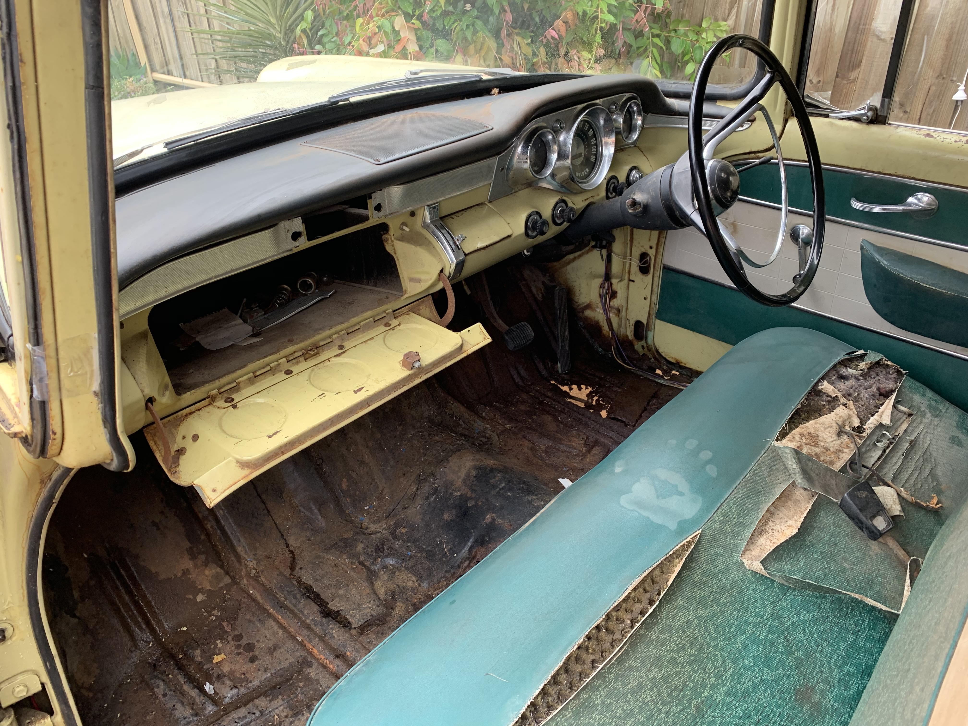

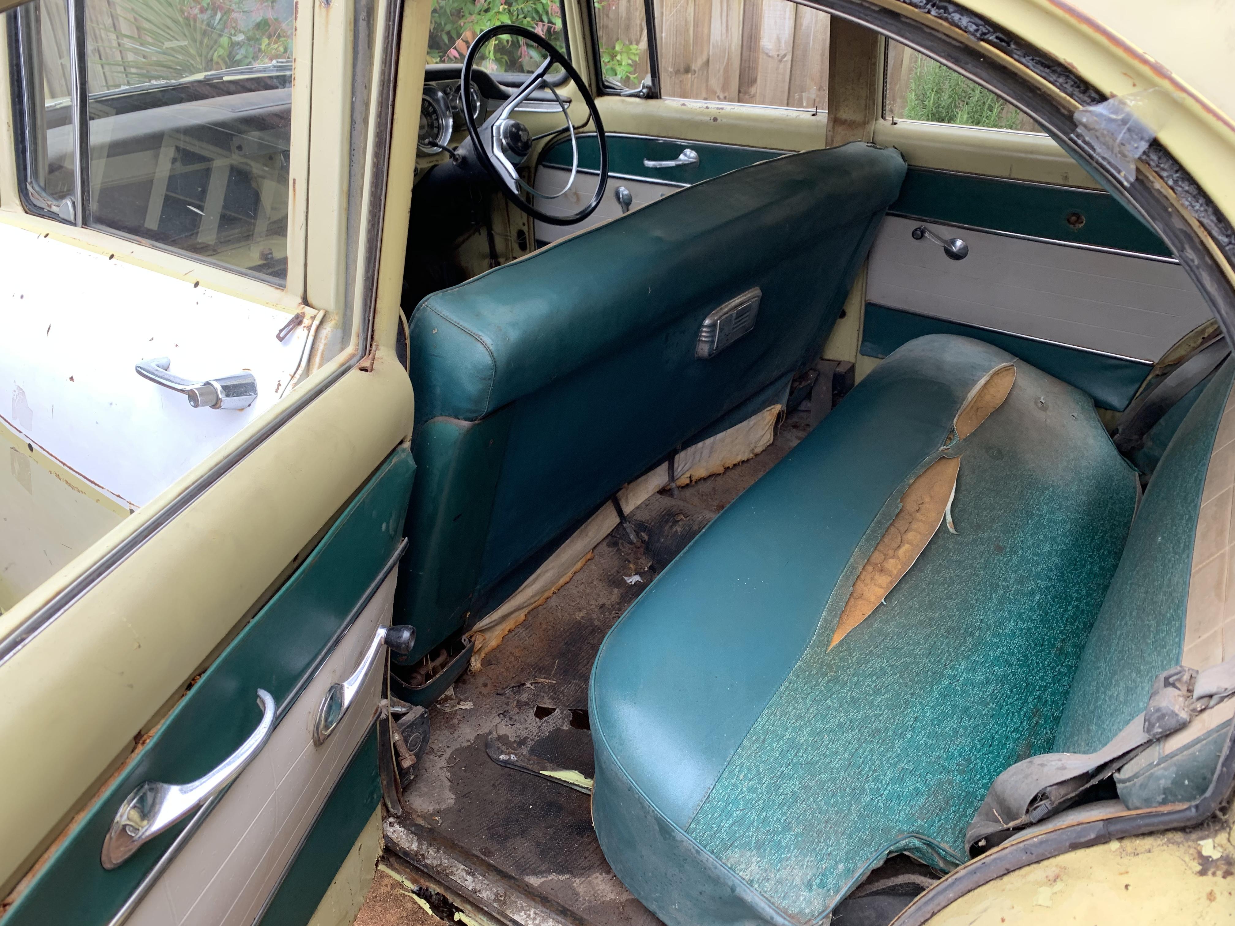

There was a complete interior that gave me confidence that this was going to be straightforward enough. Many years ago I had restored an EH Premier (never got over the tan leather bucket seats and the centre consol), a HR Special ( well, not really that special), a 1928 Chev. Businessman's Roadster, and the one I most regret letting go now, an LJ GTR that I bought for $500 when it was 3 years old 'cause it had had a minor disagreement with a power pole. That GTR ran some amazing times between Richmond and Forbes that are best not remembered now I s'pose. Oh, I forgot the British Racing Green MGB Mk1. Anyway, I've had the good fortune to muck about fixing up cars in my younger days. To set the scene a little but more, I worked occasionally for a panel beater to help pay my way through uni in the late 70s and early eighties (the Chev and Torana benefited from that access at the time. I've still got those tools and even some wet and dry.
Anyway back to Wilma. Kate instantly christened her Wilma when she opened the back door and could see a lot of driveway. Wilma as in the Flintstones having no floor feet powered cars. It seemed appropriate.

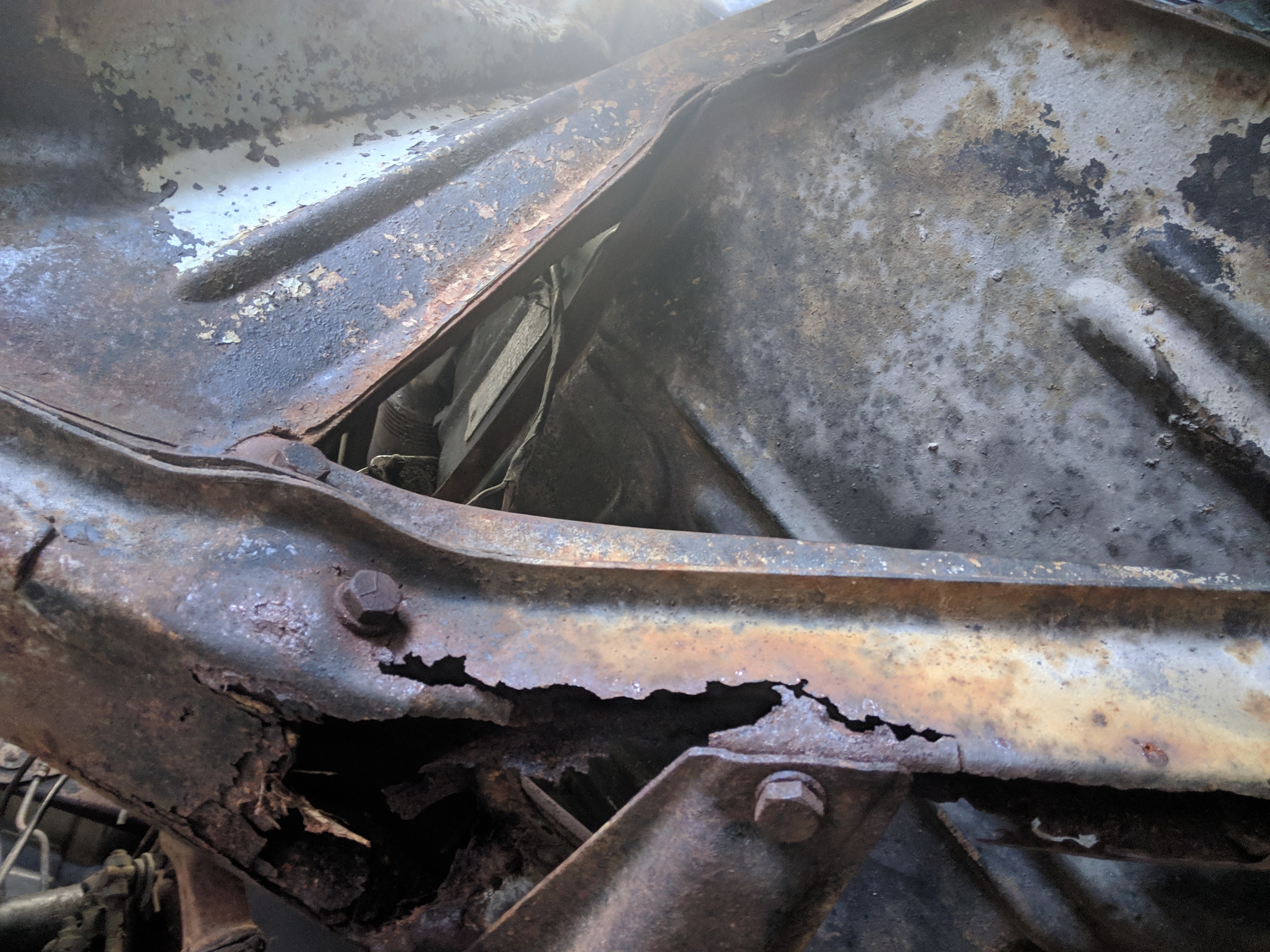

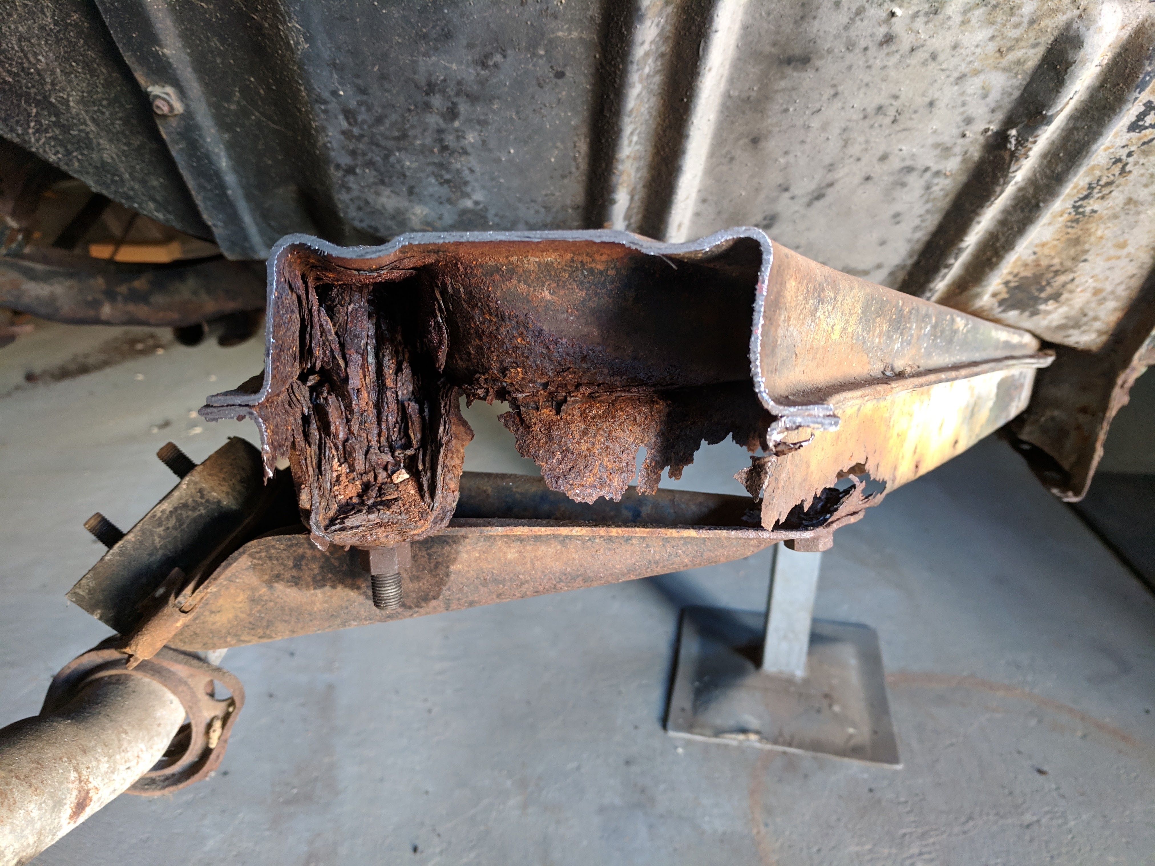

I was bloody lucky the engine didn't stay in the paddock! It was at this time I discovered that early Holden's have issues with what this Forum describes as the 'K Frame'. As I stripped bits off Wilma, I discovered that life for the next little while was going to be all about rust, cutting, grinding and welding.

So began a relationship with Rare Spares that continues to this day and is mutually beneficial. I quickly worked out that a full set of arms and cross pieces was not going to solve a big hungry space under the battery tray, and numerous gaps where the firewall connects. Thus began a short but productive relationship with Flynn's wrecking yard at Cooma. I've never had to pay to walk through a wrecking yard before, and a less than energetic vendor promised me that even if I found a good K frame, he may not be inclined to sell it. I had not previously encountered such enthusiasm for a sale, but paid my $10 bucks and went for a stroll. My mission was to find a good frame that was on a car that was already cut up and not complete. Fortunately a cute little EK hydramatic with no rear end exposed herself to me and after much negotiation and cajoling it was agreed that if they could find the time, I may be able to pick it up in 2 weeks. Lucky for me I did.

Good on you. About time Brett. Steering wheel and horn bar look complete, so that’s good. That’s about the worst subframe rust I remember seeing. Have you got the side flash chrome and what’s the plan for the interior? Will you try and source the fleck vinyl?

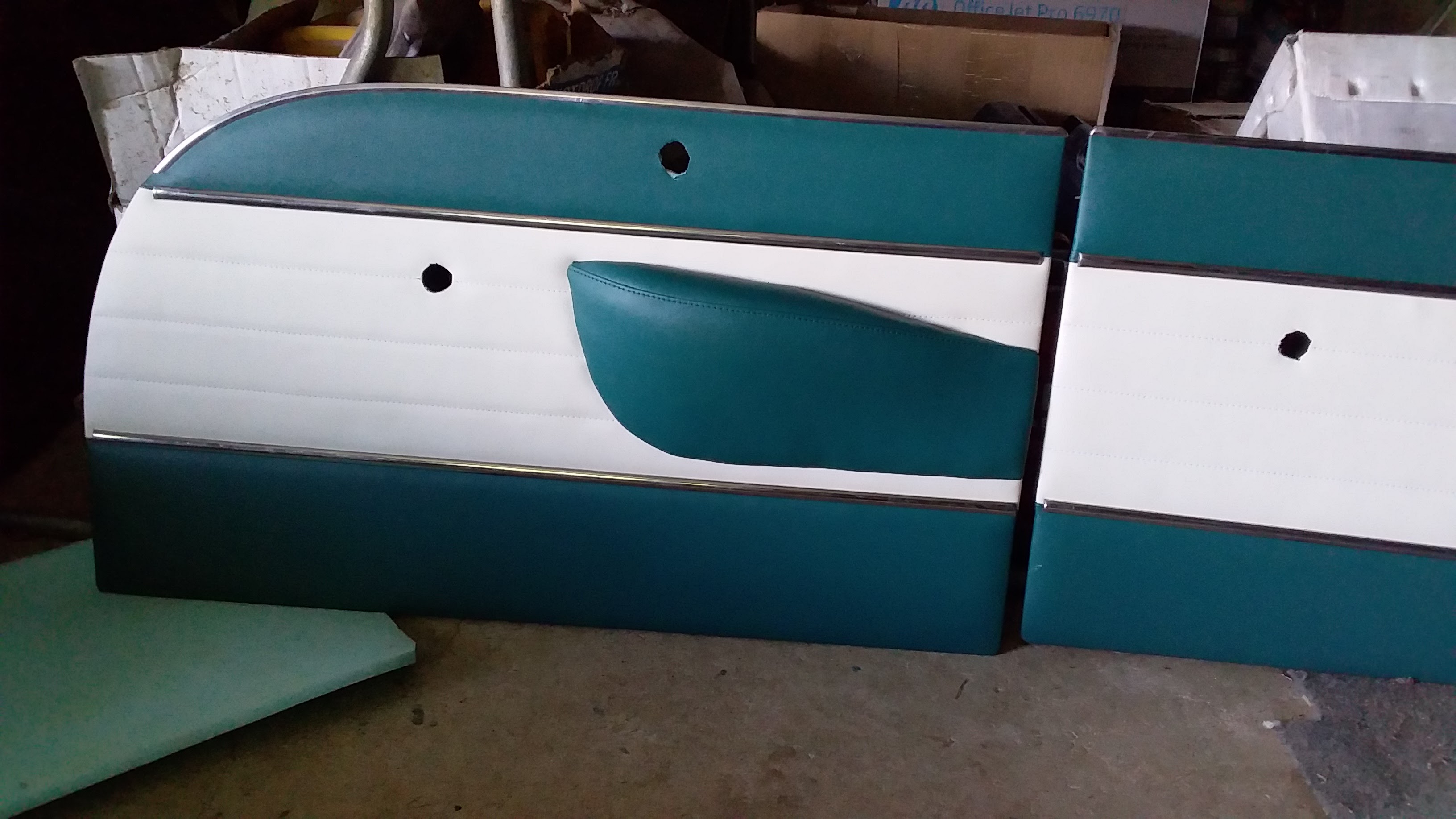

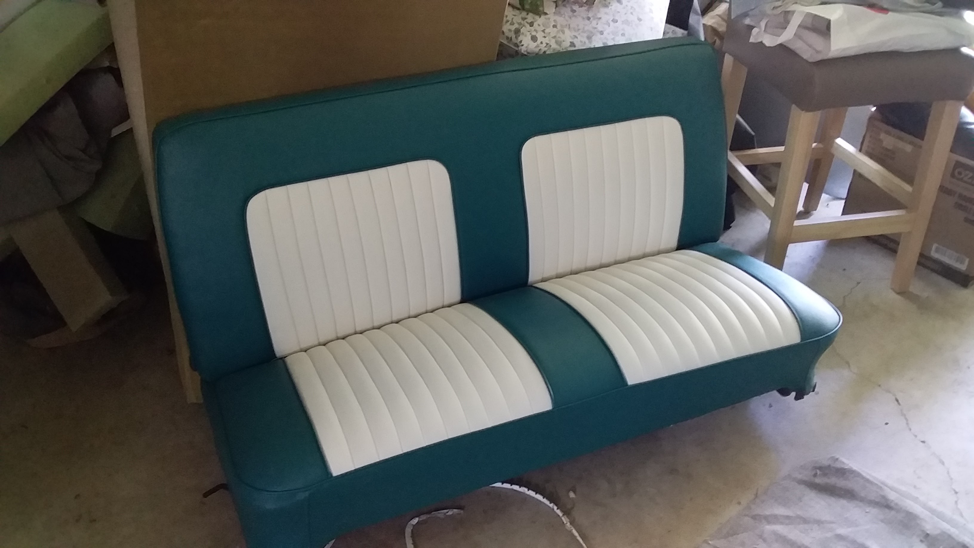

Hi Clay. I have all the trim. Car came with it pretty much but sourced better bits from all over the country! I Don't have the patience to deal with SMS so got a trimmer in Calalla Bay (Peter Woodlands) to do the seats and door trims. I also have Project 2 upholstery done but car itself is years away! I like to have stuff sitting ready.

Re: Wilma FB project
Upholstery looks very good. Yes I’m not patient enough for SMS either. I like the fleck vinyl but not a huge fan of FB upholstery styling. Whereas the EK styling really does it for me. I like the tuck and roll also, featured in FC.
