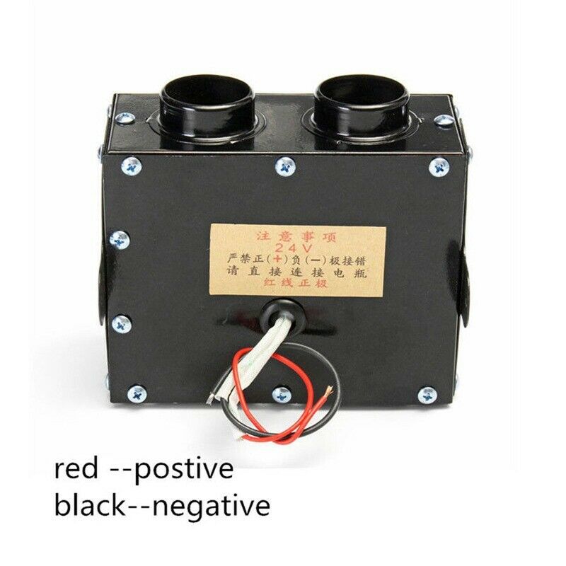

I need the ducting so that I can fit the little electric demister that I have purchased 12v 600W 40mm outlets, picked up some PHD-40ML from Repco yesterday they had to sorts 40ML and 40MS so I assume by the look of them that 40ML the L stands for Long and the MS S stands for short :wtf:
Demister
I've popped the switch out and extended the wires so that I can remote the switch.

That is a very compact heater you've got there. What size cables are you running for that given it is rated at a whopping 600 watts? That is some serious current draw.

600 W !!! That's 50 Amps @ 12 V.
You'll need an extra alternator just to run the heater element.

Dr Terry wrote: Wed May 29, 2019 10:24 am 600 W !!! That's 50 Amps @ 12 V.
Dr Terry
Yep, that was my calculation too, plus the wee current drawn drawn by the fan.

His v6 alternator is 85a factory

Thanks for the concern guys :thumbsup: but I don't believe it is 600W really have a look at the size of the cables coming out of it :esurprised: :wtf:
It appears to have 2 small computer fans in it and not sure of the heater elements.
Because its chinese i tested it as soon as I got it by just holding the cales against a spare battery terminals and it seemed to go ok however me being a grease monkey and not an electricians a hole may mean I am totally wrong.
I know one of the photos says 24v but the one I received is 12v as I stipulated when ordering.

Looks like a neat solution to pass rego Neil. Would be nice if you could switch between windscreen and floor.
