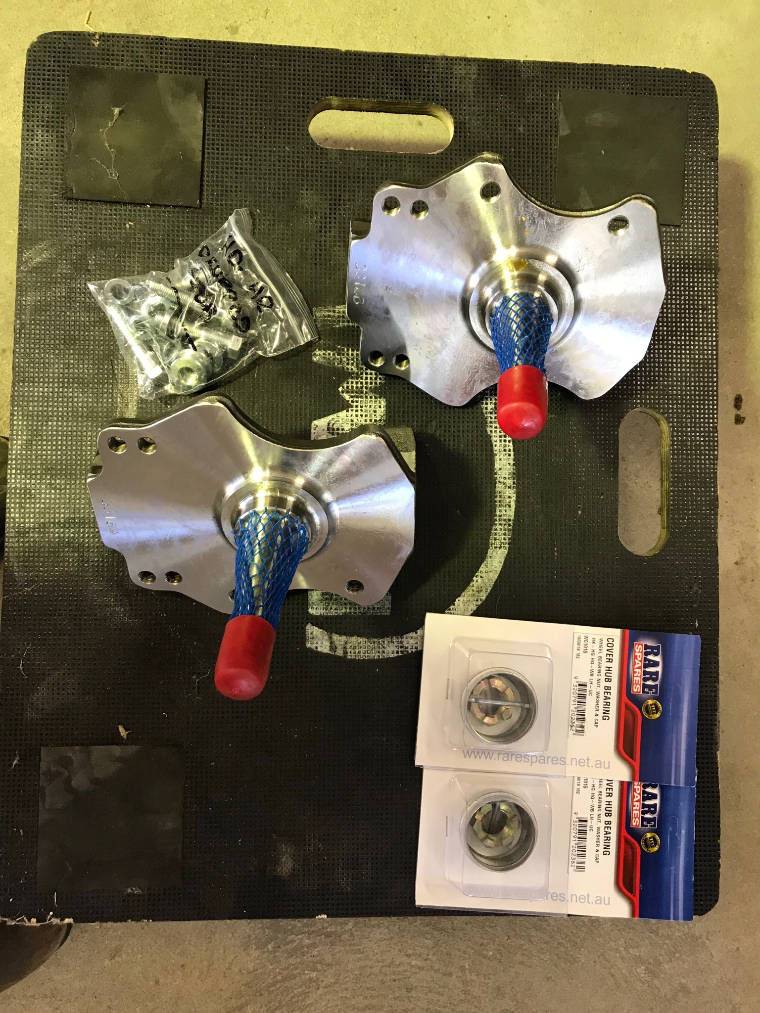

I've wanted to drop the front of the Ute down a bit more, looked at Castlemaine Rod Shop drop spindles a month or so ago and the price was $800 went on a couple of weeks ago and the price was $500 and beside the price was quantity 1 so of course I assumed it was $1000 for the pair.
Decided to bite the bullet last Monday (4th) and rang to order them when I asked the guy to confirm that it was $1000 he said no mate $500 & 55 delivery so was very happy and jumped on them they were sent by TNT and arrived yesterday, came with new grease caps castellated nuts and split pins and caliper bolts.
Posts: 11631
Re: Neils Frankenstein Ute
Good work mate. The dropped spindles make sense. Pity it’s not so simple to dump the rear without chassis work. You’re doing HQ brakes if I recall or are they Commodore. I guess the stubs would work with other combos. The logical choice seems to be chose your rear axle and base the front hubs on the same stud pattern.
Keep ticking those boxes Neil.
