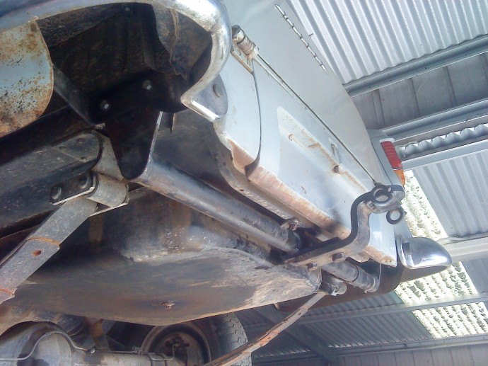

Firstly, here is a pic of how my shackles were before I started:
Shackle down.JPG (79.18 KiB) Viewed 4768 times

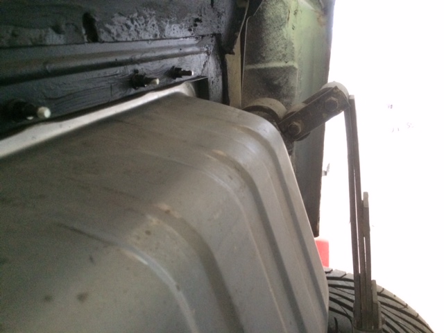

I proceeded to flip the shackle and the second leaf caught underneath the shackle as pictured. i'm not a terribly bright spark, but I did figure this was wrong.
First flip shackle.JPG (80.66 KiB) Viewed 4768 times
So after a lot of swearing, jacking, pulling and banging - not necessarily in that order - I managed to get the second leaf inside the shackle.;
Final shackle.JPG (80.57 KiB) Viewed 4768 times

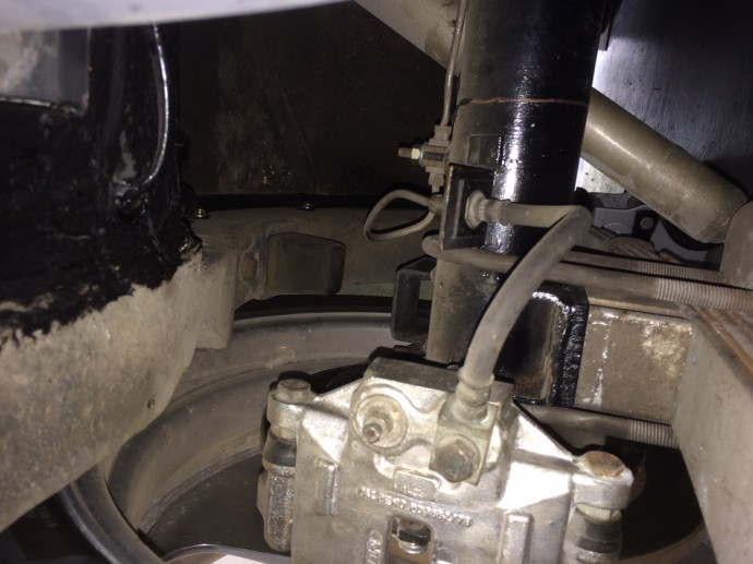

Apart from the HJ diff, I also have bigger disc brake calipers fitted and because of the width of the caliper, i have to use lowering blocks to clear it from the spring. Hoping none of this is why the longer springs were fitted in the first place but I can't see that being the issue.
Lowering blocks to lower and clear calipers
Lower blocks.JPG (76.3 KiB) Viewed 4738 times
