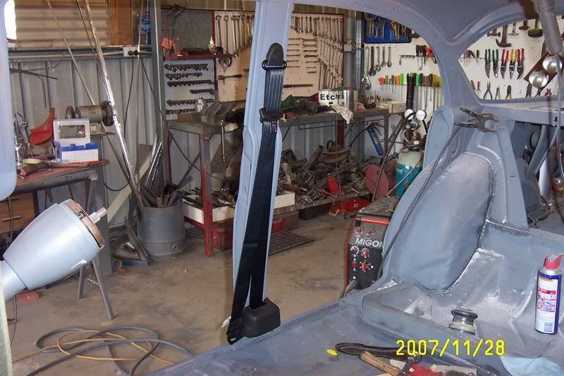

Currently to break the monotony of doing bodywork :roll: , Ive
started fitting the seatbelts so as earlier promised some pictures
of how Ive done it. Maybe this is not the right way of doing it
or the easiest way but it worked for me.

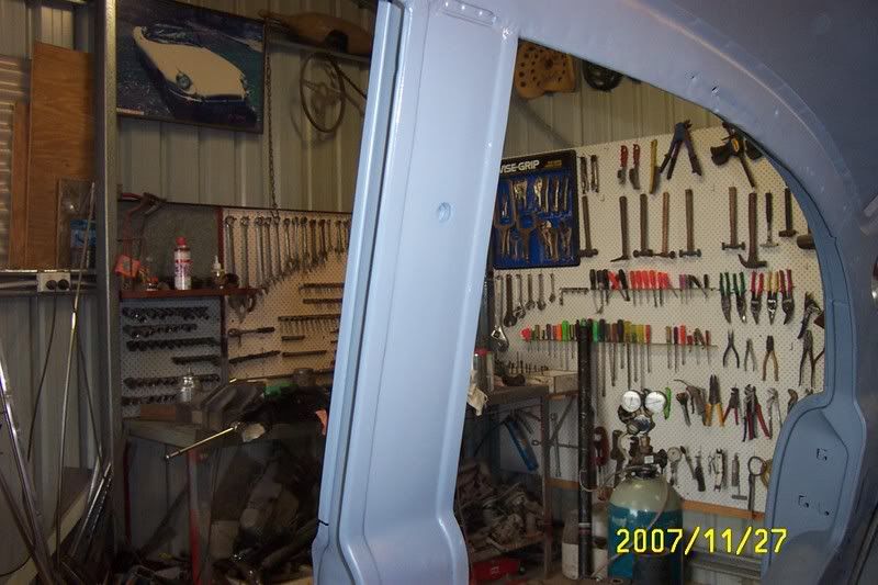

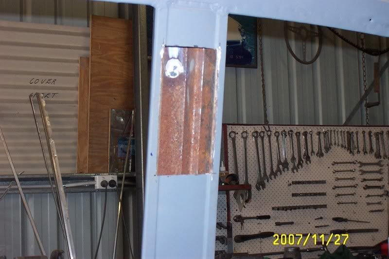

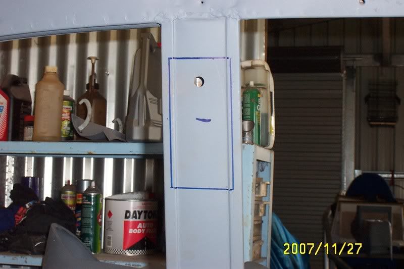

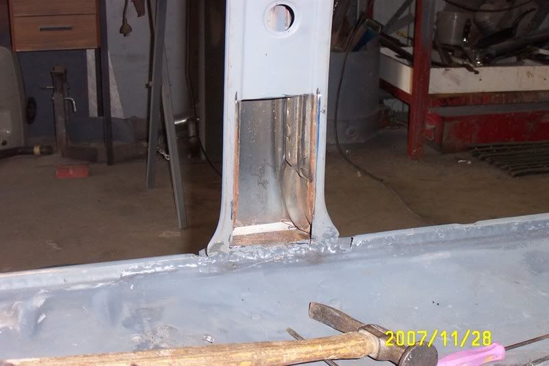

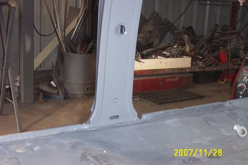

Firstly I marked out the section to be removed for the reinforcing
to go in. As the car had already had seatbelts fitted those holes
(right through the pillar) had to be welded up.
Then neatly cut out the section with very thin cutting wheel

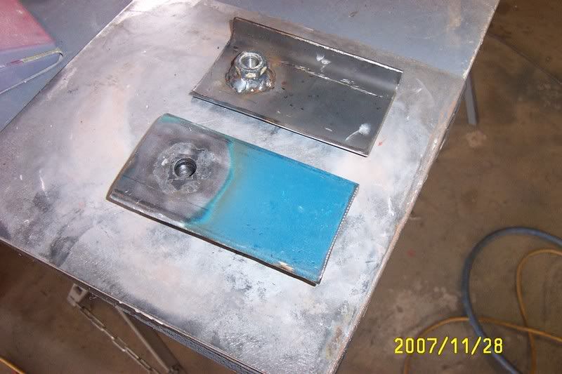

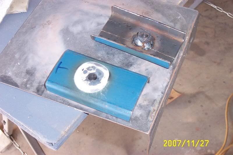

Then made the insert reinforcing out of 3mm box section cut down
the middle so as to get two pieces out of the one piece. Mark where
the bolt is going to go through, drill the hole and weld a nut onto the
back of the reinforcing section

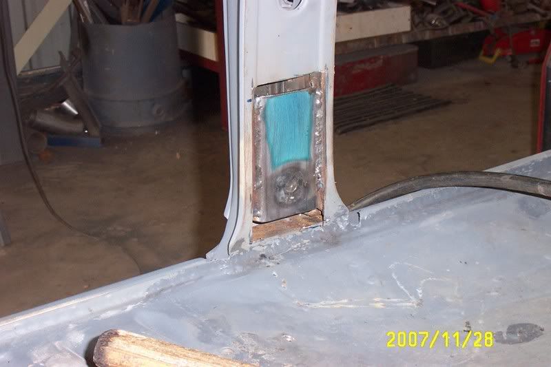

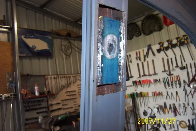

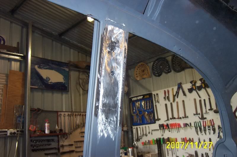

Then after several trial fittings, weld the section in
Then using the original section that was cut out, weld it back in

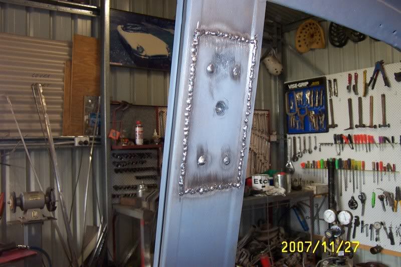

Grind up the welds & finish off
Then just do the same process on the lower of the pillar
And finally the finished product
Then do the other side the same. Just a tip when you make the
reinforcing pieces do both sides at the same time so when you
do the other side it doesn't take as long.
Malcolm W.

Cant get enough of pictures like that mal.Thats another example of the fine work were used to seeing from you.Good to see the workshop is nicely organised too.

I dont know what impresses me more,the quality of work you do on this car or that tool board i see in the background.Both have the work of a genius.

Hi Malcolm. Very nice work you would never guess they did not make them like that. Did the same to mine but smaller pieces.

Anthony, sorry I don't have any pictures of the rear belts done.
But they are also retractable, and I've mounted them on the
parcel shelf with the bolt going through the parcel shelf reinforcing.
The lower is just drilled through the floor with reinforcing plates
behind the bolts.

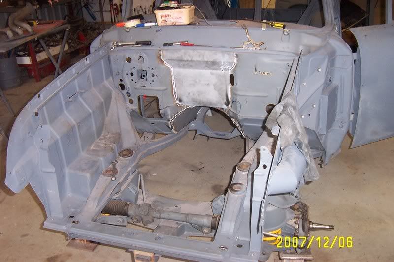

Just another quick update,
Today I got all the air con. hoses made and fitted up. The last job
before I started stripping it down.
Well when you look at the following photo's you might think, this
dickhead has got the photos in the wrong order :? . But rest assured
there not and yes, although you may not think so, this is progress
:wink: .
Firstly the diff, fuel tank and all the rear end bits removed

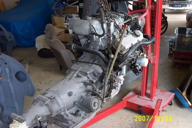

Then motor & gearbox out
Getting it out was a lot easier than putting it in

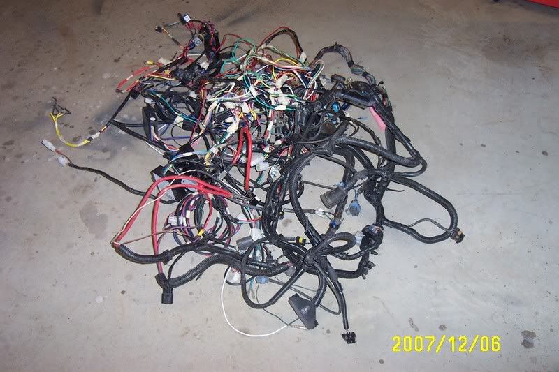

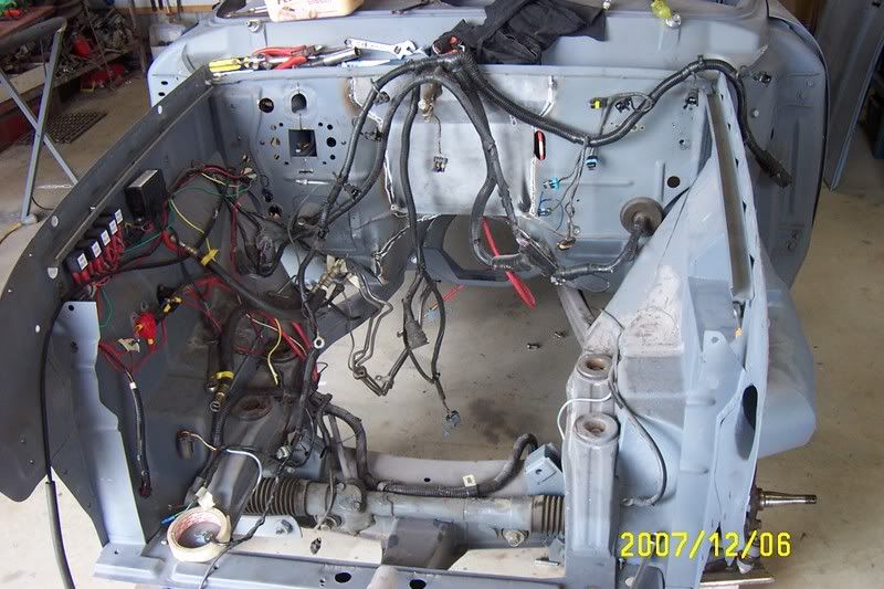

Then the fun started, getting the wiring out. :shock: I really hope I dont have a memory lapse

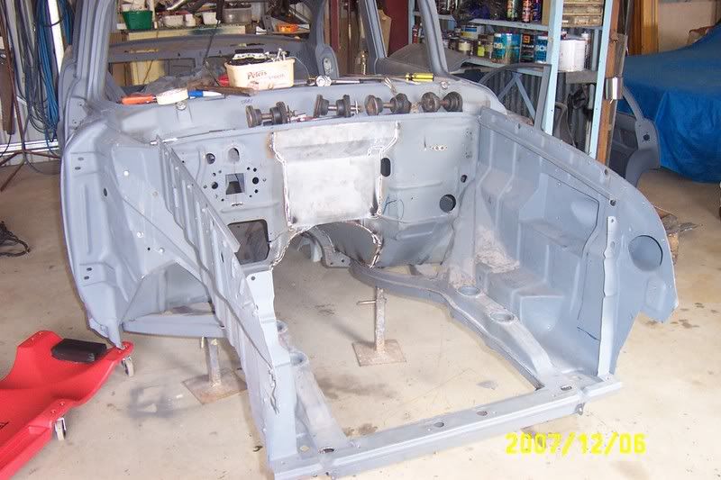

Front end out, again easy

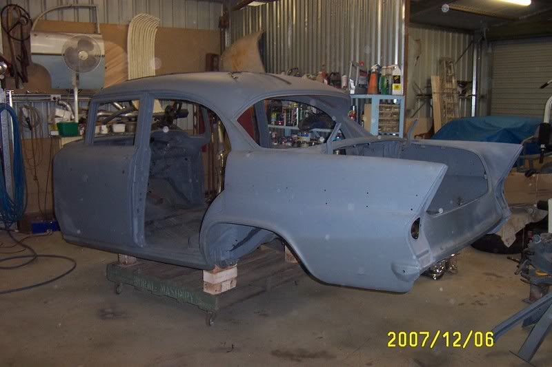

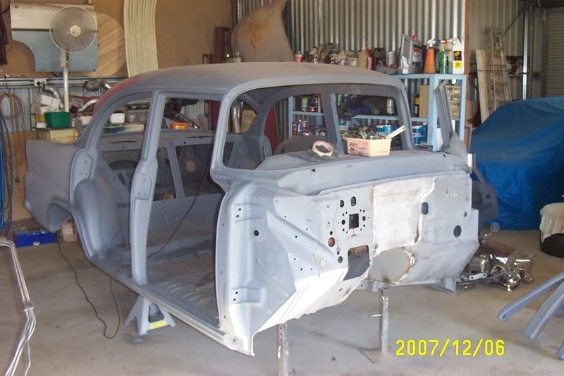

Then, its back to where I started, a shell sitting on a pellet
:x
Yes, I guess at the end of the day it is still progress. Still have a couple of panels to finish before I start puttying and painting.
