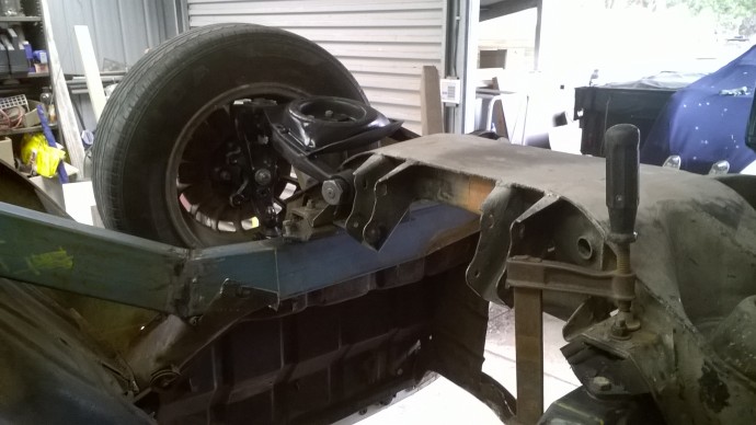

Thought I'd post a pic of work in play to allow front end completion old section was gone, will need to repair hole(s) under battery tray section next
Fabricating new rails for fitment of front end

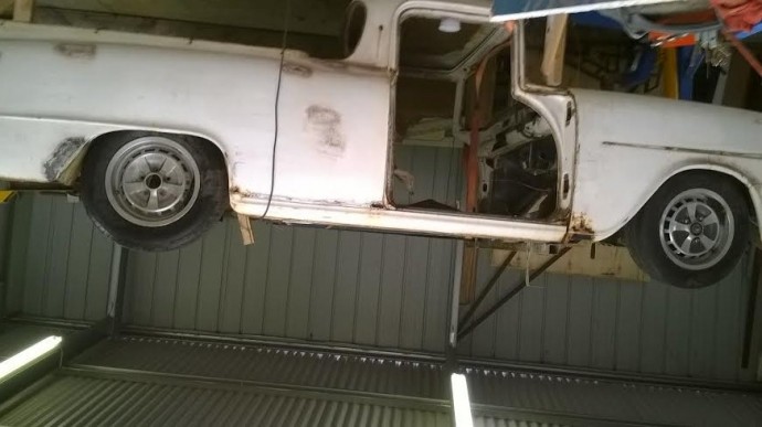

its been a while so i thought i'd add some pictures of progress... I've been a little time poor but at least things are starting to move a long a bit.

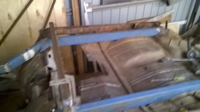

front end mounted awaiting spring and shocker set up

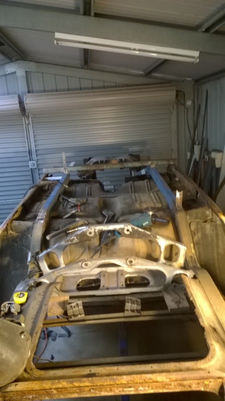

More pics.. note picture is inverted as car is upside down on the rotisserie...makes like easier when fitting front end an IRS rear end set up

setting out IRS cradle

Good to see some progress mate - how much do you need to narrow the Jag stuff to fit underneath ???

Post by 454ekute »
Narrowed XJS front end around 110mm used an E type rear and cage fits within the chassis rails just needs to be adapted to fit using factory mountings
