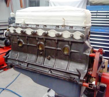

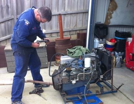

Finally got the engine running today! Was good to hear that note again..........hope the neighbours enjoyed it as much as I did. I did at least have a muffler on it.
Oil pressure turned out real good with the full flow system so that was sigh of relief. Timing gear was also nice and quiet (wasn't sure how this would go as many have just said to replace the cam gear only). I did both cam and crank and its good.
I ended up cutting open the oil filter after the run for a check. No dramas there but plan to check again after a few miles are done on the road. Rear main seal is ok; no drips but some minor misting from residue oil as the rope seal was soaked in oil for 3 weeks prior to fitting. Finished with taking off all the accessories and getting it ready for final paint.

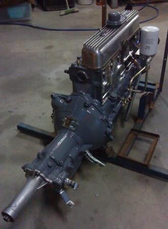

Busy, busy this week.

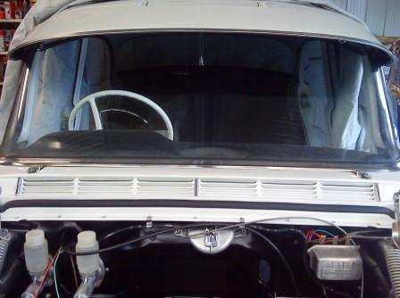

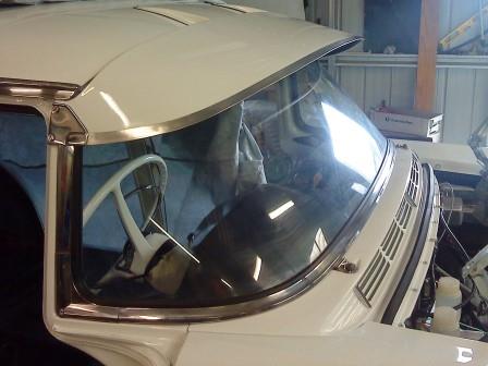

Sun visor done up and fitted. What a prick of a job! Had so much fun refitting the alloy strip i.e. with sealing it, reforming it back into shape, and polishing it, all with out doing damage to the visor paint work. Very slow and tedious (3 days :wtf:).

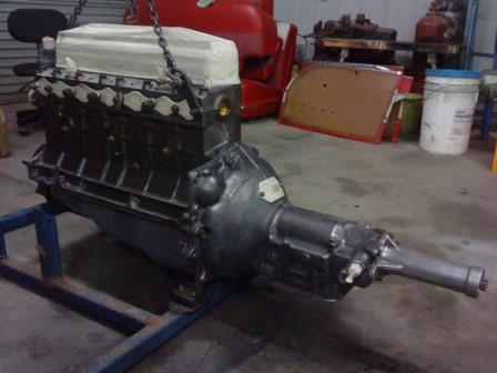

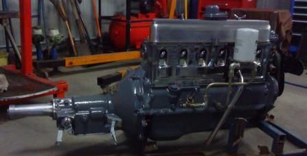

Engine now painted and partially fitted out.
WayneXG95
Posts: 2565
Post by WayneXG95 »
Mate, she's shaping up to be a beauty.... :thumbsup:
Have only taken the strip off and refitted once..........
Hi Tim,
so I think your saying you did it once and never again??? I maybe the same but I doubt it. The original visor looked ok after blasting as an assembly but once I took the strip off I found it totally stuffed with rust to the extent that I reckon the strip would have eventually fallen off at a later date if I left it. I ended up dumping the first visor and picked up a near new one up in Wodonga. I sealed the strip with mastic to prevent any water ingress that will cause rust under the strip. I think the two dissimilar metals and trapped moisture are most of the cause of the initial rust. Anyway I rant on............

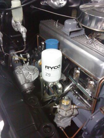

Craig Allardyce
Posts: 1568
Location: Stratford
Post by Craig Allardyce »

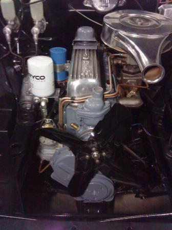

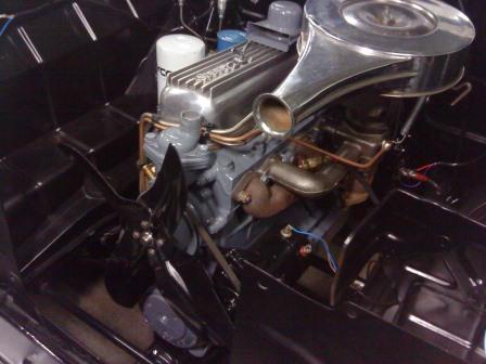

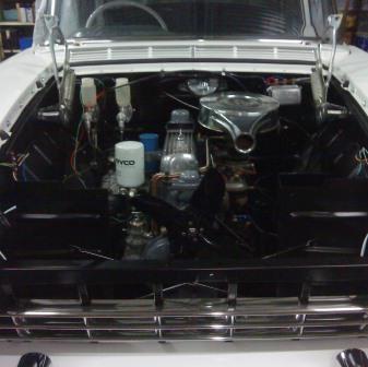

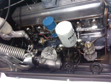

Well I've finally made a huge step today. Overhauled the fuel pump, starter, and generator, re-tubed fuel and vacuum lines, fitted engine and gearbox. I'm still running the Stromberg till the engine is run in then will be fitting the weber and headers after that.
Full flow filter mounting and lines worked out well with good clearance all round. Now I'm finally starting to feel like I might make my deadline. :) :D
