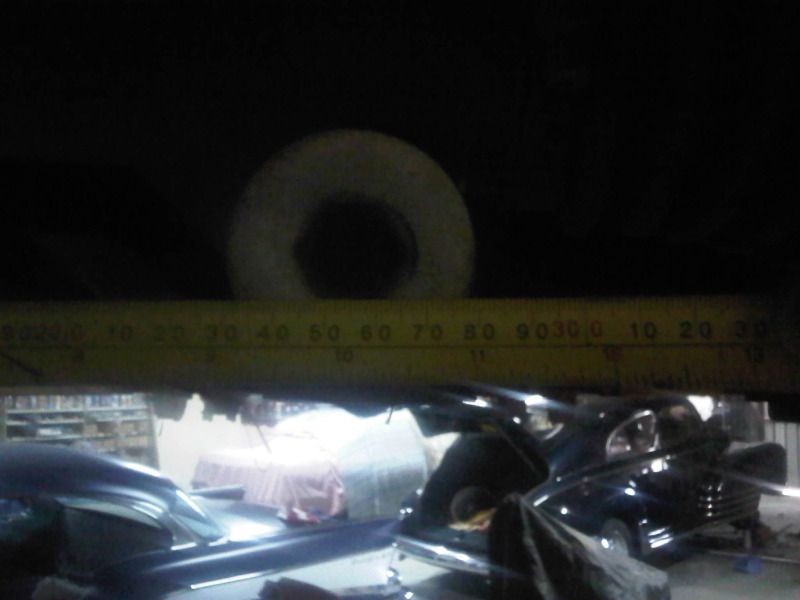

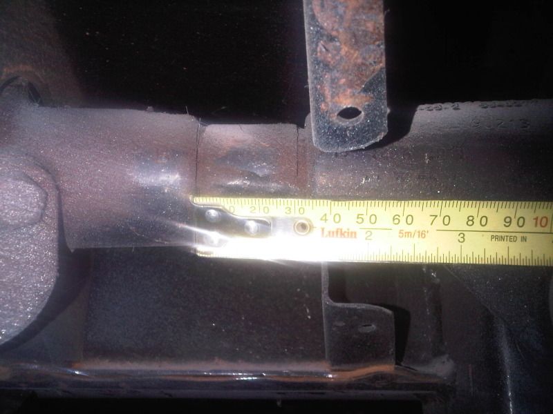

Rack length is as per pics - I couldnt measure it how you wanted because its on the hoist and they are on a fair angle ( and I was too lazy to unbolt them)
35mm between castings
255mm between centres of mounting bolts
HTH
