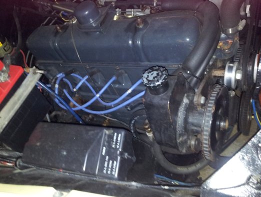

choppedfan
Posts: 532
Location: Riverina
Re: A/C Compressor
Post by choppedfan »
Mate here is a grey set up with air con & power steering, air con compressor is under the alternator, maybe you could mount the compressor where the power steering is on this one. :thumbsup: :thumbsup:
Mick 8)
choppedfan
Posts: 532
Location: Riverina
Re: A/C Compressor
OOoooppps, just reread your original posting about mounting it down low, looks like its under the alternator then :oops:
