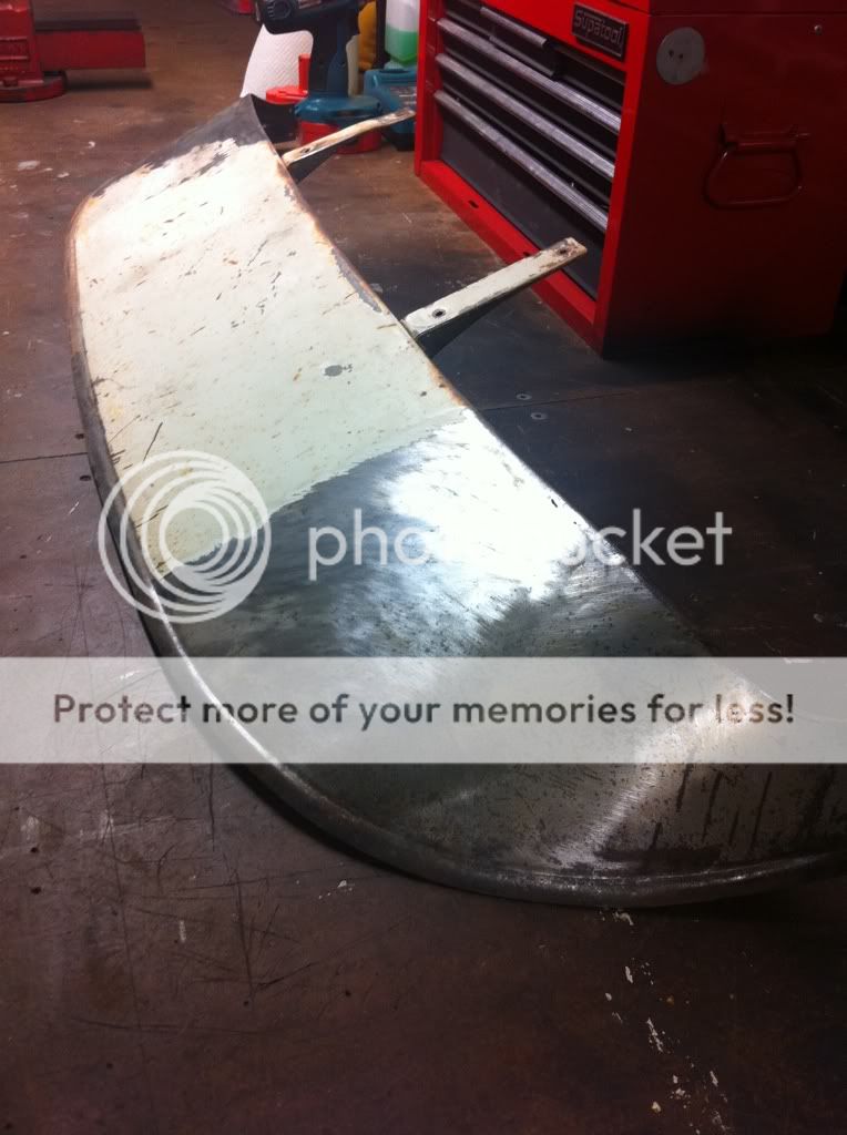

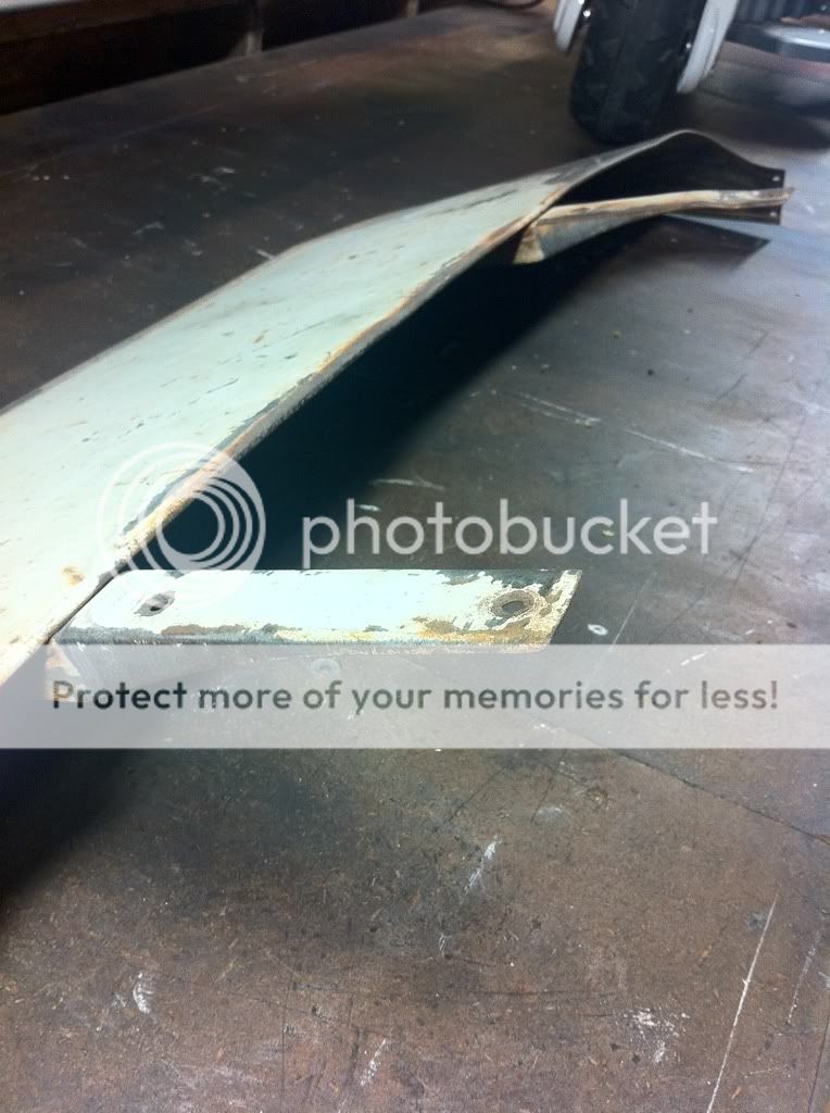

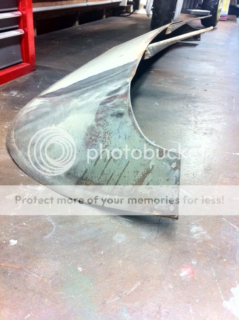

picked up a sun visor for the ute... but not sure what it is off... been told fb/ek...
it is solid... two brackets onto the roof...

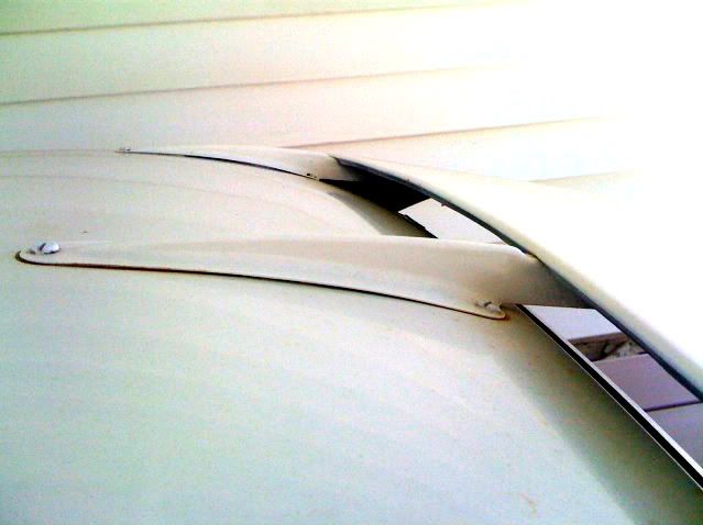

questions...do you need the chrome brackets to mount ?
has anyone got any close up pics of their visor so i can check mounting.. and style ?
any tips on install would be great... cheers.. stu

sorted. no brackets it is. thanks mick.
next is what to fix it to the a pillar with and also roof.
read something about nutserts for pillars, what about roof?

Yeah, Nutserts all round for me too!
Also used them for my roof rack, Speaker panels, Heater bracket.
Work a treat, But the tool cost an arm and leg!
