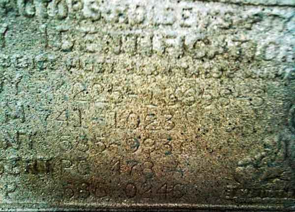

Hi Guys,
I have just found a pic I had stored away of the id plate on the EK.
It is probably the worst one on here but would love some info if you can read it!
Craig
Plate
Plate

I'll have a crack
Body EK 225 13658S
Trim 741 1023
Paint 585 9931
Insert PO 478A
Top 585 0246
So EK Special Hydramatic
Twilight Turquoise with Snowcrest lid http://gallery.oldholden.com/Mr_Jones/F ... Turquoise/
Mosaic & Jewel Turquoise trim http://gallery.oldholden.com/Mr_Jones/F ... +Bolsters/
Hopefully I have all the numbers correct

I reckon you've got it Leroy. The interior is definitely that colour and pattern.
Which part of the plate designates that it is a hydramatic?
Thanks for the info!
Craig

The insert line has PO 478A, I'm fairly sure the way it works is
PO = Production Option
478 = Hydramatic
A = Special
Leroy
