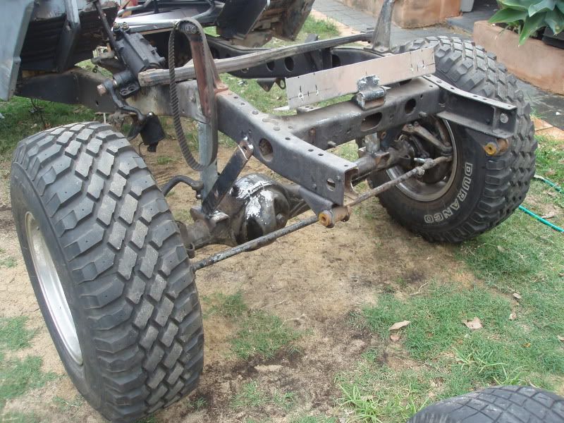

hi all,
I've got some pics of a car I'm building- It's been off the road about ten years now and I'm getting stuck into finishing her off. I've had her since I was 18 and it's kind of turned into grandpa's axe-7 heads and 14 handles but I can't part with it! My brother calls it the anti-christ!
I'm fitting 80 series control arms front and rear and using coil overs

is that a 40 front diff or a 60 series :?:
and are you gonna use that diff and hy steer or a double flipped arm for steering :?:
or just go complete 80 diffs.

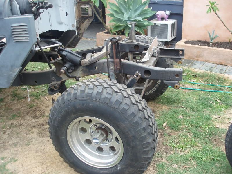

Thanks for the positive comments guys, It's a hilux diff in the front,I'm using complete hilux steering from diff to steering wheel- the hilux diff itself isn't the strongest but it allows me to set up everything (and make sure it's all going to work!) and when I bust that diff I can go 9 inch(I have a 9 inch for the rear). If I'm careful where I mount the steering box I hopefully won't need any after market hi-steer gear.
An interesting note though, hilux disc rotors are the same dia. as hq/z and they have factory twin piston calipers... I'm still yet to try and fit the calipers onto the stubs, If it works I'll post some pics

xxl wrote:Thanks for the positive comments guys, It's a hilux diff in the front,I'm using complete hilux steering from diff to steering wheel- the hilux diff itself isn't the strongest but it allows me to set up everything (and make sure it's all going to work!) and when I bust that diff I can go 9 inch(I have a 9 inch for the rear). If I'm careful where I mount the steering box I hopefully won't need any after market hi-steer gear.
Hilux fronts are just as strong as 80 series, same 8 inch crown wheel, just reverse cut. the only weak point are the cv's which are the same as 40 and 60 series. I ran 38.5 inch tyres on a Hilux are didn't break alot of crown wheel and pinions.

Post by xxl »
Don't get me wrong, I know they are pretty tough- It's more of a case of 'expect the worst-hope for the best' . :lol: :D
