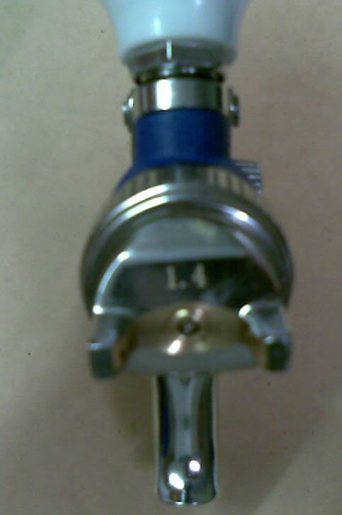

I have a HVLP (High Volume Low Pressure) Gravity Feed spray gun, but I haven't used it up until now.
It has a 1.4mm nozzle, but my other gun has a 2.0mm nozzle.
Will this make any difference to what I can spray with it ? :? :?
I was looking to use it to paint the roof.
Initially in White and then in Silver.

The HVLP gun I have has four fan holes in the "wings" (for pattern) and five holes each side of the needle orifice (for atomisation) I note that the pic of yours does not seem to show that many.......

Used the 1.4mm today with a White Acrylic.
1 paint to 1.5 thinners.
Seemed to work OK.
Adjustments on the gun were very easy. :D
Much easier than the suction gun. 8)
Anyhow, it just seemed to lack a bit of "power" ?
Paint flow was good and had more issues to getting along from front to back of the car in one run, than with the actual gun.
Not sure if it would perform once it had some pearl or metallic in it ?
I think it would need a larger nozzle.
I just thought for the roof it would be better as the cup is on the top and not underneath, like on the Siphon gun.
That way I could get closer to the roof without hitting it with the paint cup. :cry: :cry:
I will still try it with the silver on the roof, but will go back to the other gun if I find any issues.
