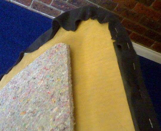

I had a small section missing.
I reattached the areas that had dropped down using contact adhesive.
But I also had a small section missing.
I thought I would grab some from the parts car to re-use.
Unfortunately it was badly eroded and fell apart as I removed it.
Then going to use some from a parts commodore roof.
It had similar insulation to floor insulation.
But it had already been taken. This is what it should have looked like.
Probably end up using dynamat.
