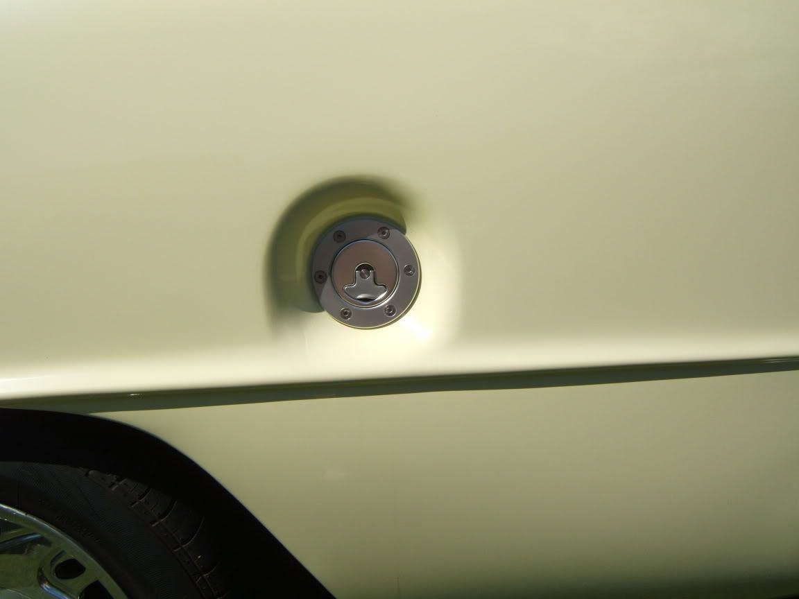

Fuel cap

very schmick looking ute! i am particularly interested in the fuel filler cap you have used, i have been looking at one from Earl's which has an outside diameter of 95mm (areo 300) is this what you used ? as it looks like it fits perfectly into the hole which is what i was hoping it would do.
they also come with the unleaded restrictor, locking cap and don't leak like all other ek caps i've had in the past :)
any info you can provide would be appreciated.

Gidday Sammy,
The cap is one of Earls can't remember which model- verrry expensive but a great product.
Had to cut internal lip from body and widen hole slightly then flatten mounting surface.
Try a motorcycle wrecker for similar cap!

thanks for the info, i havew had a rough measure of the earls ones and i thought it would be the go, the price doesn't worry me too much ($300 i think it was) but i need its features, locking, unleaded restrictor, and the hose fitting size .... anyways i wont hi-jack your thread.
