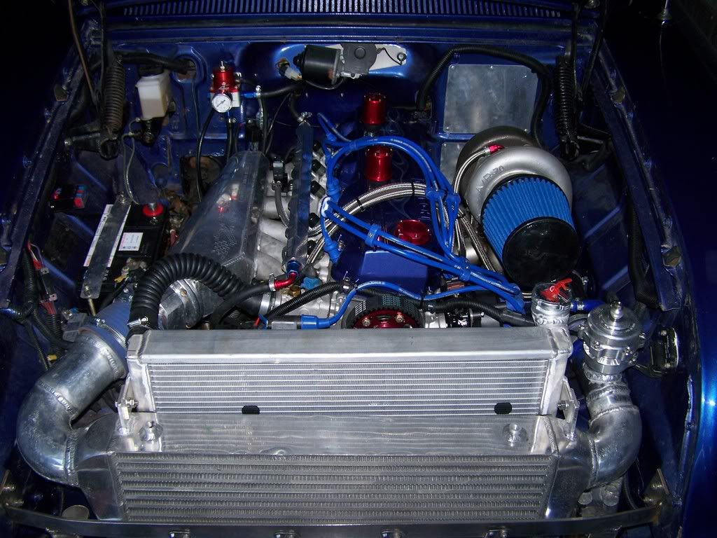

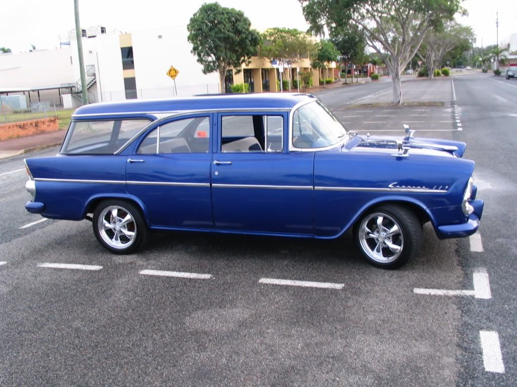

holy crap it worked...sorry bout the size, 1 thing learned at a time :D , now has a megashifter transbraked c4,drop tank(hidden from rear view mostly) and a few other gauges in it.

Tell me all about it!
Which sump did you use?
What diff do you have in it?
Any problems encountered?
ECU?
Manifolds?
I am in love!!!!!!!!!!!!!!!!!!!!!!!!!!!!!!!!!!!!!!!!!!!!!!!!!!!!!!!!!!!!!!!!!!!!!!!!!!!!!!!!!!!!!!!!!!!!

Which sump did you use? vl top good ol 202 hump
What diff do you have in it? vp v8 lsd
Any problems encountered? it all started when i had the idea...it went downhill from there
ECU? e6x haltech
Manifolds? cpc inlet and custom stainless exhaust manifolds
big injectors,35/40 turbo, billet pistons,forged rods,blueprinted an balanced, volvo R&P(yup volvo)just put rollers and solids in it. Looking for some decent 1/4 times. the list of bits is insane for one of these. I used to race a blown big block...I think it cost me less than this lol.

Posts: 2694
Geez,
There's not much room there now. I was almost going to say you should have moved the battery to the boot!!!!!!!!!!!!!
Looks good and quick I bet.

I do like that colour............ 8) 8) 8) 8)
Yes, a lot more info and pics ????????
What size wheels ? What are the wheels sitting on ?

I think the wheels are 17" speedy Malibu'
