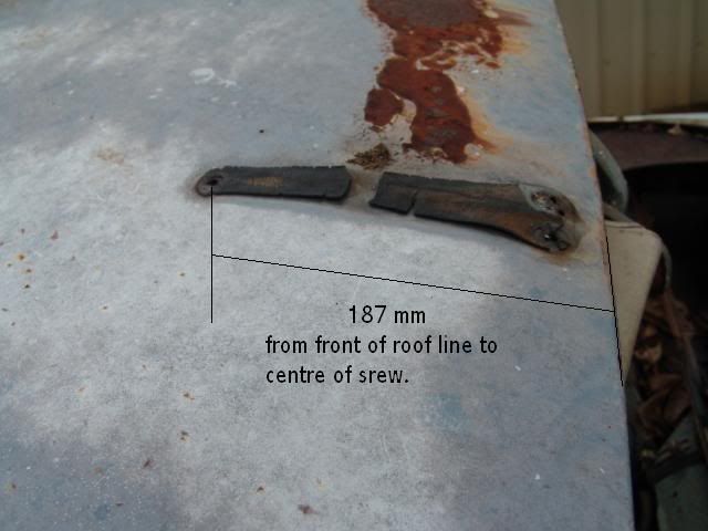

Hi Adam,
Just saw your post so I quickly took a photo of the visor position (the car the brackets came off).
Center it on the car and mark the rear holes (make sure the brackets are parallel with the centreline of the car. The visor is fixed to the roof and the A pillars with self tappers (As RB suggested), I didn't sent the screws 'cause they were pretty crappy looking. There was also a rubber gasket under them (also crappy as you can see in the pic).
Just notice I wrote "srew" on the photo instead of "screw"....... this will very helpful if you have a fury little "srew" on the roof :lol: :lol:

thanks for the info v8ek4us, will be helpful!
