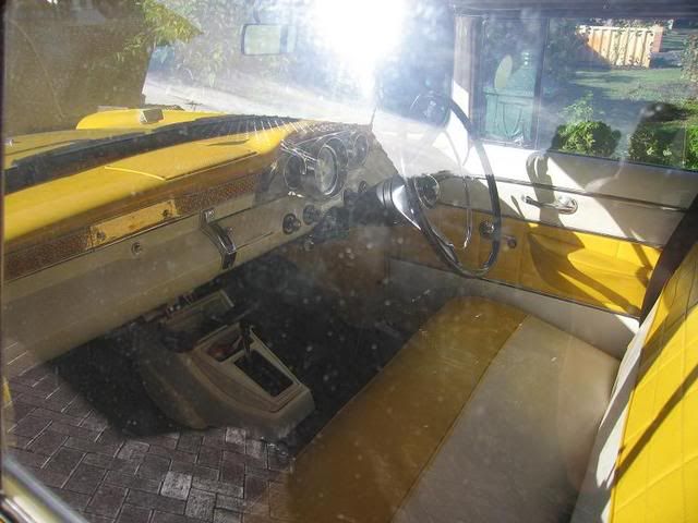

has anybody on here got a tbar auto with a bench seat would like to see how much room there is and what shifter to run any pics
(AUST)Mod
Posts: 2272
Post by (AUST)Mod »
ancient shots of mine....
Plenty of room I find.

Nice neat little console there austmod, is it out of a trana or gemmy ?
