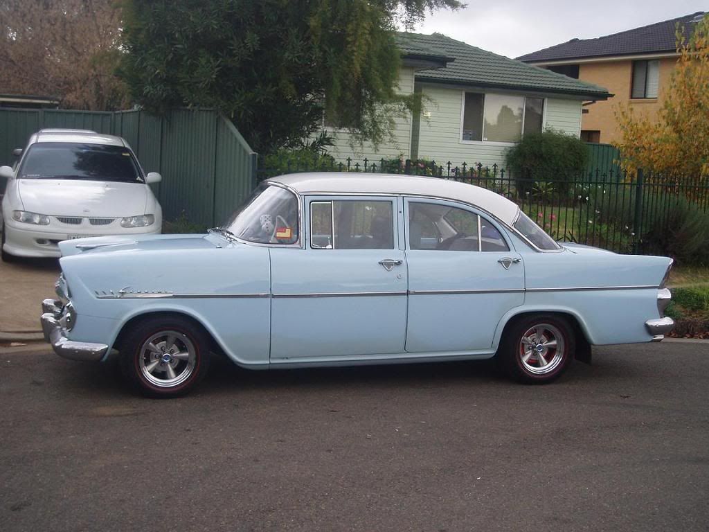

I had 13's on mine.....also have all HR running gear....they do look great for period racer look.

I had 13x7's on mine early days, front 205's fit fine, rear 225's hit the guard when I went over a speed hump, probably would have fit if the off set was set up properly or LC/LJ torana diff was used. And it was before my car was lowered as much as it is now.

yeah 225 scub to hard 205s are a great choise are you lowerd dee,, dragway is a company that can be delt with direct i believe, as my mate who is a boss man if 7 tyre shops and real handy ,,told me, a new one is about 400 to 425 from memory but im not sure how 14s will fit i only like 13s and they still rub alittle some times,,,if you talk direct drag way will tell you what will fit,, but ithink my ofset is not what they recomend im out an inch or so from there specs,, can pm you my mates number but he a brissy fella so your best to check out dragway in your state,if not i can ask him to ask dragway
