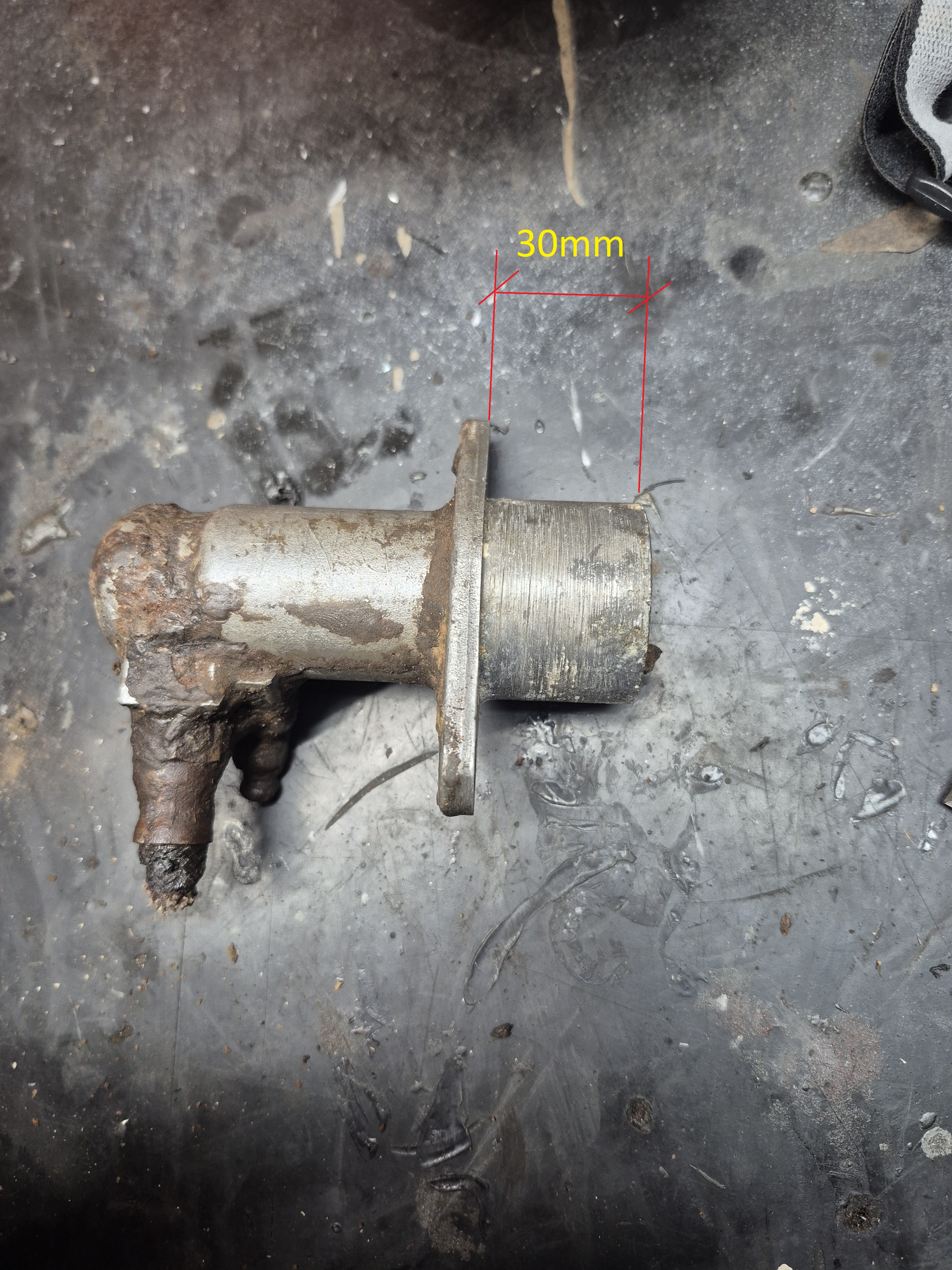

The car came without a slave cylinder, I did have an old one from a donor car, and beleive it is the correct one, as the bolt holes line up.
Picture of the slave cylinder

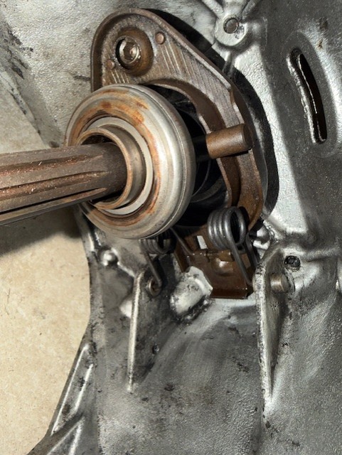

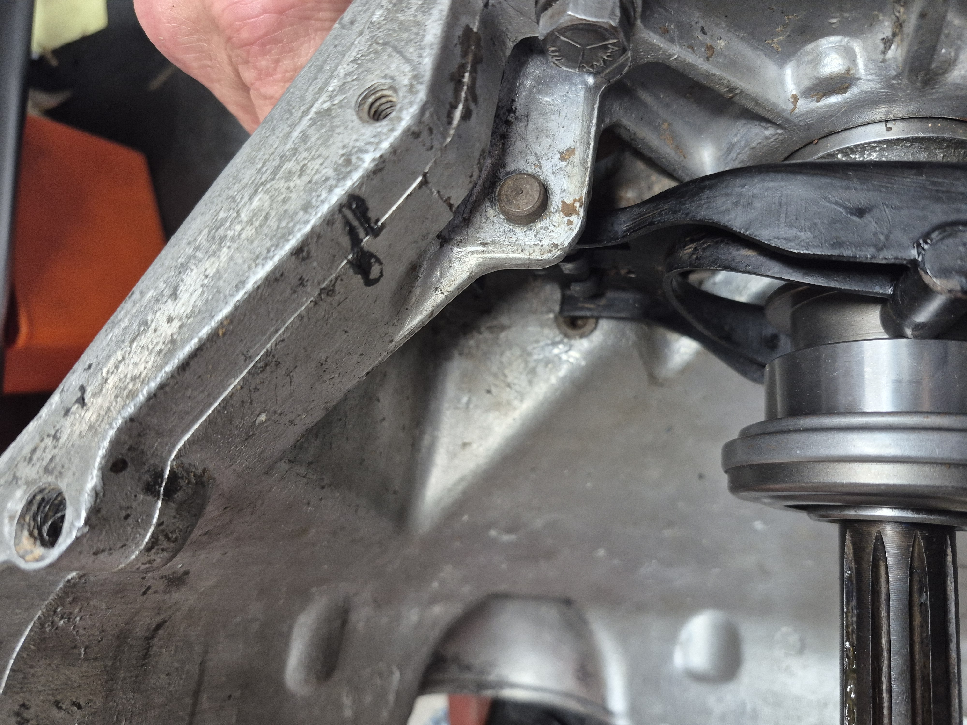

With the slave cylinder inserted, below is the home position of the lever
start pos.jpg (3.36 MiB) Viewed 1389 times

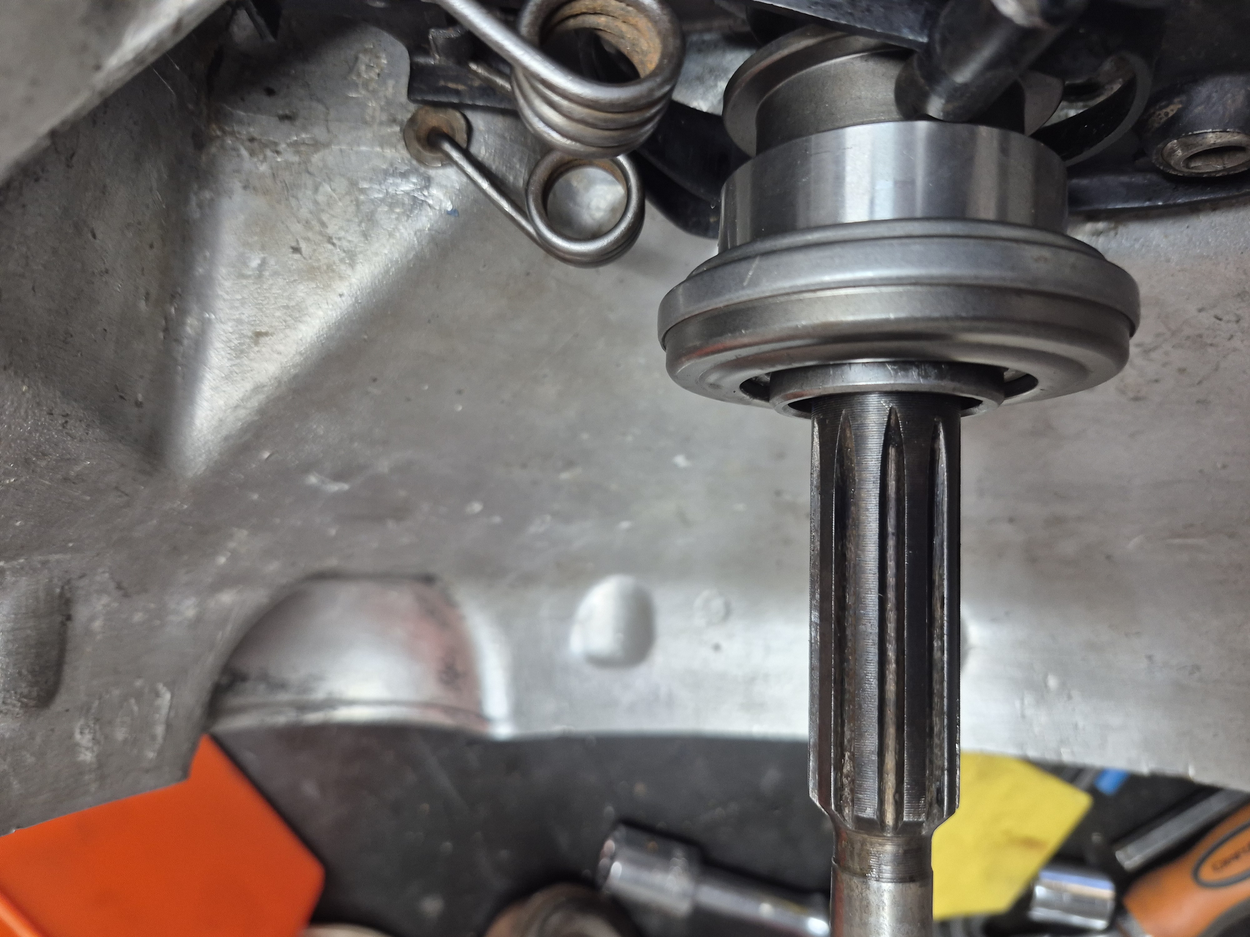

If I push the lever fowrard, it moves around 3mm, before the spring pops out, as it cannot move beyond the centre of the holes. Below shows the position the spring pops out
Full forward.jpg (3.89 MiB) Viewed 1389 times

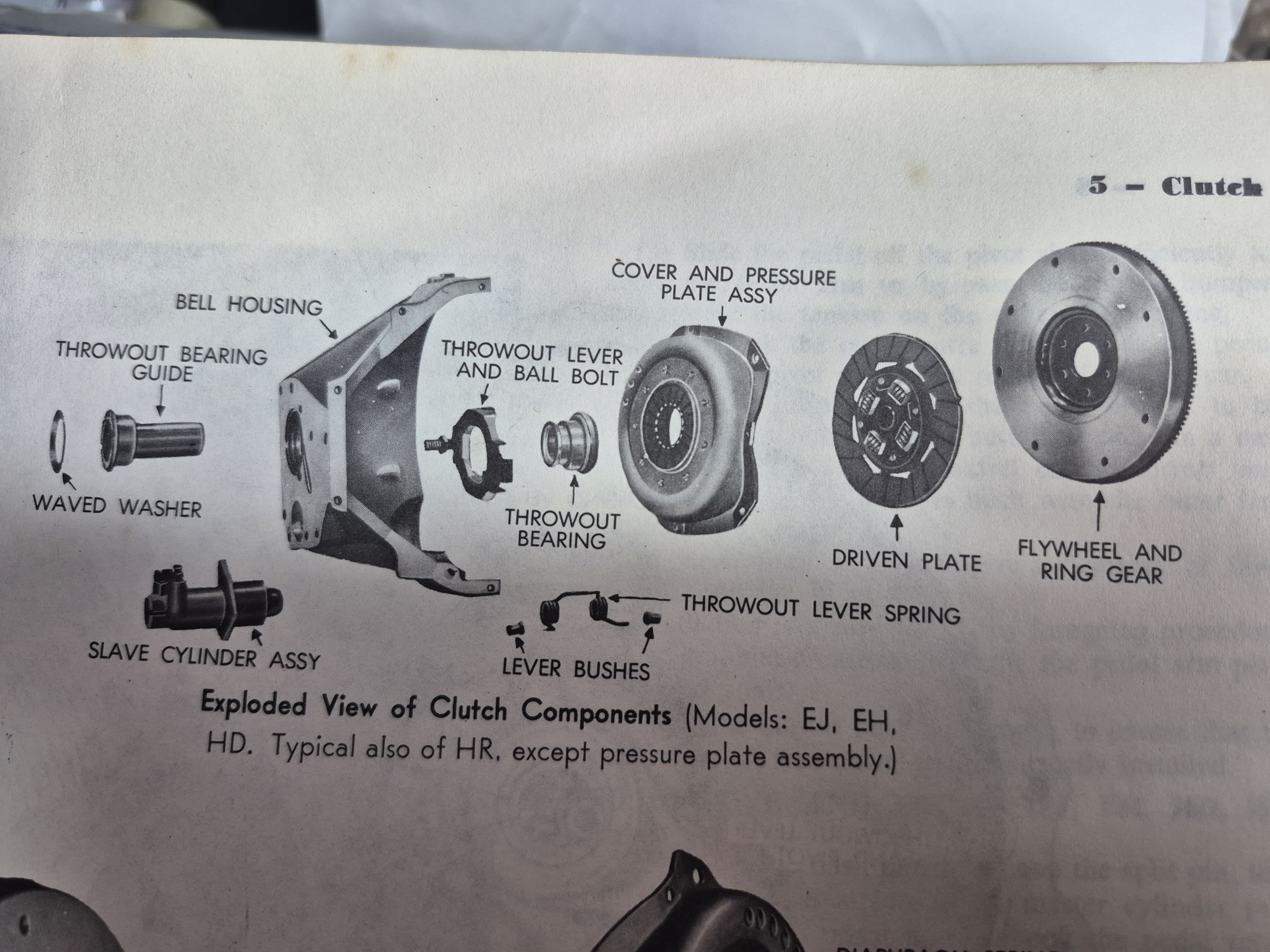

This slight movement from home position to max travel before the spring pops out only moves the throwout bearing around 2mm forward, which cannot be enough to engage the clutch. I am not sure what I am doing wrong, or if I have a wrong part installed from the previous owner. Looking at the manual, everything seems to be correct and present, as per the below breakdown from the manual
I am pretty sure this is the correct way the spring goes in, I have tried mirroring it, so the spring coils sit on the side of the bellw housing, but it does not seem to help. I feel I am either missing something very obvious, or have a wrong part installed.

Having said this, I believe you may have an incorrect thrust bearing assembly fitted, probably the earlier type or maybe all synchro type. Comparing your photo to the diagram, the EJ one appears significantly longer. It is a stab in the dark but I hope it helps.

Even if it was a bit shorter, the issue seems to be in the travel the lever actually has, of only a few mm.
To me the only thing that really makes sense is either the slave cylinder is wrong, and is pushing the lever too far out (the lever sits on the housing of the slave cylinder) or somehow I have the spring setup wrong.
I am doubtful its the spring though, as it has a small clip it slides into from the front, so not too many options on orientation.
The slave cylinders I see online also look the same as the old one off the car, so unless there is some spacer I am missing, I am really at wits end.

This may be a stupid question, but is the clutch fork 180 degrees out ? From what I can see in the photos the lip of it goes over the bit where the spring locates in the bellhousing which cant be right - can it possibly go in the other way ? What does the clutch fork pivot on - could it be too far forward causing the interference issue ?

I do not think it can be 180 deg out, as there is a ball that the other side pivots on, that is pressed into the fork, so it can only rerally go on one way. I could somehow be overthinking the whole thing, and it will just work if I put it together, but something tells me it is wrong with only having a few mm of travel before making the spring pop out (unless there is actually something wrong with the spring)......

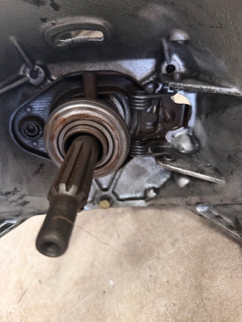

Ok Heres a set up from an Eeee Haitch.
Looks like its right, check your throw out bearing is correct and your ball is adjusted correctly, thats all i can offer.

Thanks for the reply and pics Greg, so I assume once you put your slave cylinder in, it is also pushes the lever forward so it is sitting around about where mine is in my pic, almost inline with the back of the bush on the housing?
Can you also confirm your slave cylinder is ~30mm in length on the bit that goes into the housing.

It’s funny cause I was talking to a mate today and I remembered he had an EH that always had exploding gearboxes. He has a full synchro box now. He sent me the photos he had on record, Not my car so I can’t confirm the slave sorry.

Sorry, I’m wrong about the thrust bearing. Something else but same as Greg’s mates EH, the thrust surface seems short of the driven plate splines. Maybe just the photo angle or maybe needs a lot of adjustment. Just my thoughts EJ63.

The main issue i have is the position from where the lever sits on the clutch slave cylinder and where the spring pops out is about 3mm. I can't imagine that is enough travel to engage the clutch, but getting the car not running and complete I am not sure if its normal or not.
