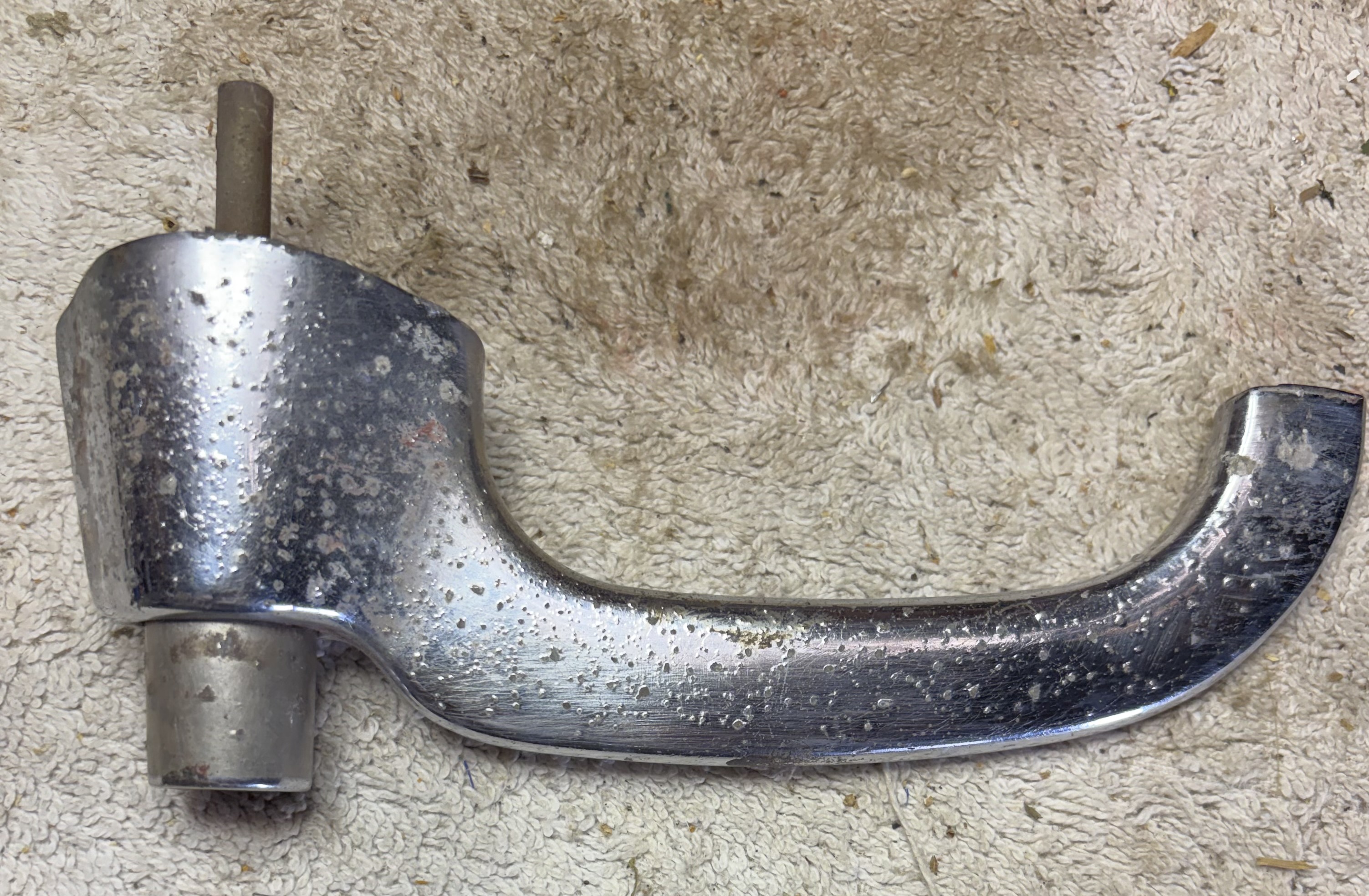

Chasing a driver’s outer door handle for my ute. Chrome quality is not important, but needs to work well! Getting tired of ‘repairing’ it (the button keeps getting stuck in)

I think I have a spare second hand door handle I just need to find it! I will look tomorrow and advise. With your speedo it might just need lubricating with a couple drops of fine oil, as mine did. It was so tight to turn it broke the cable inner.
Posts: 14318
Re: Door handle & speedo
I will have a handle over here if you cant turn one up locally - as for your speedo mate best thing to do is just get it serviced, about $150 over here so probably $80 over there ....... :lol:

In the Shed wrote: Sun Feb 15, 2026 10:31 pm Hi Joe
Hi Stephen, good to hear from you. Thanks for the handle, let me know :)
Yeah you;re right I should pull the speedo out for a proper look first. I am being supremely lazy here.
Hear from you tomorrow
Joe

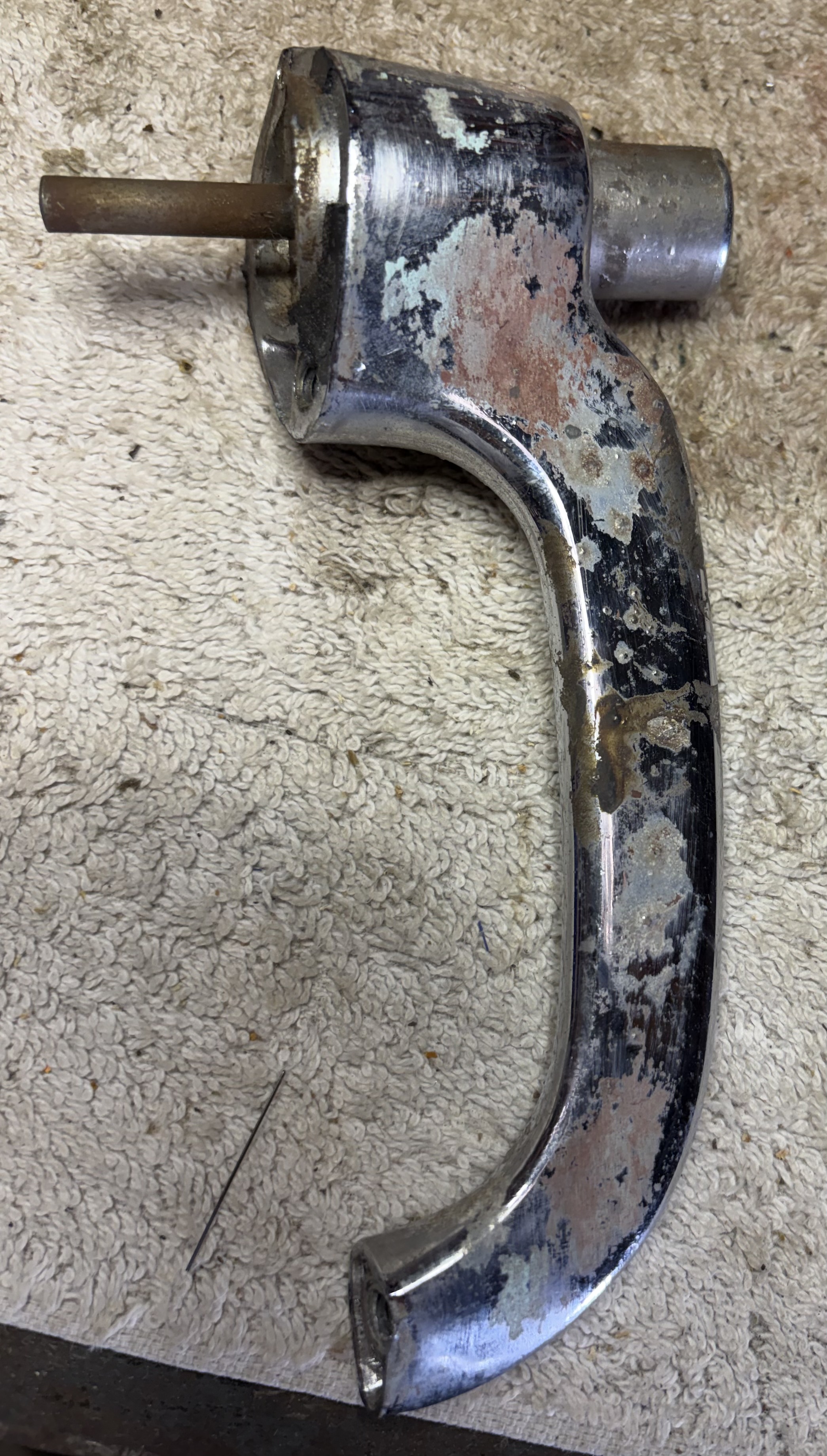

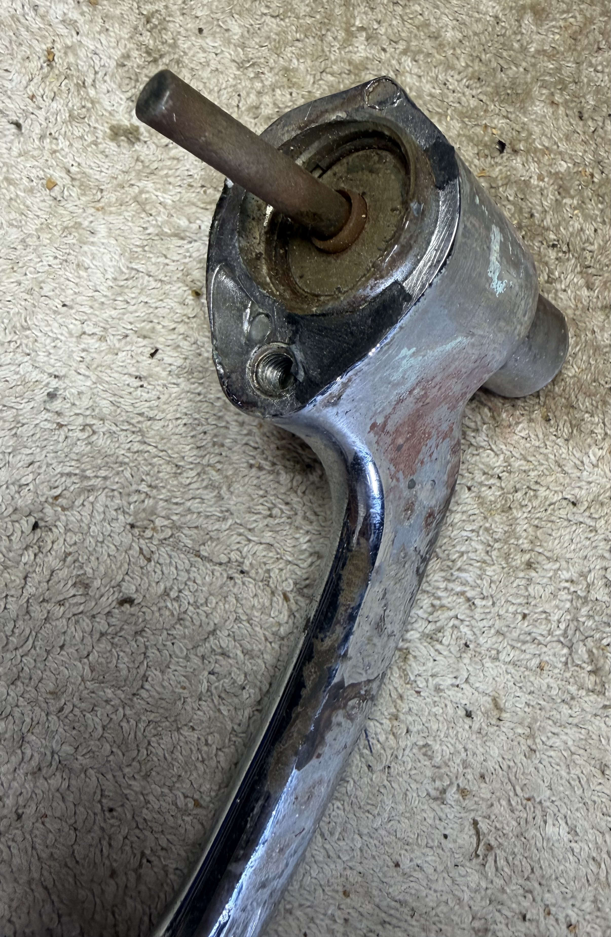

Found it 😊. Quality is not good but it works and it’s free. Zap me your address if it is of use.
thebrotherj
Posts: 695
Post by thebrotherj »
In the Shed wrote: Mon Feb 16, 2026 10:20 am Joe
ahh nice, this will match the rest of the car perfectly *chef's kiss*
I've sent you a PM - Cheers!
Posts: 2294
Thanks Joe all received. Package heading your way see my PM.
